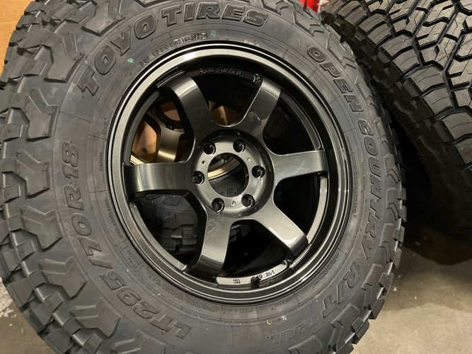

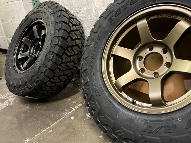

We offer them in 18x9" +20mm offset right now, but we'll see what we can come up with in a high offset. The spokes would have to be very, very flat and pushed out all the way to the edge of the lip though. I'm not sure if a high offset BFD would go over as well as the Five Stars or Countersteer Type X, but we can work on some renderings.
Here are a few examples of the 18x9" +20mm 6x139.7 (95mm hub centric) FN Wheels BFD flow formed:

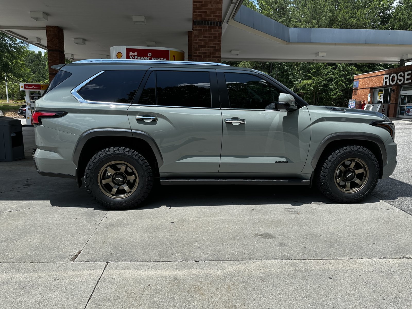

I installed JAOS Tribe wheels on my LC about two weeks ago. They are of excellent craftsmanship and exact spec. I also put on 275/70/18 tires and there's zero poke. And the inside of the tires are exactly at the same spot relative to the body as the Geolander 245s.
They're basically made for the LC so you can mount larger tires than the factory ones.
Just googled those and they look awesome. Please post pics.
There is still work to be done with things like rock sliders and fender flares. I compromised on the tires for highway and trails. Some Toyo AT3s may look way better with these wheels.
