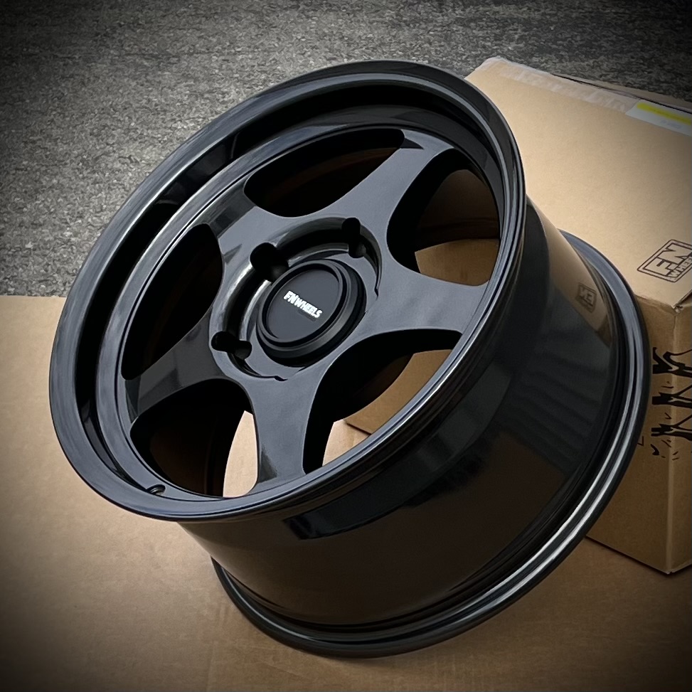

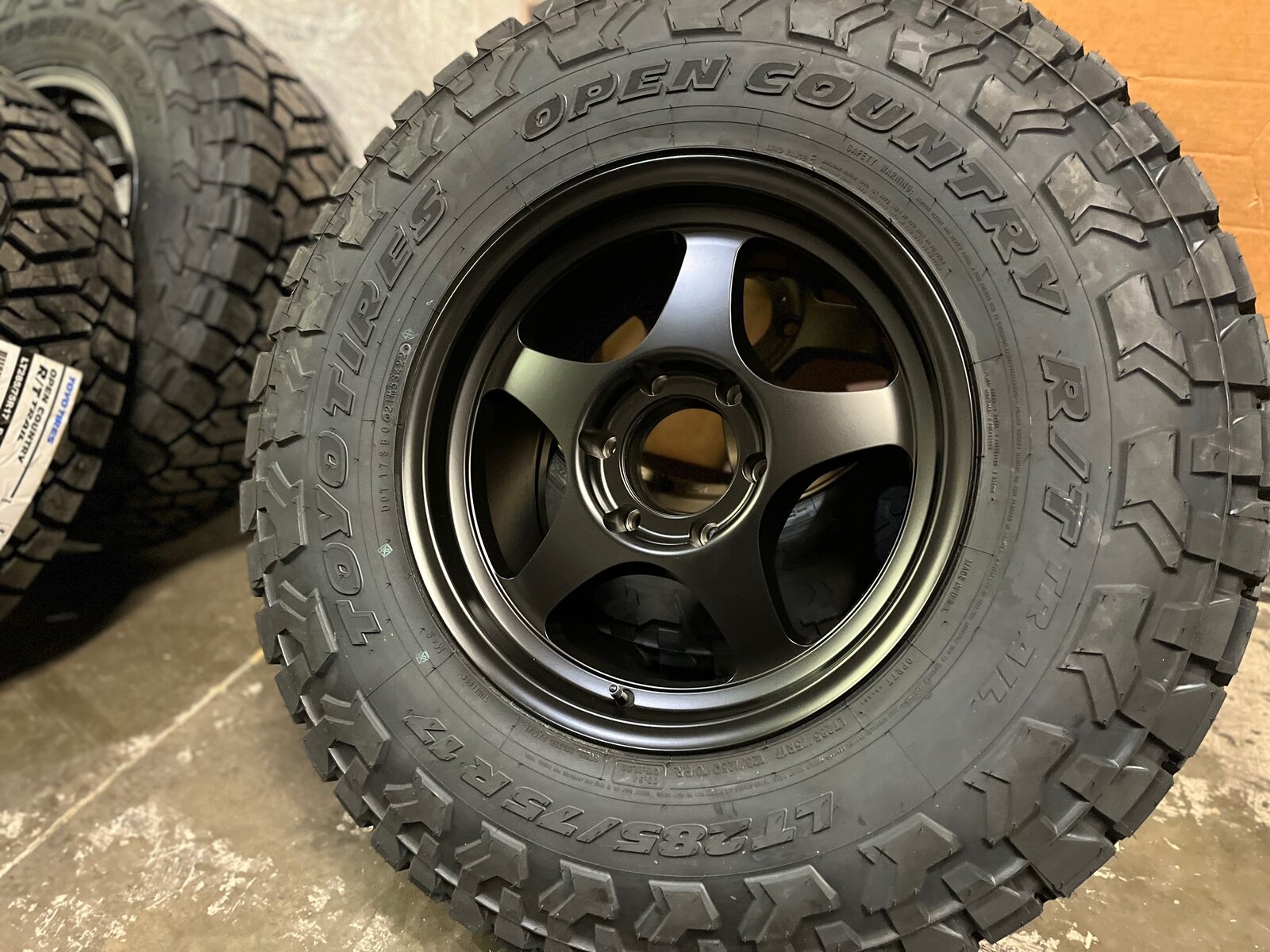

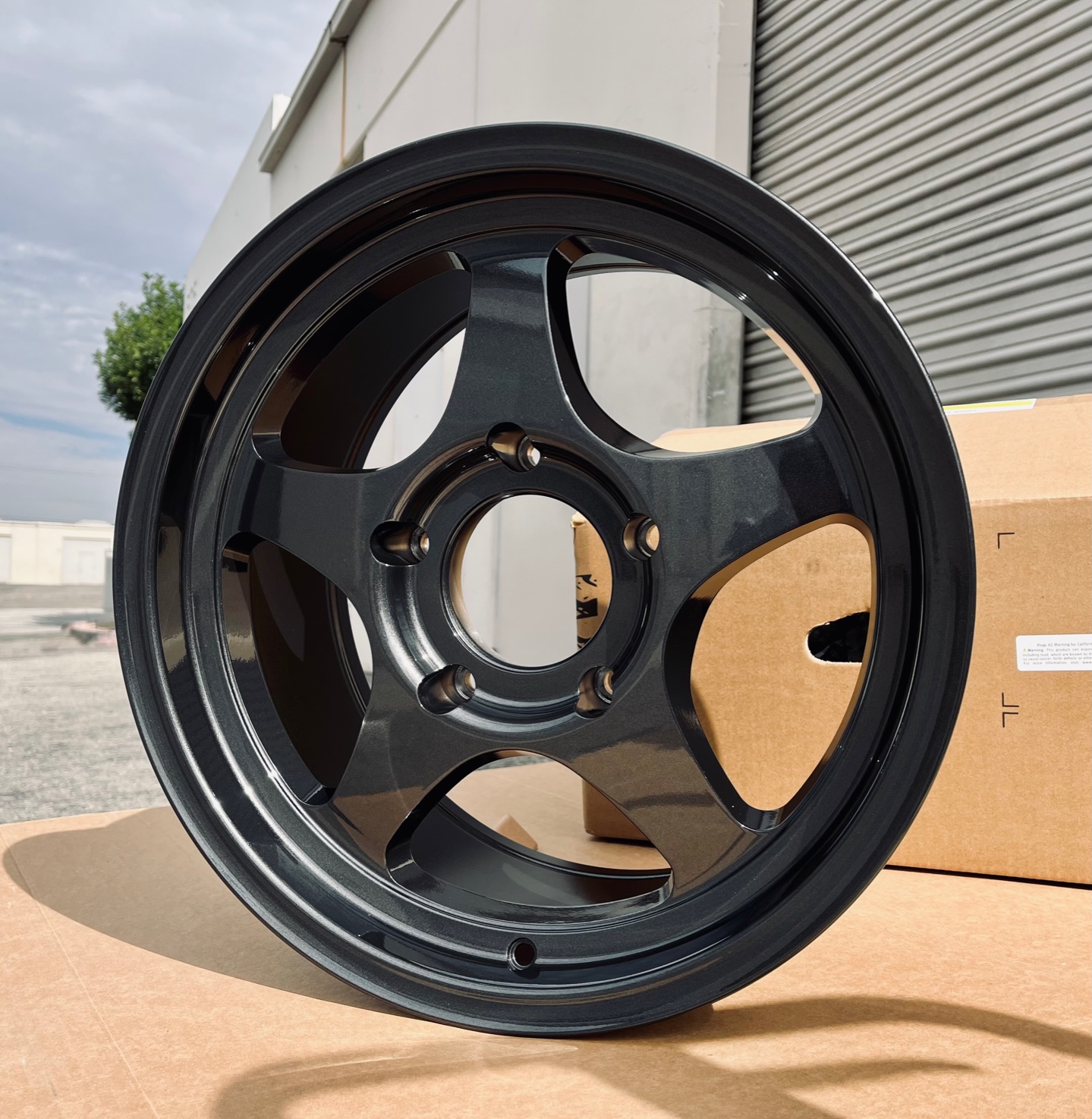

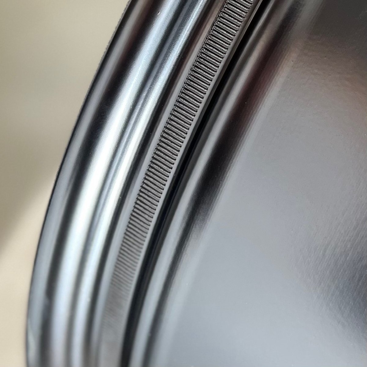

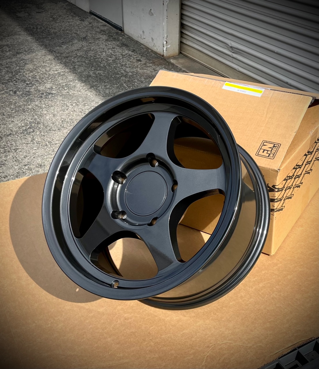

FN Wheels Five Star – Flow Formed (PROPOSED SPECS FOR TOYOTA LANDCRUISER 250)
Diameter:
17″
Width: 8.5″
Offset: +40mm
Backspacing: 6.32″
Bolt Pattern (PCD): 6×139.7mm
Center Bore: 95.2mm hub centric
Load Rating: 2,500lbs w/ up to a 37″ tire diameter (SAE J2530 test standard)
Wheel Weight: 22.9lbs (approximate)
Additional notes: Compatible with extended thread (ET) lug nuts for maximum stud engagement. High strength/high clearance flow formed barrel design to provide maximum brake caliper clearance. Reinforced lips/flanges for strength and durability on and off-road. Raised bead humps with knurled bead seats for improved bead retention at low tire pressures. Knurled bead seats also help to prevent bead slippage that sometimes occurs from the high torque output of hybrid motors.

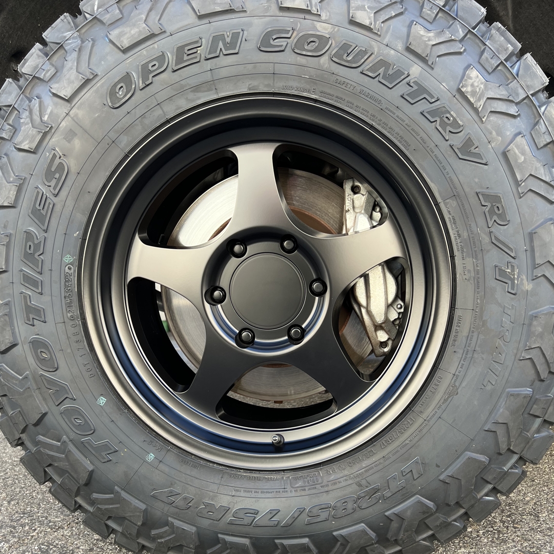

Caliper clearance for 17" wheels is pretty tight. Early on Method said theirs only cleared the calipers by a few mm and that made some of us pretty reluctant to go with anything smaller than an 18" wheel. It seemed like maybe that was the reason Toyota was going with 18" as the smallest size on this platform. Just throwing that out there -- some folks may be reluctant to get a 17" wheel. (Otherwise I'd already have a set of Method wheels!)
