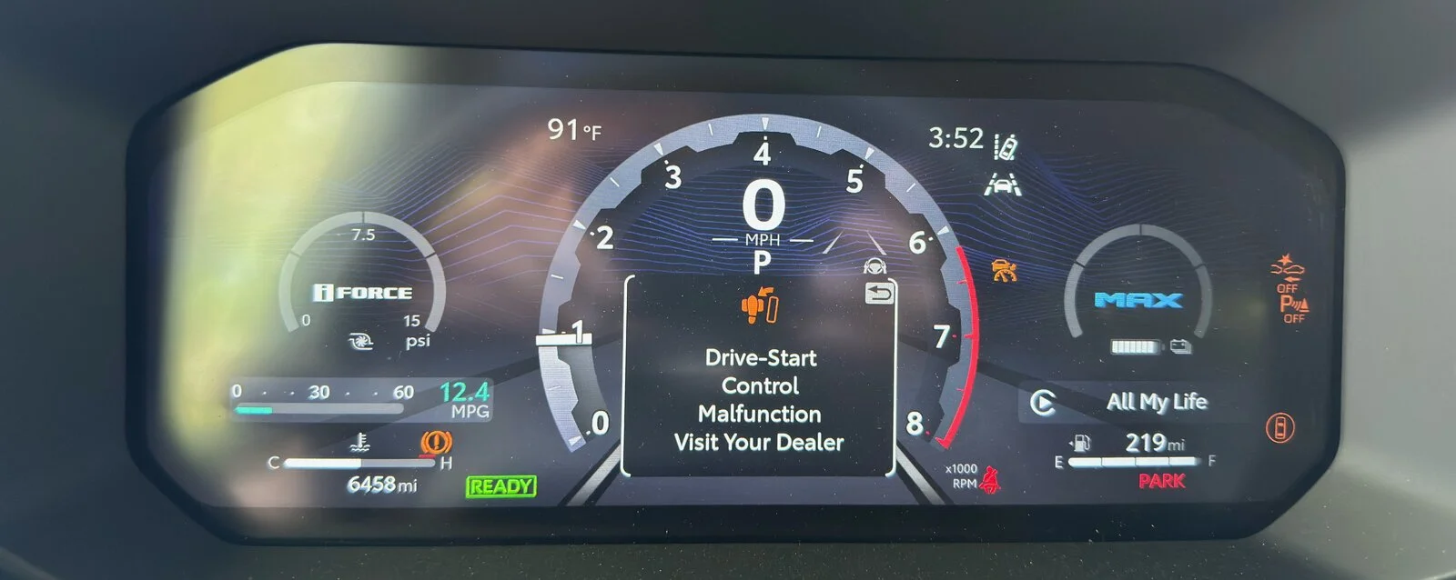

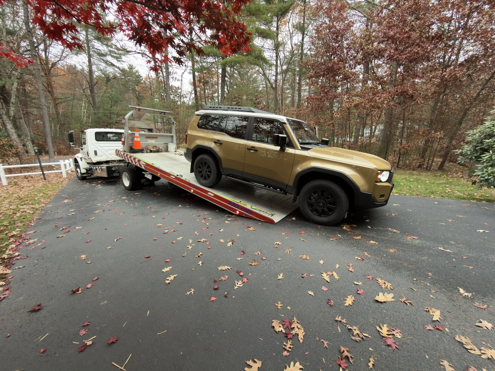

🪦 RIP Transmission at only 6500mi (2024 LCLC)

To save you from finding my original post, Here are my updates since the transmission failed:
08/27/2025 UPDATE -
I got some fairly good news from the Service Advisor. Toyota has ok'd the warranty repair and have specified that the Dealer only use new parts, not re-manufactured. They'll be replacing the transmission, the hybrid module, and the torque converter (not another module as I thought I heard earlier). The hybrid module and the torque converter have already arrived at the dealership. The transmission will arrive by September 15th. Thank you to Blue Sky for suggesting getting a Toyota Extra Care Platinum Warranty comp'ed. I haven't done that yet, but I'll be talking to the Toyota Customer Experience Center saying I expect one simply as compensation for being out of my car for a month (or possible more). Plus, the now ever present worry that it could happen again.
@MIkel.C007 asked if Toyota tried to blame vehicle modification (wheels/tires) for the failures. They did not. However, the only modification I made was the addition of Method wheels 318 Machined / Clear coat, 18x8.5 with a 40mm offset. I just transferred my stock tires over to them because I didn't like the look of the satin black rims that came on it.
09/15/2025 UPDATE - When I last posted, the Service Advisor had been given a delivery date of mid-September for the transmission (he had already received the torque converter and hybrid control module). In todays conversation, I found out that the delivery date is now mid-October for the transmission. I'm working now with Toyota Customer Experience as my LC will be well over the thirty working days stipulation needed to qualify for a replacement or buyback. I love the car, but I don't feel like I can trust it now. Something tells me that the dealers are going to have a few used low-mileage LC's for sale over the next year or so. I hope a redesigned transmission is in the works. I'd love to buy another one if they get this fixed.
09/22/2025 UPDATE - Two days after filing a claim with the Toyota Customer Experience Center early last week, the dealership received the transmission. They worked on the LC for three days (including the weekend) and have returned it back to me. The root cause for the failure listed that a P281671 Pressure Control Solenoid "H" actuator stuck, and a P08BA71 Pressure Control Solenoid "L" actuator stuck. The solution was to replace the Torque Converter Assy., replace the Transmission Assy., and replace the Hybrid Module Assy. The LC seems to be driving better than when it was new, but I did feel a bit of a jerk on a downshift when I stopped today. Naturally, though, I'm a bit hypersensitive to the slightest bump or noise right now, so the jury is still out. The Customer Experience folks have acknowledged my claim requesting Toyota to repurchase my vehicle which has been forwarded to a local field office who may request to perform a vehicle inspection. The letter also suggests we use the National Center for Dispute Settlement program which is essentially an arbitration board, hoping I'll keep a lawyer out of this. I also believe that filing the claim fast tracked my transmission delivery, but I have no proof of that. I have told the Customer Experience team that I would keep the LC if they gave me a 7 year/100,000 mile Toyota Extra Care Platinum Warranty at no charge.

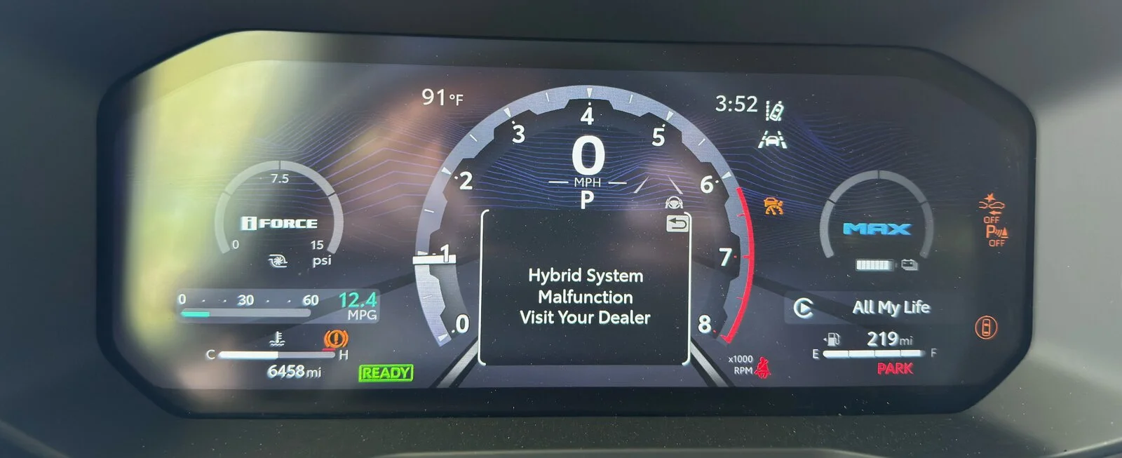

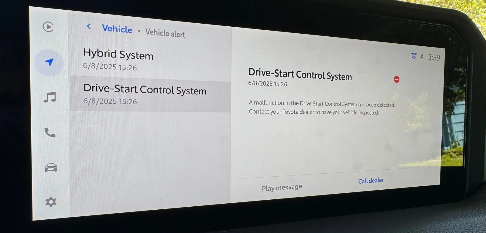

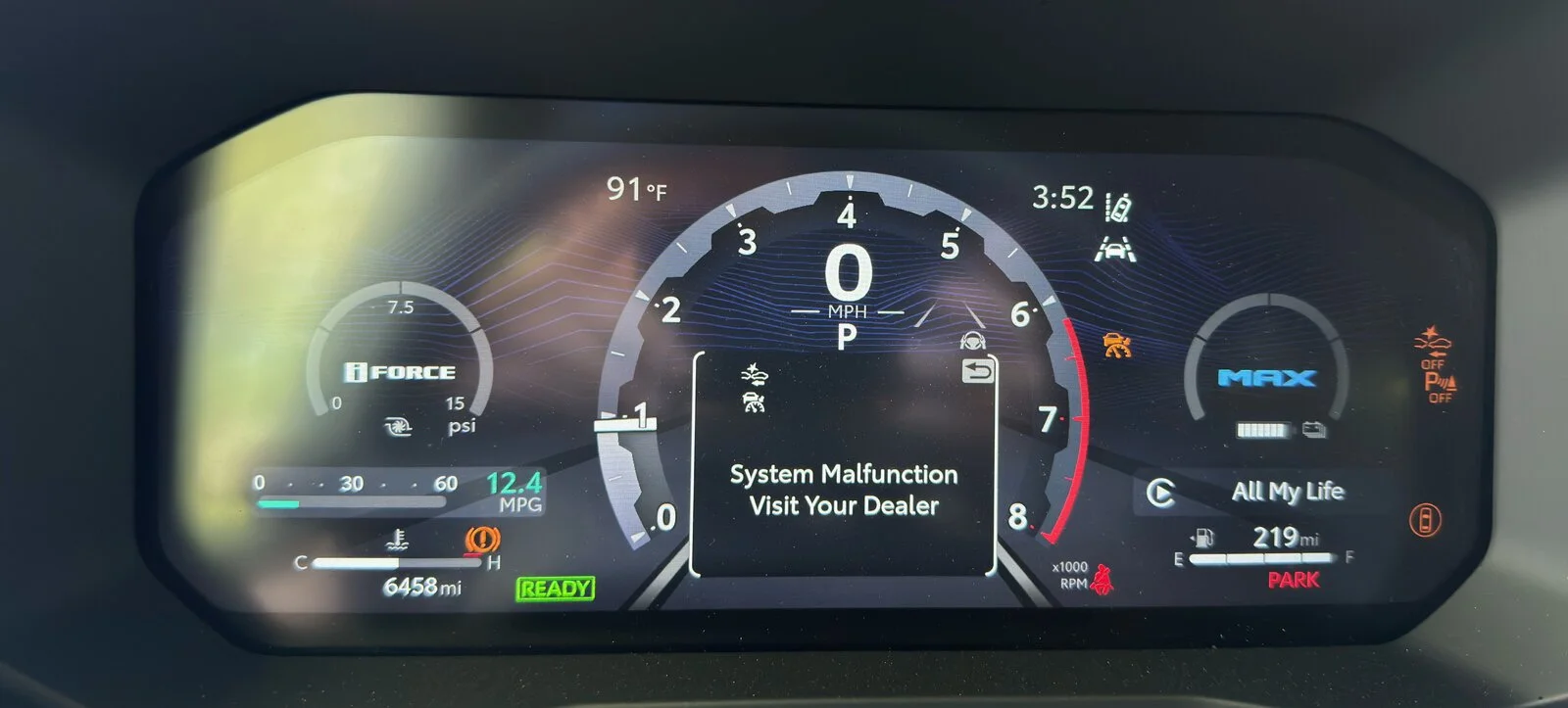

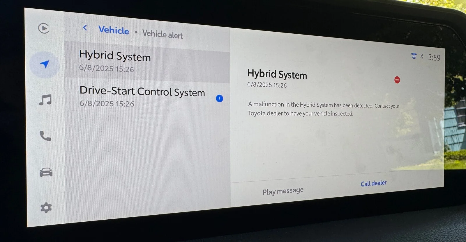

Yesterday I was at a stop light and as I was about to start driving the cruiser had a pretty viscous jolt, almost felt like I got rear-ended. Immediately 3 warnings came on:
  • “System Malfunction”
  • “Hybrid System Malfunction”
  • “Drive/Start Control Malfunction”.
The cruiser continued to operate but only in 1st gear. I didn’t turn it off until I got home in case it wouldn’t turn back on. Once parked, it did turn back on with only the “Hybrid system malfunction” error and it appeared to be shifting gears again with a test lap around the block.
This morning I drove it into the dealership. Only the "hybrid system malfunction" warning was up, and frankly, the cruiser was driving completely normal. I was hopeful!
Alas, the dreaded phone call arrived this afternoon. The transmission needs to be replaced entirely. And of course, they are on back order with no ETA. Could be a couple weeks, could be a couple months! All under warranty as expected. I'm reading up on the local lemon law here, in case this drags out. The dealership will provide a loaner, but I haven't picked that up yet. I'm expecting something lame like a Camry or worse.
