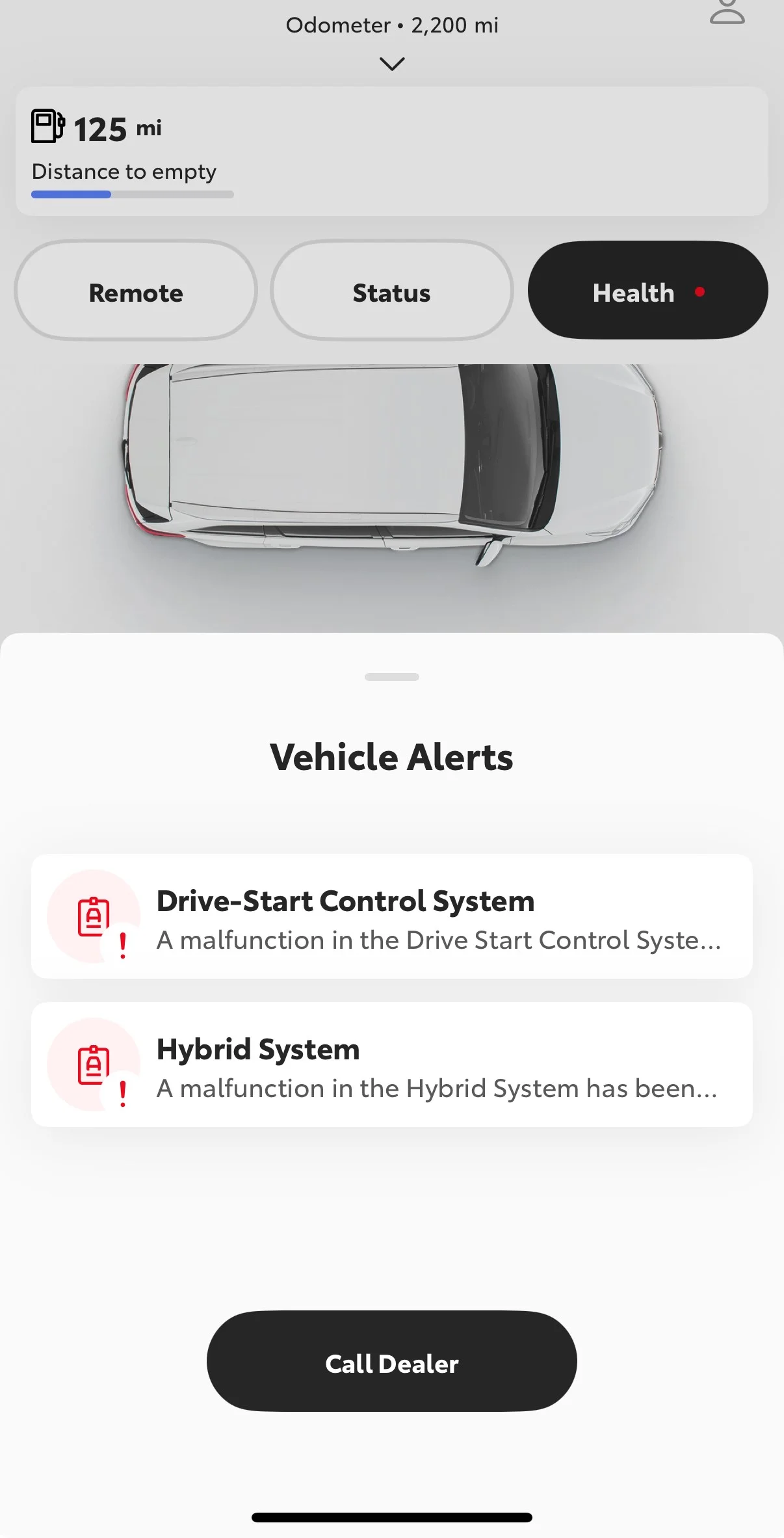

Same thing happened to me last night. Stop at on onramp to get onto the freeway, a huge jolt and noise from the back of the truck (large enough for me to think I was hit. Looked back and no one was even close to me.) I got the Drive/Start Control Malfunction and the Hybrid System Malfunction. The Drive Mode switch light was out, and so was the dash animation showing the different settings. Car was driving ok, but I was in stop-and-go traffic, never getting much over 20mph. After driving a few miles it became stuck in second gear. I tried switching over to manual shifting and changing gears that way, but nothing. So, I pulled off the freeway, shut the truck off, then restarted it. The transmission seemed to be shifting normally again, although I still had the two malfunction alerts flashing. I got back on the freeway and drove it the 18 miles I had left to get home. When I got home and shut if off, I waited about ten minutes and started it again. No alerts, and all of the dash lights and the drive mode switch were working. I took a screen shot of the Toyota App showing the alerts and let the truck sit overnight.
This morning, I started it up and immediately got the Hybrid System Malfunction alert. I took the chance of driving to the dealer near my work, thirty miles away in Glendale, CA. They took very detailed notes matching what I've written here. After the diagnostics, I received a call from the Service Advisor that the transmission had failed and they needed to replace it, along with the hybrid module and some other module (I'm waiting for something in writing. I'll update this when I hear back.) He said that the transmission took out the other modules when it failed. I have so far been told the same thing Trail Whale heard: 2 weeks to 2 months to get the parts and back on the road. I'll update when I have the ETA later today. Its especially disheartening when I've only put 2,200 miles on it. I haven't had it offroad yet, I haven't towed, I've been driving like an old man in Eco mode because I wanted to make sure I was carefully breaking in the engine.
