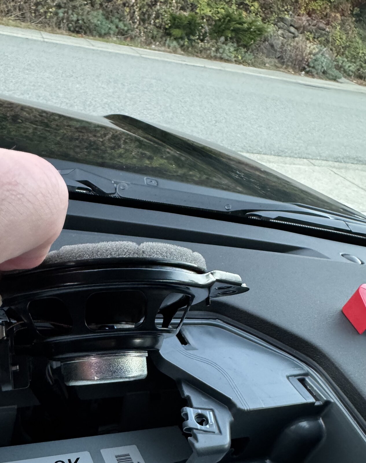

Does anybody have a picture of the JBL premium front doors speakers, the a pillar tweeter and L/R dash speaker . I want to see what they look like

Yes, Center 3.5. No tweeter. I believe L/R is the same speaker.

So to confirm I was able to install 4" Ref 4032cfx int the front L/R Dash and 3.5 inch in the center because the 4" didn't fit there. I heard some people were not able to fit it in the L/R with 4 inch. It actually fits flush for me.

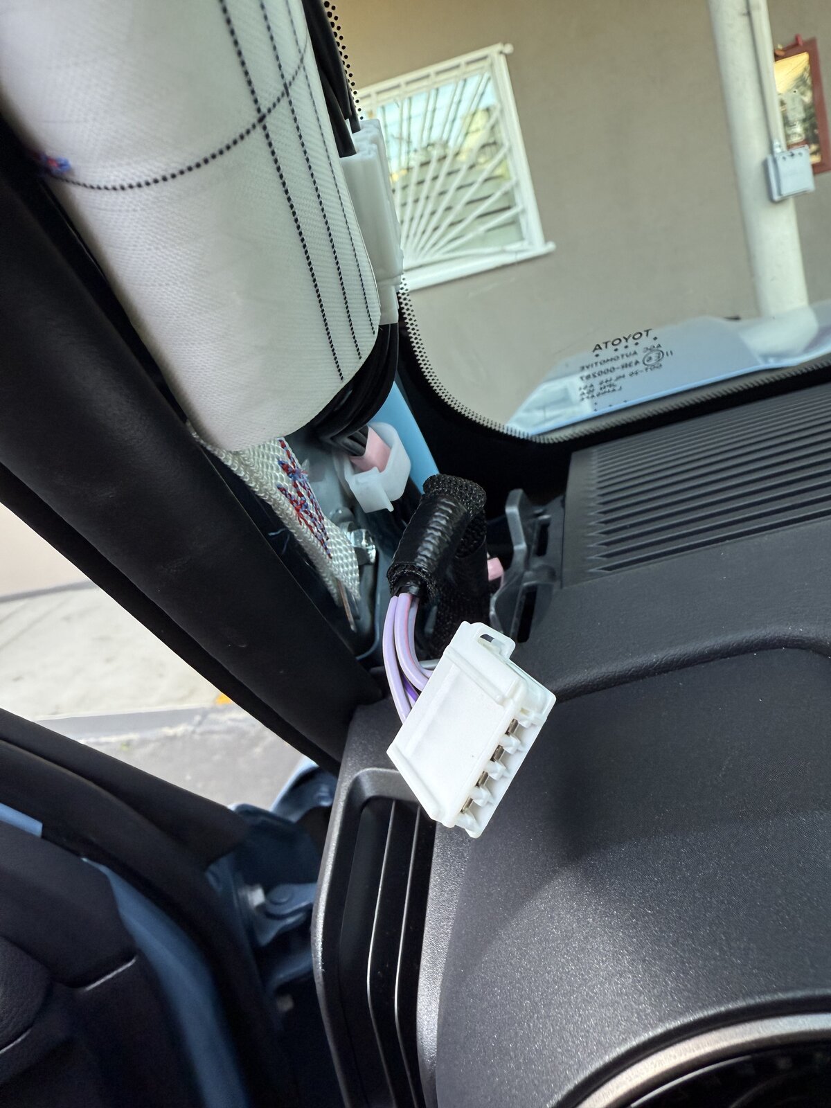

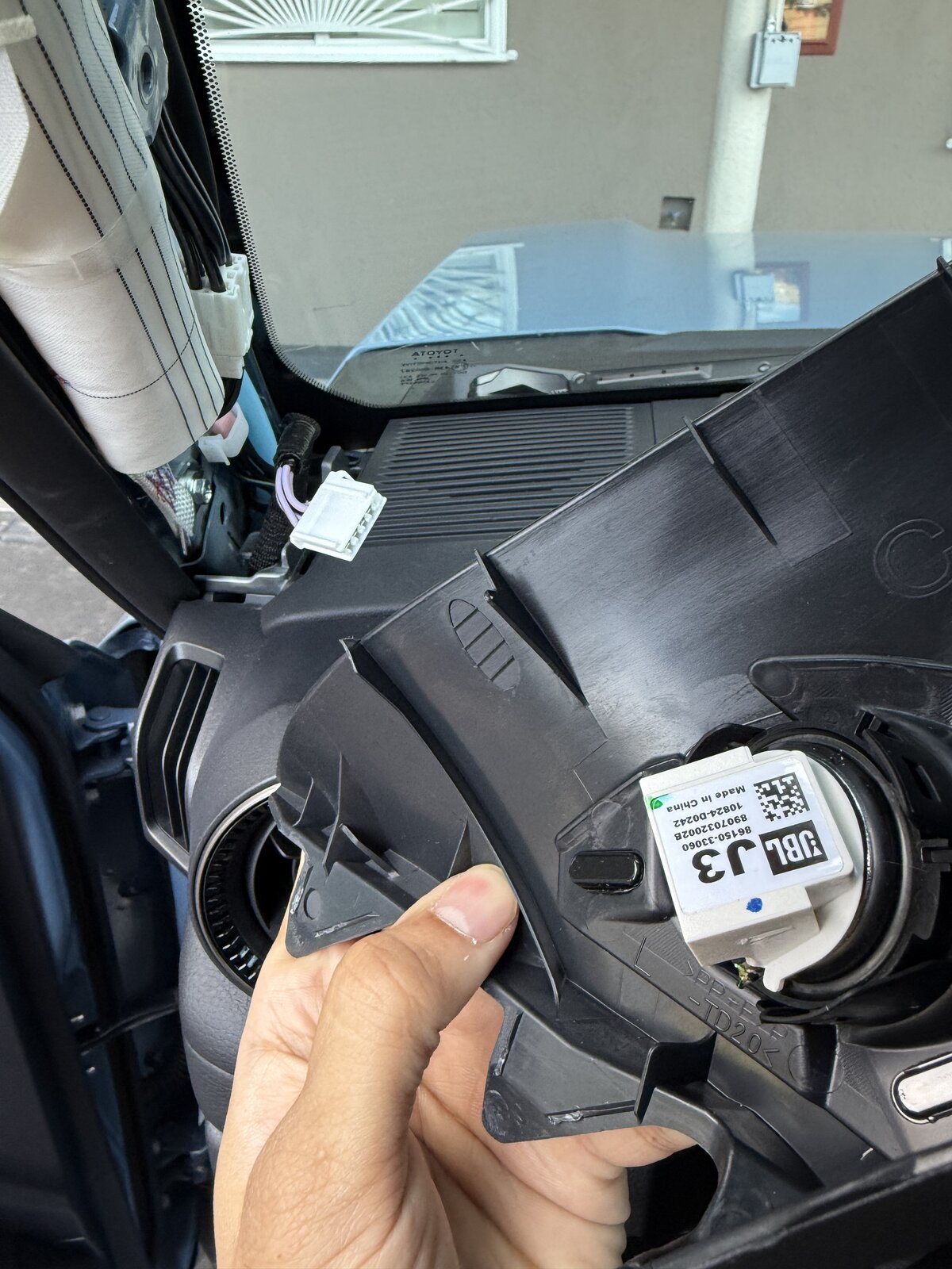

Does anyone know adapter for this to add after market tweeters? It's the tweeter for the front dash.
Its strange there are what looks like 4 wires running to the tweeter. I suspect they are passing the full range signal to the tweeter which has a crossover, and splitting the signal between the tweeter and the dash midrange
Found out its does have an adapter harness on Amazon Amazon.com. Just make sure if anybody is changing tweeters to install a crossover after the harness since full range signals is coming out. I did a little investigating played music on that corner only and found that the door speaker didn't work when tweeter is disconnected but the dash corner speaker did work. So I am sure it's crossed over with the door speaker not the dash.
Crossover soldered on and sound deadened
New infinity tweeters.
