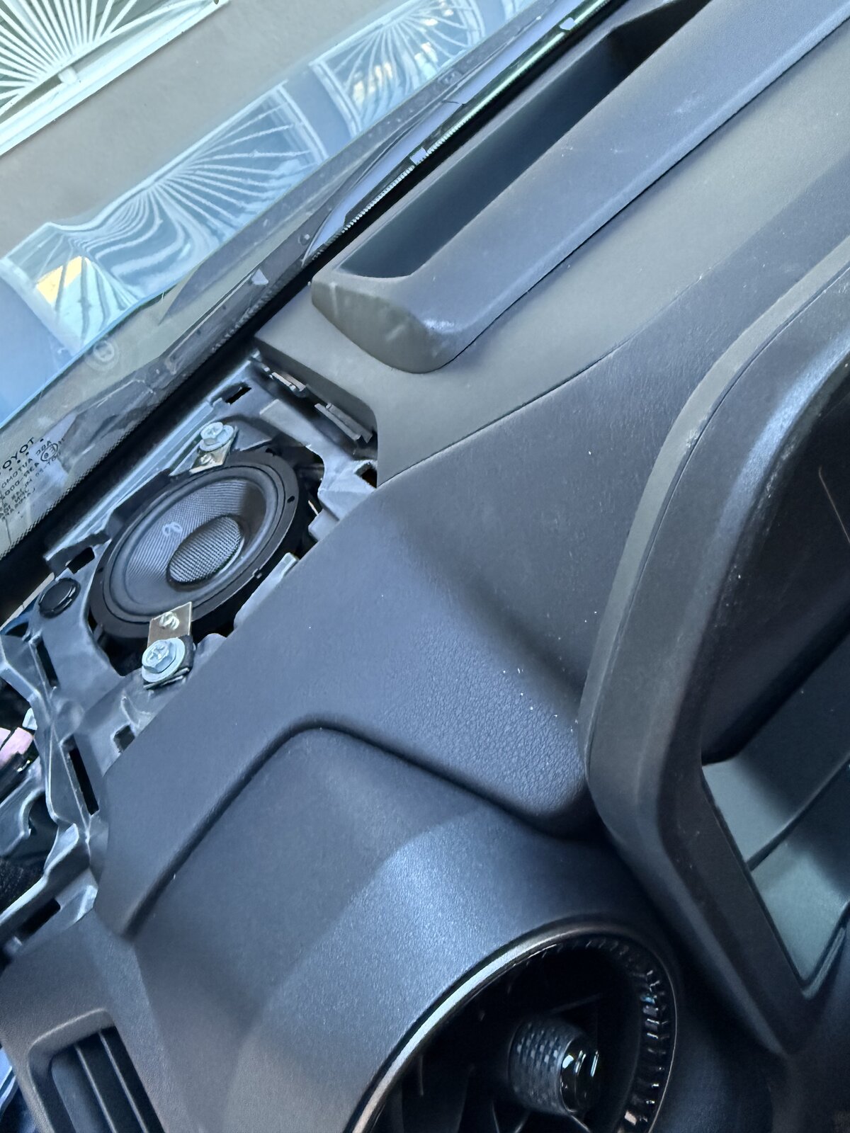

Accessing the dash speaker is straightforward, just pop off the covers. Pry (with a trim removal tool) from the front for the left and right sides, and from the rear for the center. Wire in your harness to your speaker of choice and they drop right in.

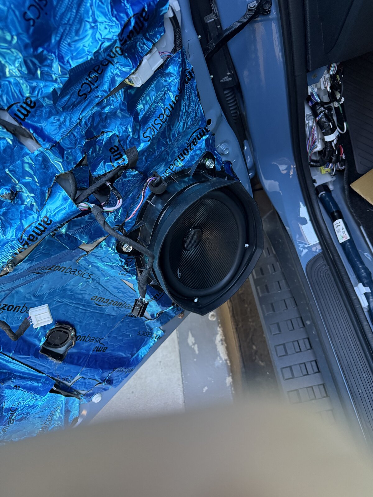

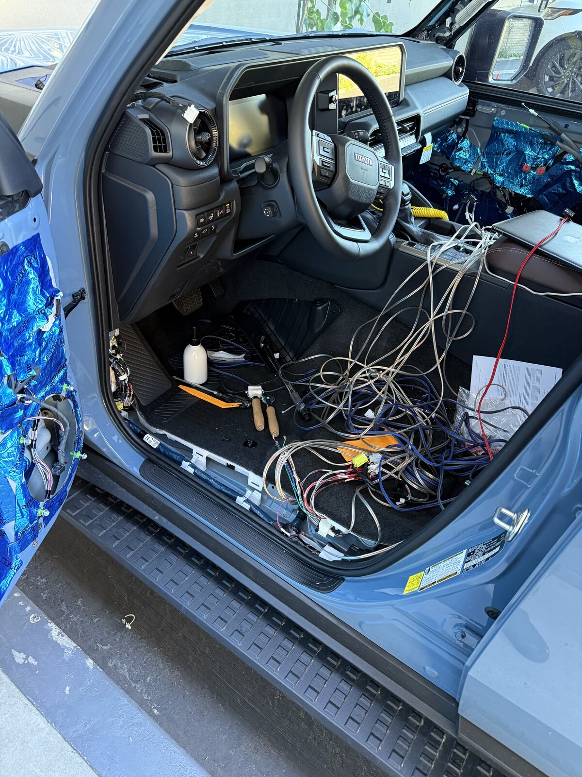

To access the Front door speakers, there are three screws to be removed (one behind the door handle, one in the armrest cup) behind trim panels, and use a trim removal tool and pry off the door card from the bottom up. Disconnect the electrical connectors. I did not undo the door latch cables, I just let it hang off them. Install your speaker adaptors (you will have to drill one hole because they don't line up perfectly). Make sure to install them with the harness hole facing up (not upside down like I did), because the Metra harness is not long enough. Your new speakers will then screw into the adaptors. Take note of the limited depth with the window rolled down. Shallow mount speakers are your friend. Mine are not and almost didn't clear. Didn't get a pic of the Hertz installed, but you can see the factory unit. Reverse everything to reinstall the door card.
Rear Doors are the same as the front. Pop the covers off behind the handle and door pull, remove screws, and use a trim tool to remove the door card. There is a lot more room to mount the speaker in the door, as the window sits farther in when rolled down.

Nice! Did the dash speaker brackets fit the existing mounting holes? I recall @chancellor had to macgyver their’s a little bit.
I’m not familiar with Hertz, aside from their rental cars 🤪. How would you describe the upgrade quality vs something like the infinitys?
I’m still on the fence about doing a dash-only upgrade. I’m satisfied with the low end in my non-premium LC^2, but would like to improve my upper mids and highs.
Yes, the dash speakers reached the factory mounting tabs. It doesn't look like it will, but once I got the screws to bite, they lined up fine. I've never had Infiniti speakers, but have heard nothing but good things about them. The Hertz speakers lean a little toward the bright side, which works for my not so great hearing. The dash speakers were definitely the most notable sound upgrade.

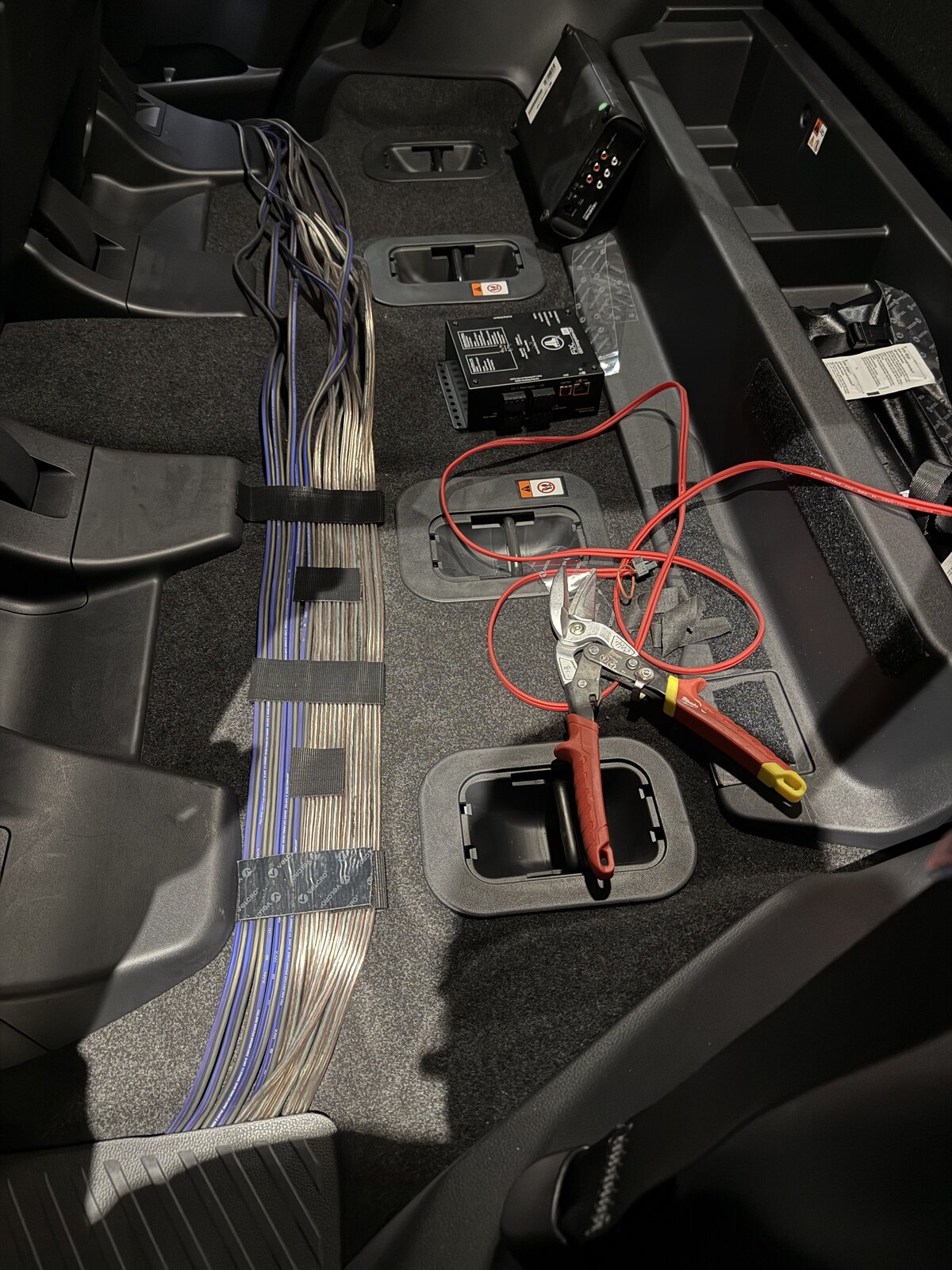

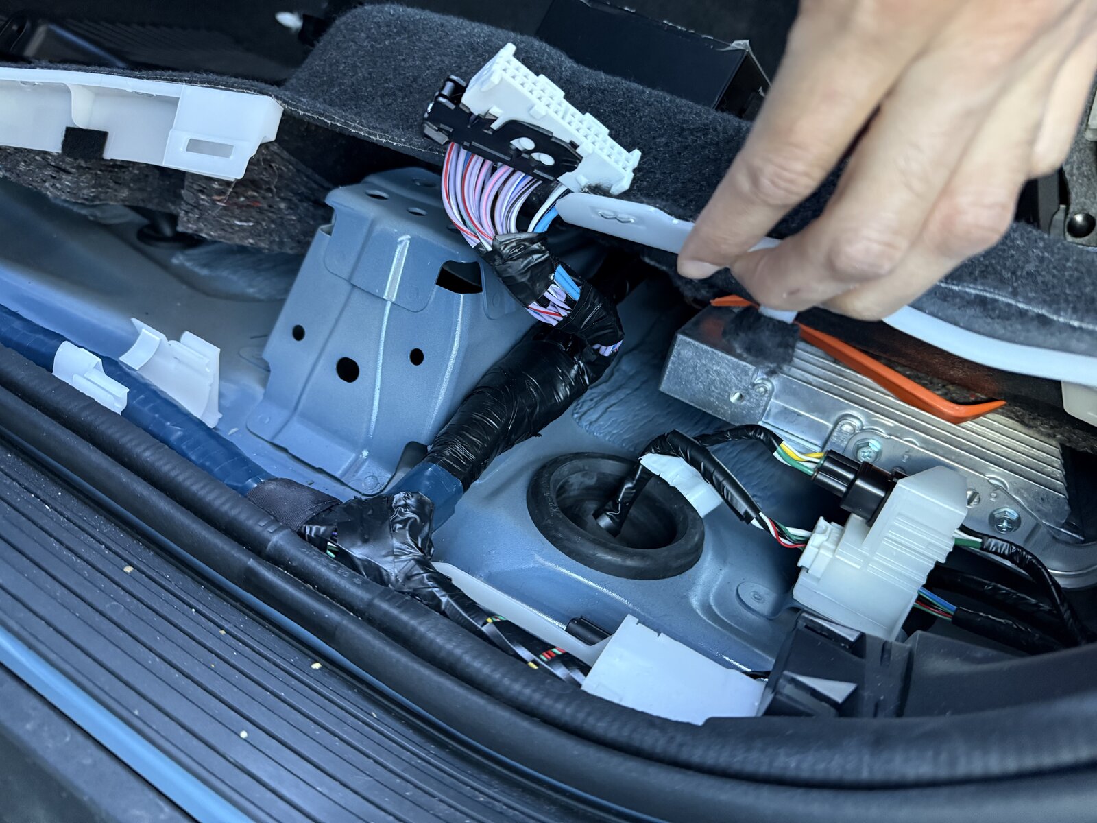

To access the factory amps and get a clean audio signal for the new amp, I had to remove the seat. The factory amp needs to stay in place to retain fade and balance functionality. Due to limited space under the seats, my amplifier options are restricted. Behind the rear seat, there's only a small amount of space, but I found enough room under the middle rear seat for a JL Audio FIX 86.
In the rear trunk, I’ll be replacing the factory subwoofer with a JL Audio 8-inch subwoofer. Once everything is complete, I’ll provide a more detailed write-up. For now, here are some pictures of the work in progress!

if your looking for a way to mount your amps, check out this solution. It gives u a space to mount stuff in front of hybrid battery.
Thanks for that! Now I can cut out a little slot in that plastic piece behind the rear seat to slide the amp in. Or maybe the wheel well has space. I wonder if anyone on here accessed that spot .

ToyFan, you mentioned you tapped into the METRA adapters for the rear speakers to go to the sub, if I read that correctly. What did you use to do that? I know Crutchfield sells t-adapters that will tap into wiring, is that what you used?
I made a pigtail out of the spade connectors on the metra adaptor. I cut off the existing spade connectors and re-crimped new ones' with the subwoofer input wires.

Curious, on the dash speaker pic you have a couple of metal tabs for mounting. Did you fabricate those or just pick some up at the big box stores?
