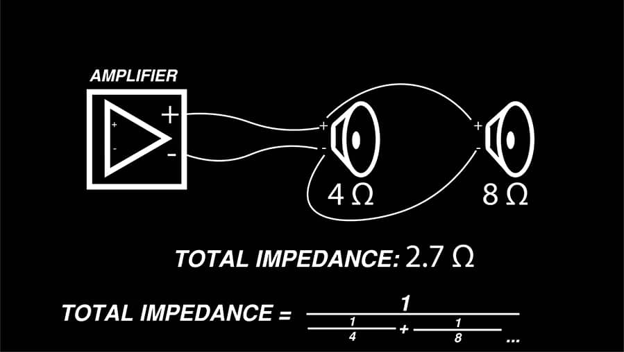

Do your homework on adding 2 ohm speakers. The dashboard and front door speakers are wired in parallel. If all 4 speakers were 4 ohm, the total ohms would be 2.0 due to the parallel wiring.

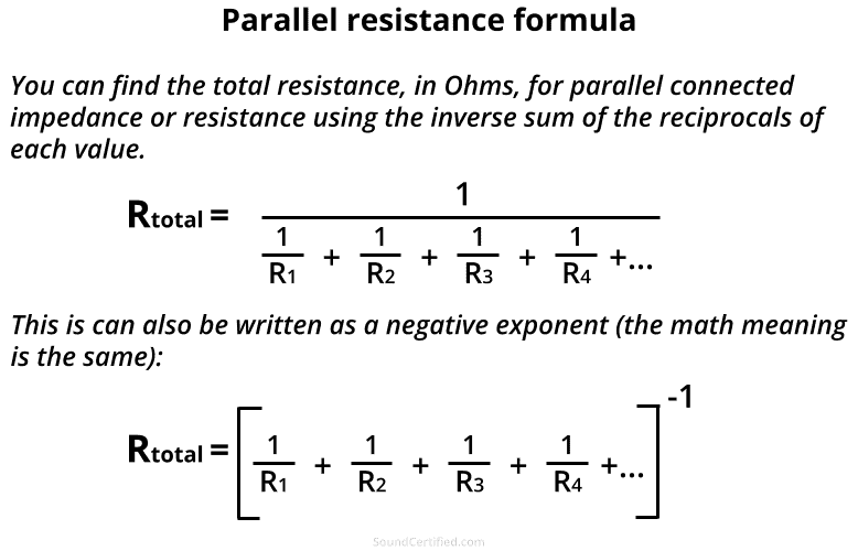

How do you arrive at your conclusion of 2.0 ohms for four speakers wired in parallel? 1/4+1/4+1/4+1/4=1. The inverse of 1 is, you know, 1. How did you come up with 2.0 ohms?

2 ohm door speakers wired in parallel with 4 or 8 ohm dash speakers would combine have a very low resistance (1.3 or 1.6 ohms) that the factory head unit and most amps would be unstable and stressed with as 2ohms stable is often the lowest.

I don't need the formula - look at my work and you'll see that's what I did. Rubicon15 said, "Do your homework on adding 2 ohm speakers. The dashboard and front door speakers are wired in parallel. If all 4 speakers were 4 ohm, the total ohms would be 2.0 due to the parallel wiring." That's a 1.0 ohm equivalent resistance.
I believe he is referring to 2 speakers on the left front channel and two speakers on the right front channel, not 4 speakers on one channel.
