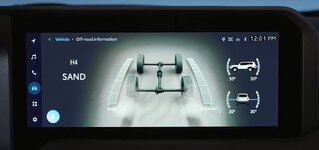

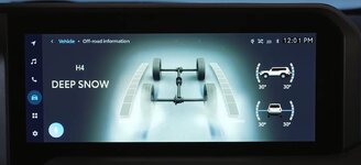

MTS info shows up on the dashboard screen, not multimedia.
This is described in the owners manual, mts duplicated in the multimedia

This duplicates the function. if there is a large display, the combination meter animation is unnecessary
It not about the animations, the selection menu is on the dash screen. Multimedia screen has no option to select a mode.
why not? the multimedia screen shows all mts modes enabled.
Because mod selection is on the dashboard screen, multimedia screen has no selection function, only the display changes based on what is selected on the dash. You can turn off the multimedia screen and MTS still works.
Yes, that's partially true. But it lets you see the mts option without the dash screen. A replacement multimedia would have been the solution for 1958.
