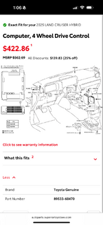

The 89533‑60470 is the 4‑Wheel Drive Control Computer that includes full Multi‑Terrain Select functionality—used in the mid-level Land Cruiser and First Edition trims. It manages transfer case control, crawl control, and the 5 terrain mode selections
To be honest, this is starting to turn into “building the entire MTS system”. If this module is installed, it will turnout 1958 do not have right brake actuators for MTS and so on.
Is this an easy thing to check???? Is it a matter of just popping the cover off to check the part number???

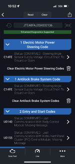

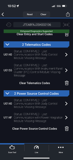

I have a soloscan I’ll try to go through the settings when I get out of clinic. If it’s just the panel and the module I agree that under 1k for the feature is a great value.
Based on everything I’ve read according to Toyota if you have the module already - verified through scanner or physically looking at the part number good. If you don’t you will need it. Along with software calibration/ reset it should work.
Only other issue is a harness but from the part numbers they seem to be the same.
