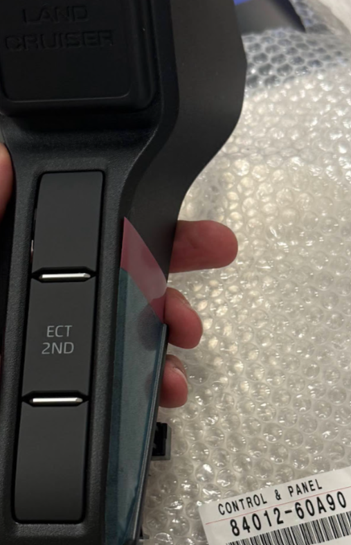

On the off chance that a wormhole has been created in Toyota's inventory, I decided to jump through. I ordered 84012-60A90 today, on the hope that the MTS switch arrives at my nearby parts counter. If it matches the parts inventory description and the MTS button isn't on it, I plan to eat the $25 restocking fee and not purchase the part.

It's a no-go. The 84012-60A90 has the ECT 2nd button and that's all it has, not even the dial. I'm a little surprised the switch that isn't available on US trims showed up at the dealer. This is my best guess as to the part with MTS 84012-60B20. The nice guy at the parts counter said there's no description on -60B20 and it's 1 of 3 parts for the LC. It's conspicuously devoid of details online. Same list price as -60B00.
So by process of elimination, 60B20 has to be the part we're searching for. I want to try this experiment on mine but, the wife shot it down when I mentioned it lol.
Three parts, only question is which is which. I highly doubt this will enable the MTS on a vehicle not equip'd with it though. The firmware on the Body ECU is likely different and possibly the body ECU is a different P/N? My guess is 60B20 as its the most expensive.
1. Drive Mode/MTS/DAC CRAWL
2. Drive Mode/ECT 2ND/DAC CRAWL
3. ECT 2ND (84012-60A90)
