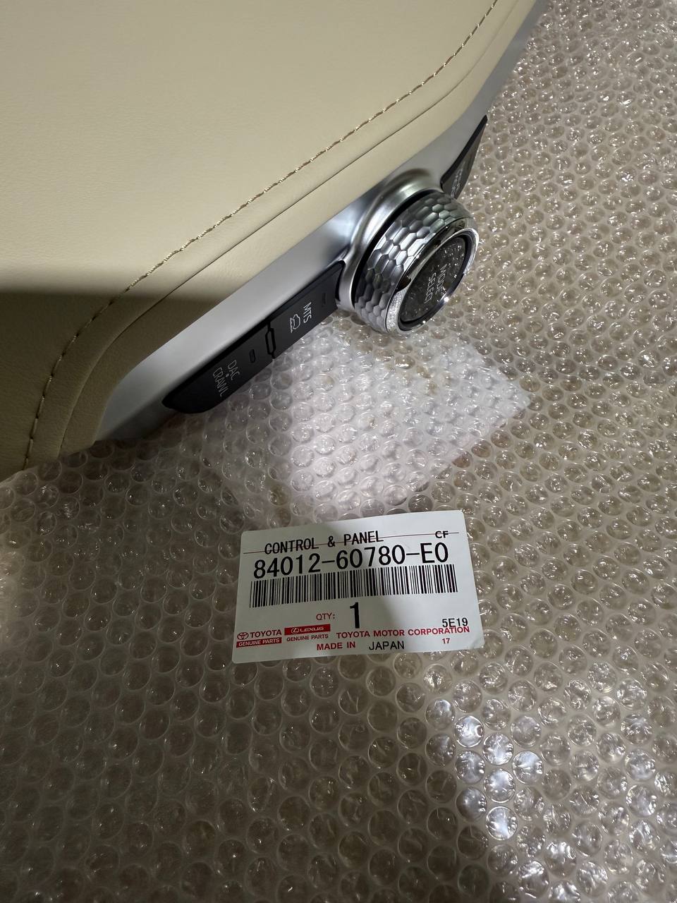

I know a few variations of that part. the picture without mode select is identical to my car (84012-60A90).

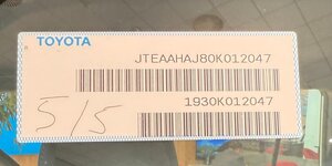

This is the vehicle in the showroom of the dealership. I took a picture of its VIN. However, in the transcript part of the mts it says (84012-60B00). This is confusing

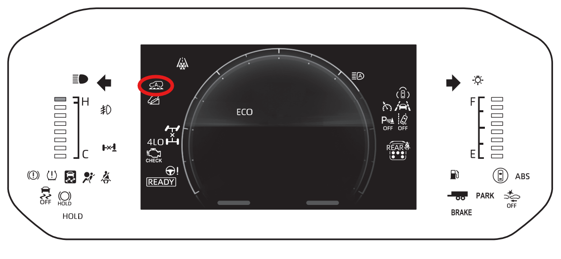

This is the symbol for 'AUTO' when using the MTS. I wonder if this symbol can change if the MTS button is installed????
I doubt it. Entire screen changes with animations etc when MTS is on, and shows what MTS mode the vehicle is in. I don’t think the info can be shown on a single symbol.
Presumably that symbol will change based on the MTS mode selected.

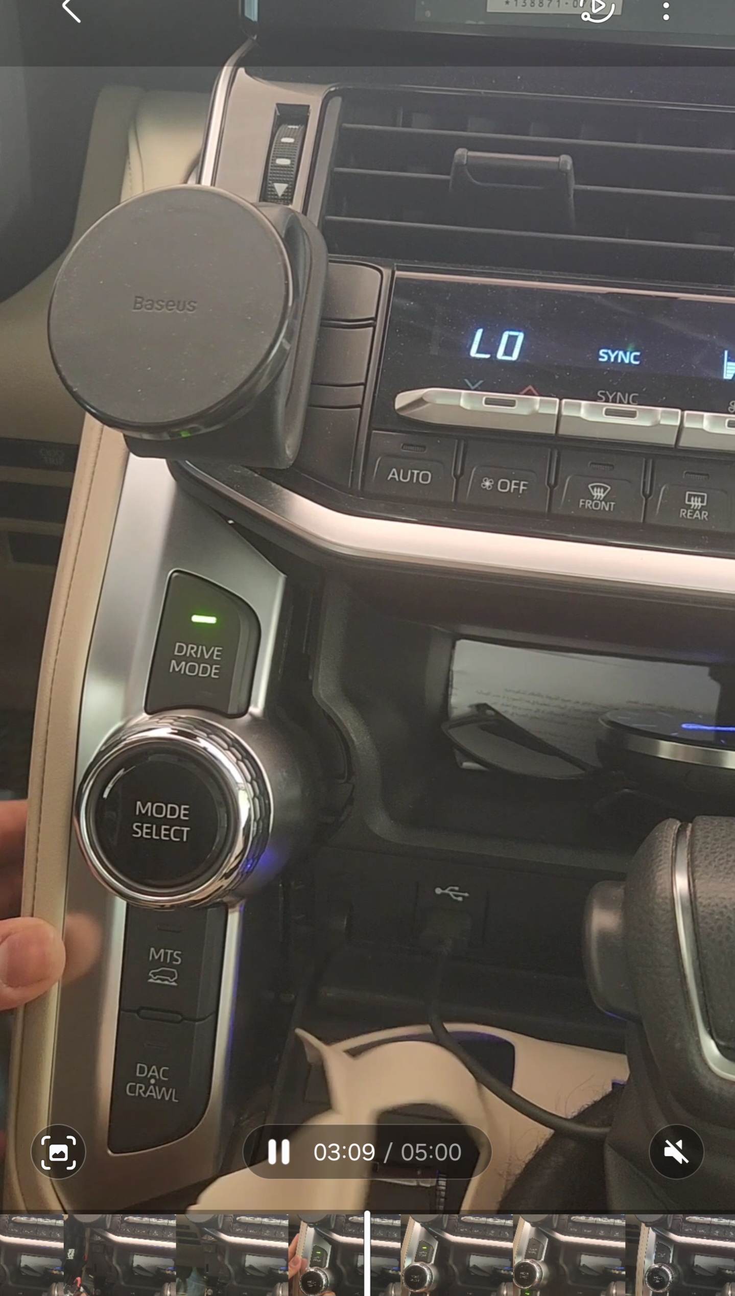

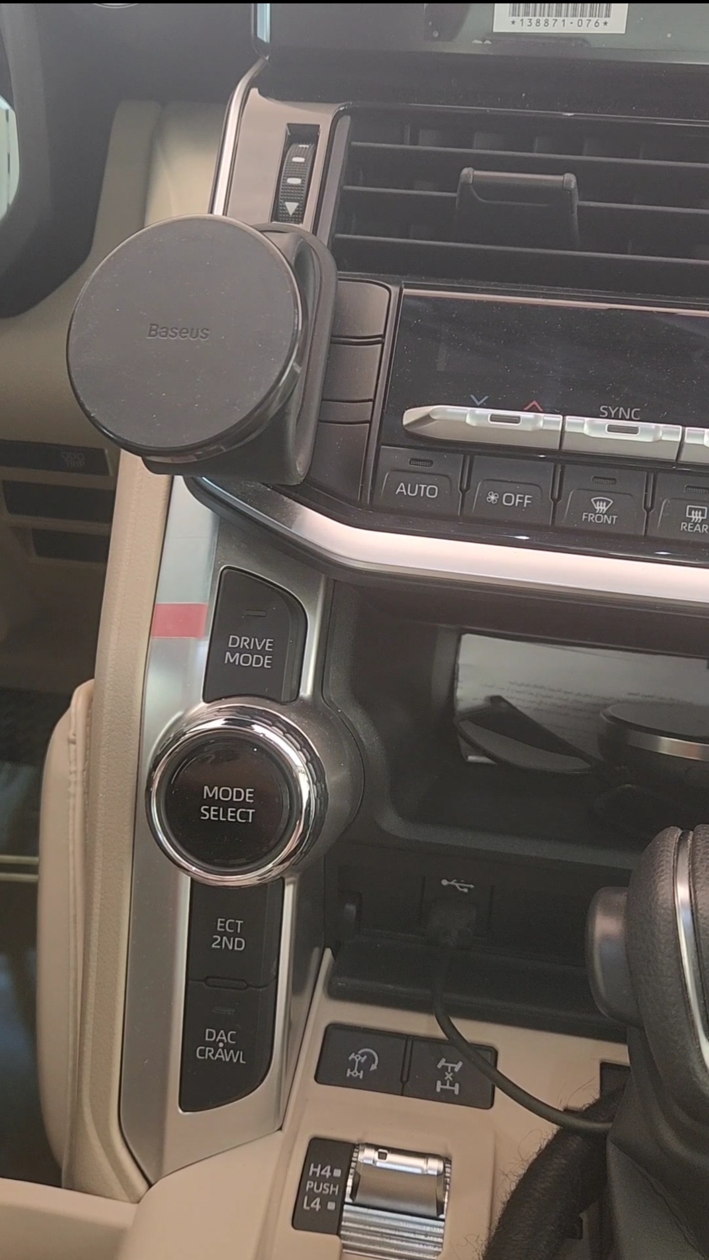

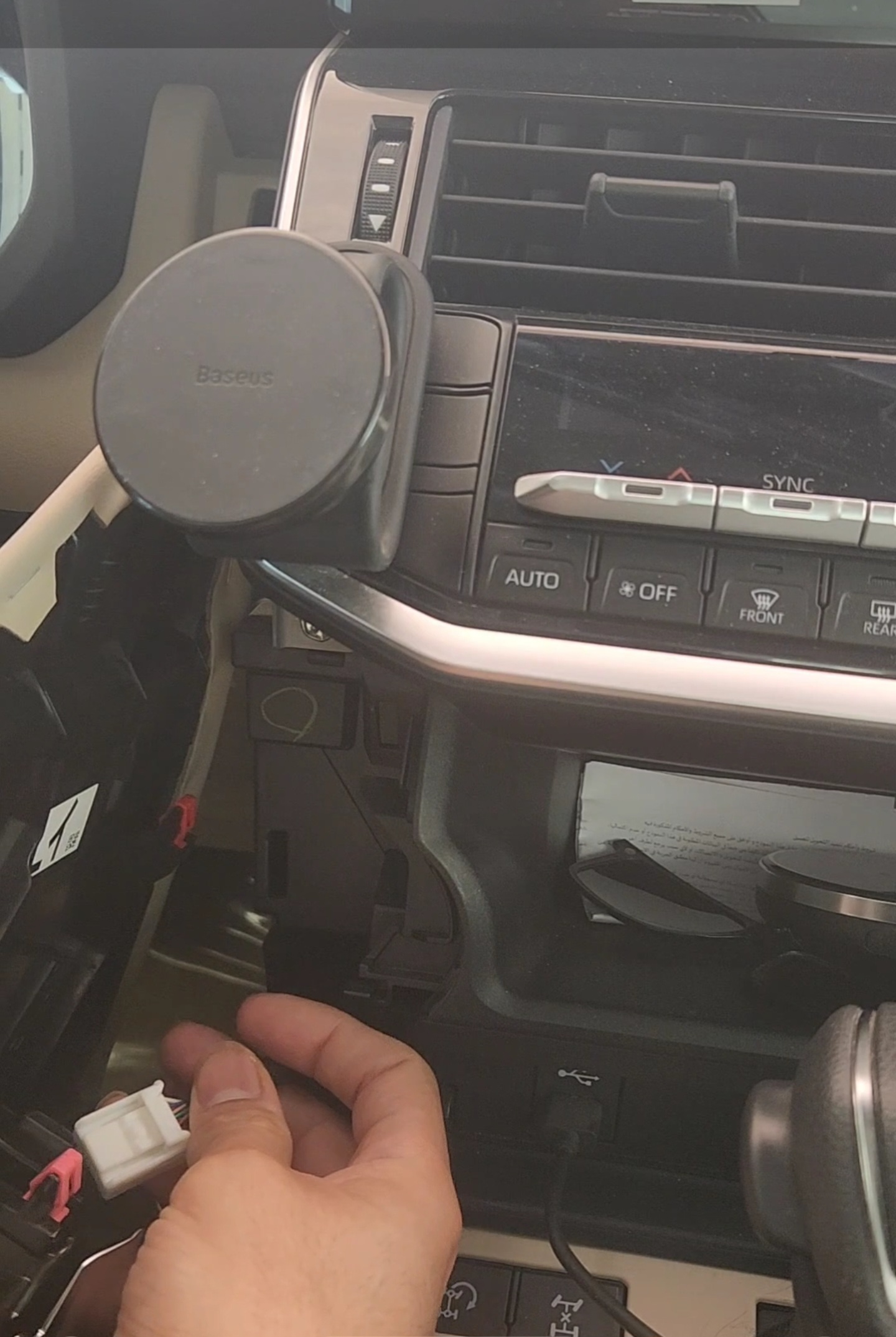

Here's some pictures from LC300 owner where they successfully replaced the buttons with the MTS ones and I have the video but it's too large to upload here.
