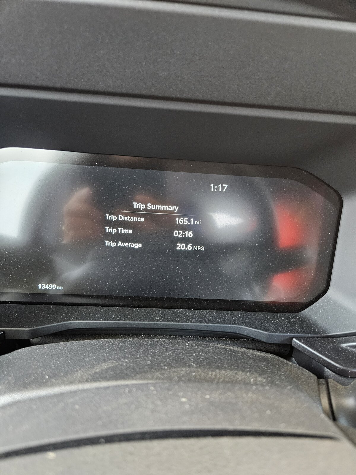

Sorry I joined late to this thread...Not sure if you tow anything or what else you've done to your LC. I have a 51 lbs Thule tub on the roof with my camping gears, a 38lbs Kammok awning, a 50lbs fridge/freezer, 2 power stations, a 38lbs Goal Zero 100w solar panel, non-stock Toyos AT3 tires and i'm consistently pulling 20..21mpg on freeway. I'm doing mostly 2-3mph more than posted speed limit. (77-78mph or whatever posted speed limit mostly).
You might give some more time on your LC. I have around 15k miles now.
Not even close...but it only has 1100 miles. Time will tell. More concrned about the tranny than the mpg right now.

MPG will improve after you have about 4k on the clock. I'm consistently getting 25 - 26 MPG on the highway driving 70-75m MPH. Bone stock 58. My best was 27.6

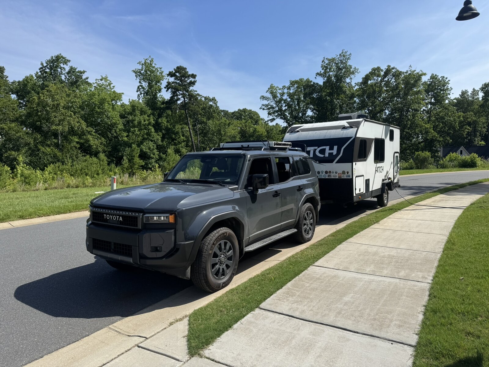

We have towed our camper some 4k miles with the Land Cruiser and have not seen the transmission temp gauge jump much. While not towing it is pegged in the middle around the icon (ussually on toward the left). While towing it creeps to the right side of the icon. I have toyed with an external cooler, but at least in my experience there is not much need.
That said we are towing 3500lb (plus gear). We head out today to the Smoky's with some decent mountain roads to deal with since I40 is closed (again). We will see how the Toyota does today with temps in the low 90s. Next week we head to PA and have to drive up I77 and Fancy Gap
I haven’t had any issues towing with mine either. I’ve towed a dump trailer. Also a few smaller cars. It has done fine.
Coming back from the Smokys yesterday I did see the transmission temp tick up to about 75% on the scale before retreating down to just past 50% near the right of the icon. Since I40 is shut down, we had a windy mountain road and it was very slow going for a few miles. Once we started to move, not issues. Additionally, it was low-mid 90F outside. Friday we head to West Virginia and have to climb Fancy Gap in the summer which will be interesting. We did it in the spring and the transmission temps were fine. I am curious to see how the weather will impact it this time. I really do not expect any issues, rather just the gauge to rise a little more dramatically.
