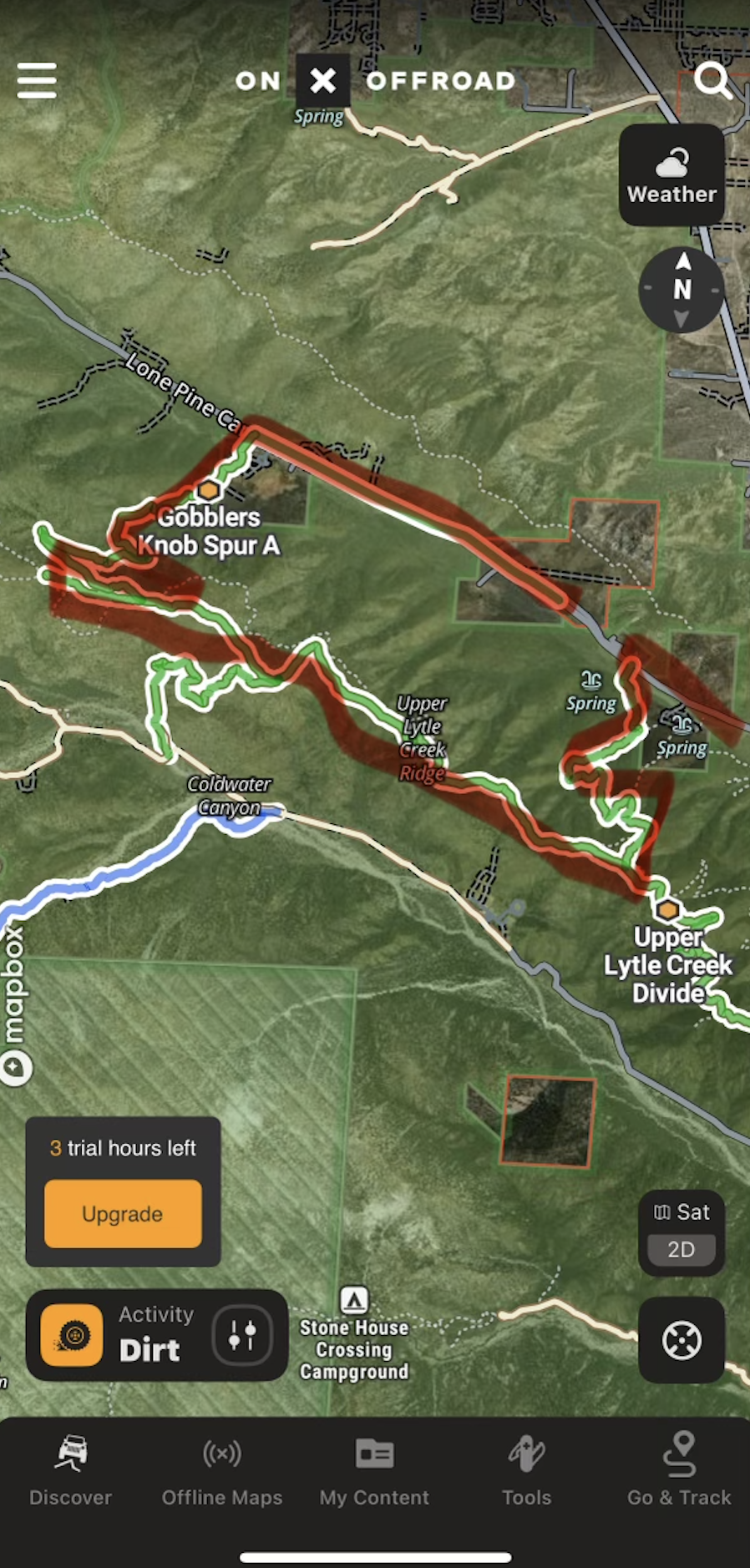

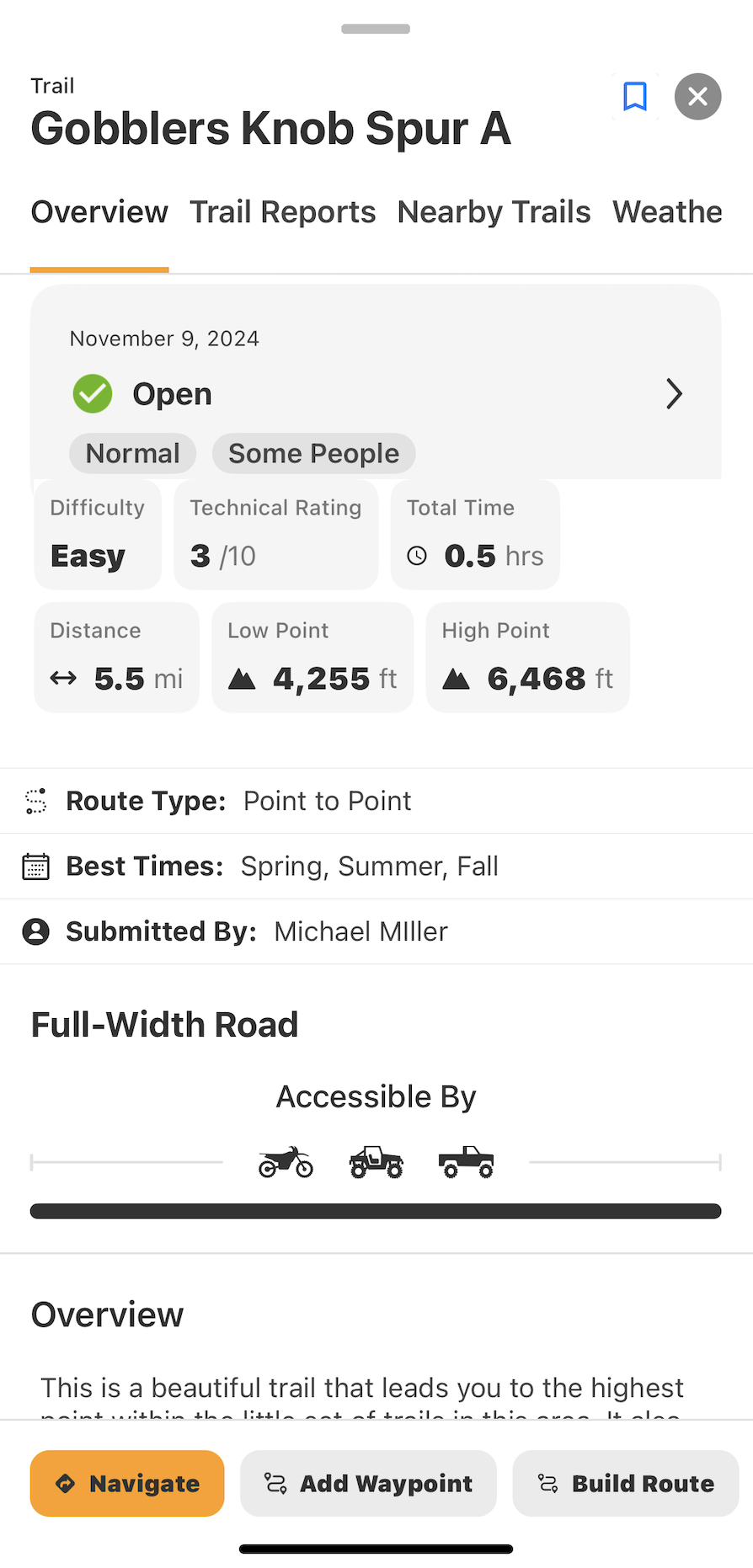

I have a 2024 LC/LC trim w/premium. Purchased it mid-August and it has just under 9k miles (oil changed @ 200, 2k, 5k miles)
Today, I took it a circular trail starting with a section called Gobblers Knob (rated 3 on OnX Off Road - see attached screenshots w/red trail-line and video) ~15mile trail climbing from 4200-6500ft in elevation. Mostly dirt/gravel roads, I spent most of the climb under 5-10MPH
During the ascent, my transmission temperature gauge hit 3/4 - just under the red. I pulled over to let it cool off and my car reeked of a burning smell. I was driving/drove the entire trail in ECO, 4hi, and the temperatures seemed to climb during the ascent which was roughly 5 miles, 4000 ft in elevation, @ 5-10mph. The middle section was relatively flat, and the back half was mostly descending thus I was just managing the brake (transmission temps didn't rise)
This is my first time off-road in this car at all, and ever
1. Did I do something wrong? Should I have driven this in 4-lo? I wasn't slipping at all and didn't need to change the drive mode
2. What would you do next, if you were me? Should I contact my dealer/toyota?

Torque converter is probably slipping going uphill at 5-10 MPH. What was your RPM during the climb?
You could try LO or switch the gear to manual and use a lower gear at higher RPM to see if it prevents slip.
I would personally use low range on that do the torque converter stays locked.
My RPMs were low, nothing spiky or super high/noticeable...
going forward I should do that on 4lo? I hope I didn't cause any permanent damage, figured it wasn't much different from driving up a paved driveway at the same speed/distance?
Move the shifter over to manual shift. I would do 1st gear if going 5 MPH. The vehicle is anticipating a shift so the transmission will slip the torque converter and clutches.
Low RPMs is the problem in this case. Since you are going uphill at a low speed and low rpm, torque converter will slip to prevent the engine from stalling. Torque converter uses some type of “friction fluid” to couple the transmission and engine, so when it slips constantly for a long duration, a lot of heat is generated.
I am not sure how familiar you are with manual transmission, but a good analogy would be driving the truck with clutch half pressed (rather than down shifting), which will overheat the clutch.
So under these conditions it is better to put the transmission in manual mode and down shift. You could also try using sport mode, which makes the transmission hold on to lower gears. I think using eco mode was also partially responsible in your case since it tries to keep RPM low. 4LO would also work, but I think it would not come to that if you keep RPMs high in 4Hi.

I doubt you caused any damage at all.
Low RPM’s combined with low speeds will usually = the torque converter unlocking to allow the torque converter to do torque converter things like acting as a fluid coupler. The reason the torque converter will stay unlocked is that your speed is going vary and the programming at these low speeds will call for the torque multiplication ability of the unlocked converter to allow you to move around with low engine load/output in low gears.
Imagine doing this with a manual transmission without a creeper 1st gear, you would be slipping the clutch constantly, guess what that would do to the clutch on a manual transmission? If you guessed get it really hot and damage it you win a prize!
In your automatic transmission this works the fluid in question, transmission fluid, and when you work that fluid by imparting energy from the engine through an impeller it will build up heat in that fluid.
By selecting low range on the transfer case a modern electronic control transmission knows that the torque multiplication is now being achieved with the transfer case. So it will signal the torque converter to stay locked. This should reduce heat build up in the transmission fluid because the torque converter impeller isn’t working the fluid.
Hope this explanation is both helpful and effective in real application.

It smelled like something was cooking a little bit, but I pulled over and stopped my car to let my dogs out anyway, probably 2-3 times so the car got to chill out a bit. On the way home I hopped on the freeway and it rode normally.
If you weren’t in the red on temps I wouldn’t worry about it.
When I did my little lest at under 1000 miles it had some definite odors coming off the vehicle. New trucks take some time to burn off all the assembly and shipping preservatives and grease, running down the highway isn’t necessarily going to get that done.
