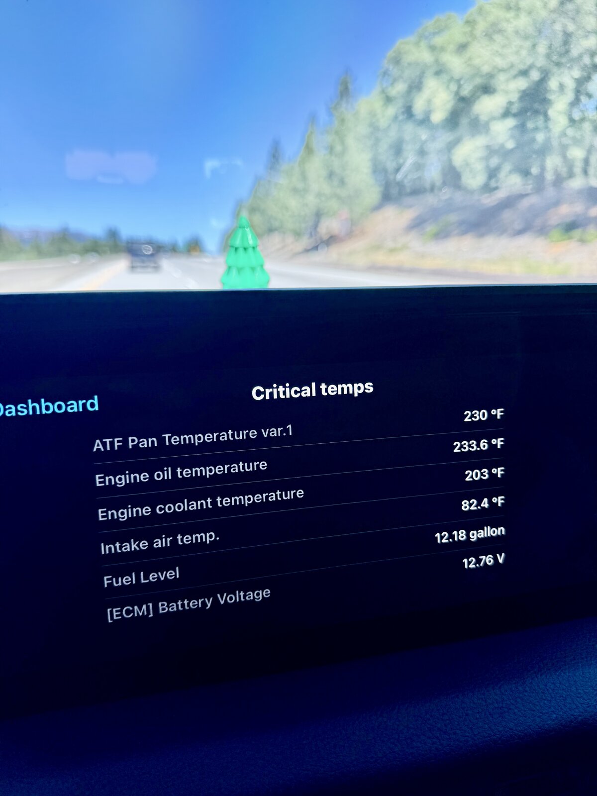

Climbed up a fairly easy grade northbound near Dunsmuir, CA towards Shasta.

Went to one of our local trails in San Diego near Ramona,CA (Black Mountain Trail) with a 2023 Tacoma and 2020 4runner. Easy trail with few small rocks, 7.5 miles long, about 1500ft elevation. All of them in 4x2 and I just locked the center diff. By the time we were at the top mine was 256F and theirs were under 220F.
Submitted a case with Toyota Brand Engagement and they were not very nice at all. Very dismissal of the problem and even reffered to page 228 in the manual. She just told me that she would contact my local dealer and have them take a look at it, but if they can't replecate the problem they will not be able to help me, so I guess they do not care about the data that is stored in the ECM or maybe as others have stated they do not have access to it. You can see on the screeshot how the temp creeped up all the way to 250+F. Then turned off vehicle at the top to walk my dog and chat with the other Toyota guys. Then on the down hill it cooled down.
I wonder why Toyota is not able to read this data and say: "250F on a brand new tranny on an easy trail is not normal". We'll see. Went to see a Bronco Badlands Satchsquash this weekend...very tempting!!!! But I really want to keep the LC (much better built vehicle and is a Toyota), but at times I feel that this tranny thing is going to be a big problem down the road.
Very dissapointment

What did the dash gauge read? Were you in low-range? Were you in manual gear select mode?
3/4 of the way on the gauge. Just locked the center diff as all the others were on 4x2 (just like I did when I owned my Jeep 2 months ago). No manual.
Last time I did this trail, I used the manual mode and shifted between 1st 2nd and it went up to 235F. But since the other Toyotas with bigger tires were doing it all in Drive and 4x2, I figured I would try it like a normal car.
