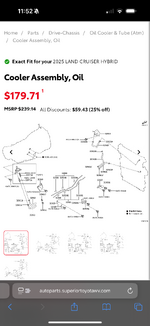

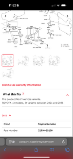

I have a 25 1958 no cooling issues so far. I can attach the diagram the shows the cooler and location. If you’re towing or off-roading a lot I would maybe just upgrade the cooler. Mishimoto makes a good kit for example.
