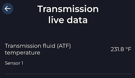

231.8 F Transmission fluid temp (per Carista app. PSA - don't buy this app if you're offline a lot. It logs you out automatically and requires cellular connection to log back in).

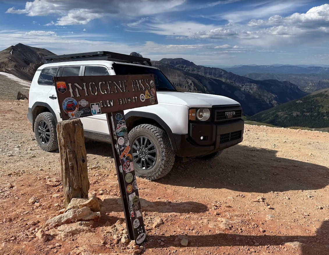

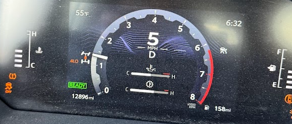

Pics were taken at the top of Imogene Pass. Transmission is always 210-235 for me in 4 Lo driving. Outside temp at this elevation is cool - around 55F. I never hear the fan speed increase to cool the transmission down. I can't decide if everyone's LC is similar to these temps and not many obsess over their trans temp gauge, or if some have a transmission cooling problem. Mine has been like this since Day 1. Taken to dealer after one overheat warning message episode, and dealer said it did not throw any codes so there was nothing they could see.
If driving close to highway speeds air flow seems sufficient to keep it operating in a normal range of 200-215F.
1958 edition. 04/2024 build date. 275/70/18 KO3's and a Front Runner roof rack are the only modifications.
My hunch is there's some issue with it kicking up the speed of the electric fan to aid in cooling, but it's only a hunch.

Very similar experience. As well as the comments from the dealer. Exactly the same. With the exeption that mine is still in stock tires. My hunch is that it has the same problem as the Tacomas and Tundras that the Torque Converter is not locking up when it has to, which will also explains why it feels jerky when braking. My worry is that if this is normal, we will be having to change trannys when the warranty is out (I purchased a 10/100K miles). This are not normal temps for any transmission. In 4 LO things seems to coll down on mine to 220F or so. But just to give you an idea, I did the exact same Imogene pass on my Jeep Rubicon 4xe in 4auto on the summer of 2023 (basically 4HI on demand) and the temps never went over 200F. Did Rim Roccker on 4x2 and it didn't even reach 190F. This is not Normal
Do you know if that is the torque convertor sensor its reading?
It's more than likely pan temp reading, most OBD devices on Toyotas read pan temp and require a special PID for the other sensor to be read.

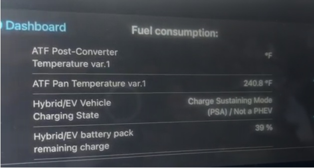

Unfortunately the LC 250 only has one sensor that can be read with our OBDII scanner on the Tranny Pan, but not at the TC. Weird.
There are two sensors, you have to have the correct PID to read the second TC sensor. It can be done with the Scan gauge, I don't remember the correct PID but it is the same as other Toyota models IIRC just don't remember which one.
OK, thank you for the info.
TXD - 0701221AAA
RXF - C462051A36AA
RXD - 3008
MTH - 00090005FFD8
Can you try these for sensor 2?
  • 0701221AC0
  • C462051A36C0
  • 3008
  • 00090005FFD8
Sensor 1 on all other Toyotas is Pan temp and sensor 2 is TC.
