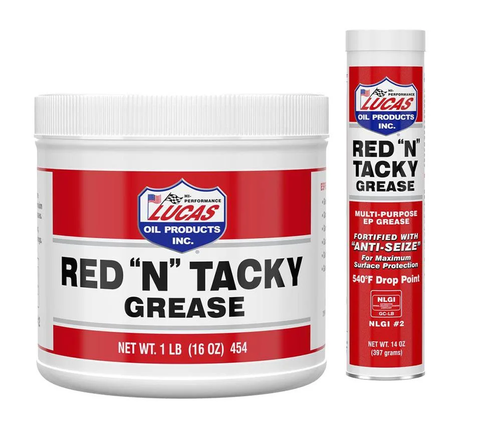

Hello Everyone,
It will be great to have software update. However, for meanwhile those below steps helps to mitigate the harsh shifts both ways.
  1. Register the driver name and link the key. This helps the ECM to learn/memorize your driving behavior and adjust the shifts accordingly. Instead of driving as a guest.
  2. Turn off ECO indicator. From the dashboard.
  3. Apply the needed lubricant for the drive shaft as per the manual. LUCAS or AMSOIL. The grease reduces the impact and shaking between drivetrain components (transmission differential,axle) also prevents noise from rubber joints.
  4. Last resort, you can ask the dealership to rest the ECM. Which is also a standard procedure after a transmission oil change.
Best of luck.

I can confirm....I just greased all of the u-joints and the shifting was much smoother. I think Toyota installed these dry. I literally had to pump 6-7 times before any grease squeeze-out was visible.
