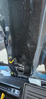

She is definitely temperamental; some tolerate, some find solutions, some trade it in. I had my share of rattles. The one that was driving me insane was the faulty striker, which got fixed by re-welding the metal plates. But the pillars are the main cause of rattles/crackings/vibrations for me. I soundproofed the pillars and added sound foam inside. Reduced rattle by 90%. Hope this helps. Cheers.
