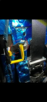

So my land cruiser has been at the dealership for 3 weeks now, I recieved a call from them Wednesday, they claimed to have located the sound comimg from the B pillar, see attached pic, said these three welds are the culprit. Sent my vehicle to a body shop to do the welds, service manager said their body shop folks weren't proficient enough to do the welding. He called me last night and said they were going to drive the car today and saturday to make the sound doesn't come back. I will update when I hear more. I'm keeping my fingers crossed.
That’s a step in the right direction. I’ve ruled out door cards, loose wire, sound deadened everything, adjusted strikers, seatbelt attachment points, and put felt padding on fuel door. I also had Toyota replace the entire seatbelt assembly for drivers side. None of it helped. It’s definitely coming from poor welds and metallic tapping of the panels.

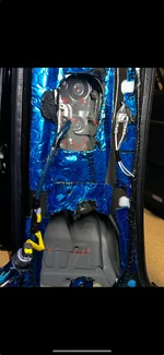

The B-pillar rattle is finally gone! My dealer (two different Toyota dealerships) would not fix it. I finally removed the B-pillar cover, tapped-welded the sites (red dashes), and added felt behind the seatbelt assembly attachment. I then covered the area with sound-deadening sheets. So far so good. Everything else (door striker, door card, mirror, grab handles, etc. we’re not the source). Toyota has yet to create a TSB for it. On a side note, SIX Toyota N. America executives “retired” (forced out) in 2025 and their roles included VP Quality, Senior manufacturing, VP manufacturing, Chief technology, and so on. Toyota is aware of its shortcomings and this isn’t a good look. Hopefully, they fix other members' rattles and create a TSB soon.
