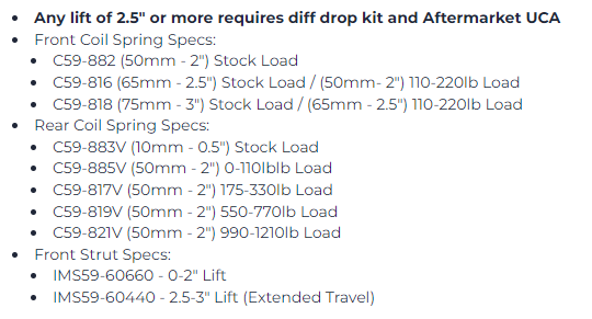

This is what I'm basing it on...
Looks like you can choose among those based on your needs and they are each available from the drop down menus in the links above. This is the route I am going to go with 2" lift and stock load springs front and rear. I'm not carrying a lot and historically the word I have read is they tend toward the stiffer side.

IMS59-60441​
Sequoia rear shocks but some sites confirm fits LC250.

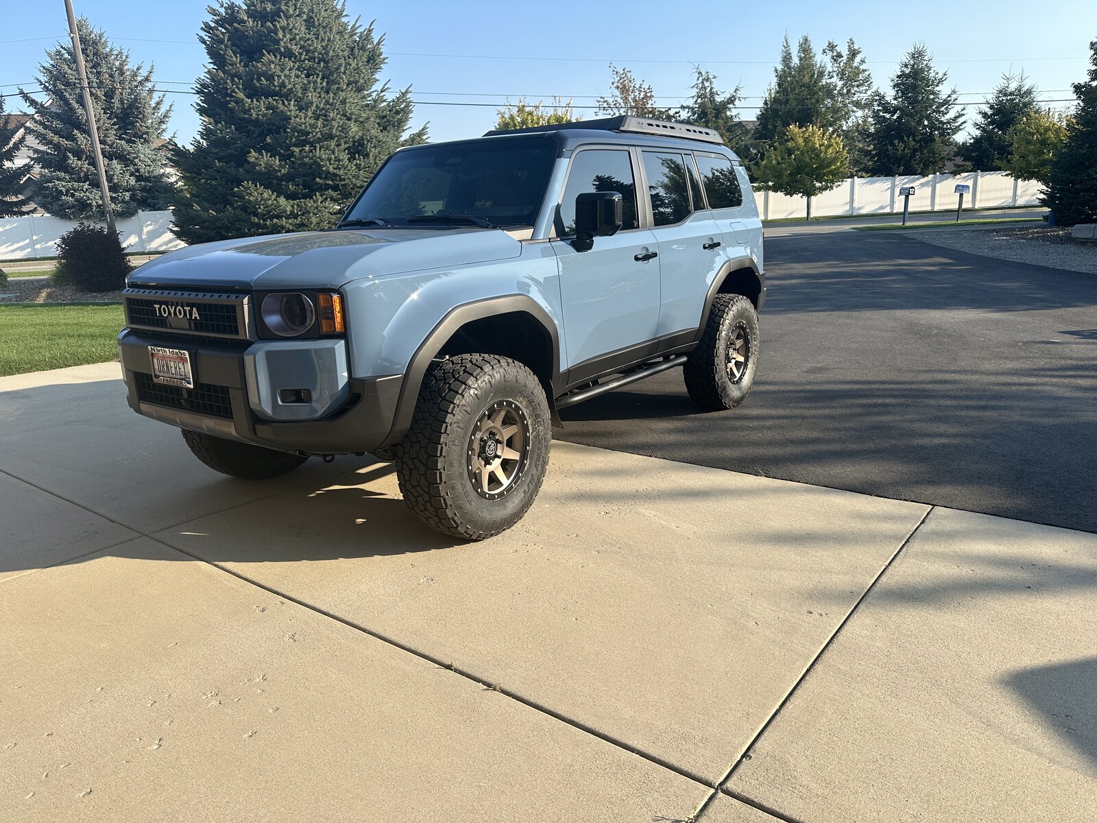

To me this is the perfect setup. Would you mind telling me what you did exactly? Is this the Westcott preload collar lift kit giving 2.5" of lift to front and .75" in the rear? Any change to shocks or springs? What size wheel here - 17" or 18"? And then tires - they look like KO2s - which size? Thank you in advance!

This is the exact set up you stated
It seems a little to squishy in the turns coming down hill at 65 to 75 MPH.(leans alot) not sure how it. Compares to stock as I bought it with the lift.
Just took a 300 mile trip woth a 3000lb camper(loaded) dropped the rear about 3 inches but drive great. 7.3 Mpg up. 13 mpg down.

Rough Country has one out. Total Chaos is about $3,500 for kings up front and $5,300 with rear kings. They won’t be out until mid Oct. Westcot, I was on the list and paid for one and still waiting. So I went with Rough Country. I was able to get 35x12.5 / 18. With a 25 offset.
Is this their 3.5" kit? Looks good. Thanks in advance!
