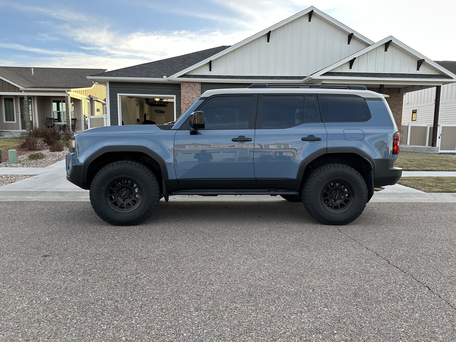

This looks about perfect!
What all have you done exactly? The Peak 2.25" 2-piece collar lift? Only $238.00!!
How much was it to have that installed? And what size tires and offset do you have?
Really looks good -
Really looks good -
It’s the 2 piece front and 1” rear puck. I installed it myself. I’ve done a lot of lifts so it was pretty easy. Wheels are methods 17” +35 with Toyo at3 35x11.5x17. It still has some rake. I ended up with 1.5-1.75” in the front and 1” in the rear. Very similar to what people report with westscott. The two piece front and leaving the rear stock would probably be close to level but I’ll have the back loaded and tow a small camper, so I wanted some rake. Very happy with the setup for now!
