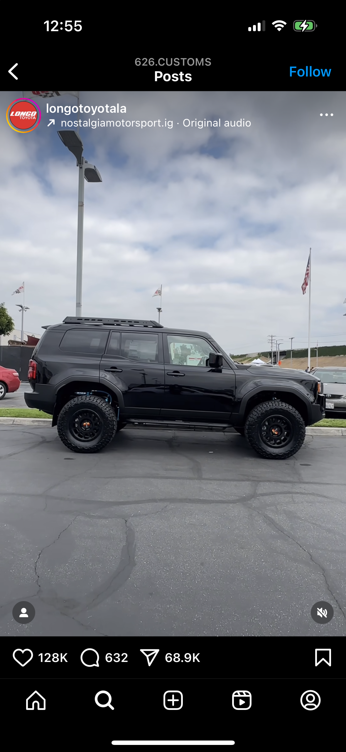

This one has full King suspension + camburg UCA
