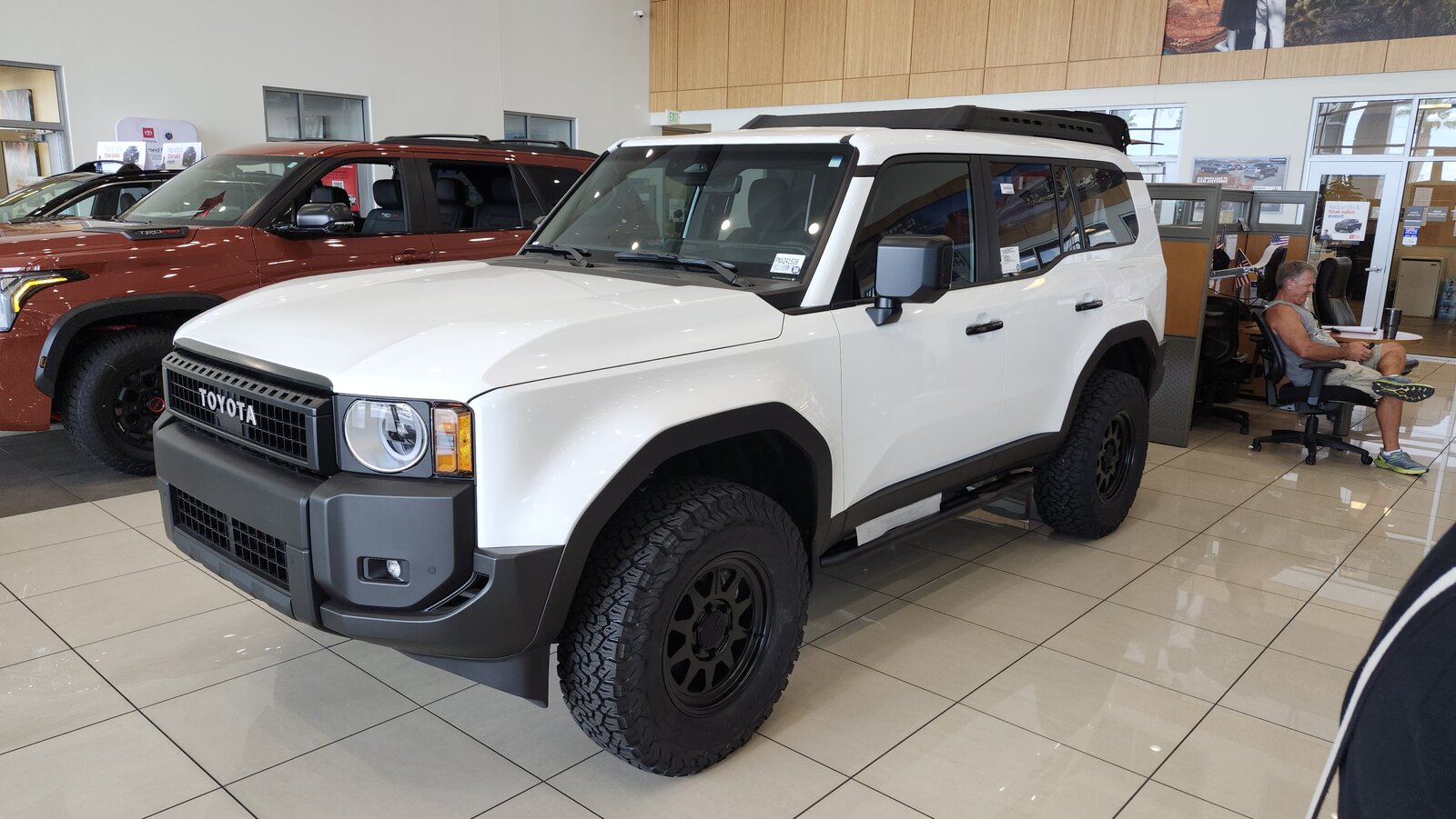

Just added Westcott lift plus 40 + Method wheels Open Country tires 285/75/18 just love it.
To me this is the perfect setup. Would you mind telling me what you did exactly? Is this the Westcott preload collar lift kit giving 2.5" of lift to front and .75" in the rear? Any change to shocks or springs? What size wheel here - 17" or 18"? And then tires - they look like KO2s - which size? Thank you in advance!

Looks great, I am waiting on my Westcott collar to arrive still...are those 18 inch wheels and which tires if you could share? Looks like Open Country?
While we wait for an answer I'm guessing those are method 17" wheels maxed out with 285/75/17. A nice feature of 285/70/17 and 285/75/17 size is that there are different brands available with a six ply C rating. The 285/70/17 seems to fit in the under vehicle spare location.
