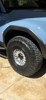

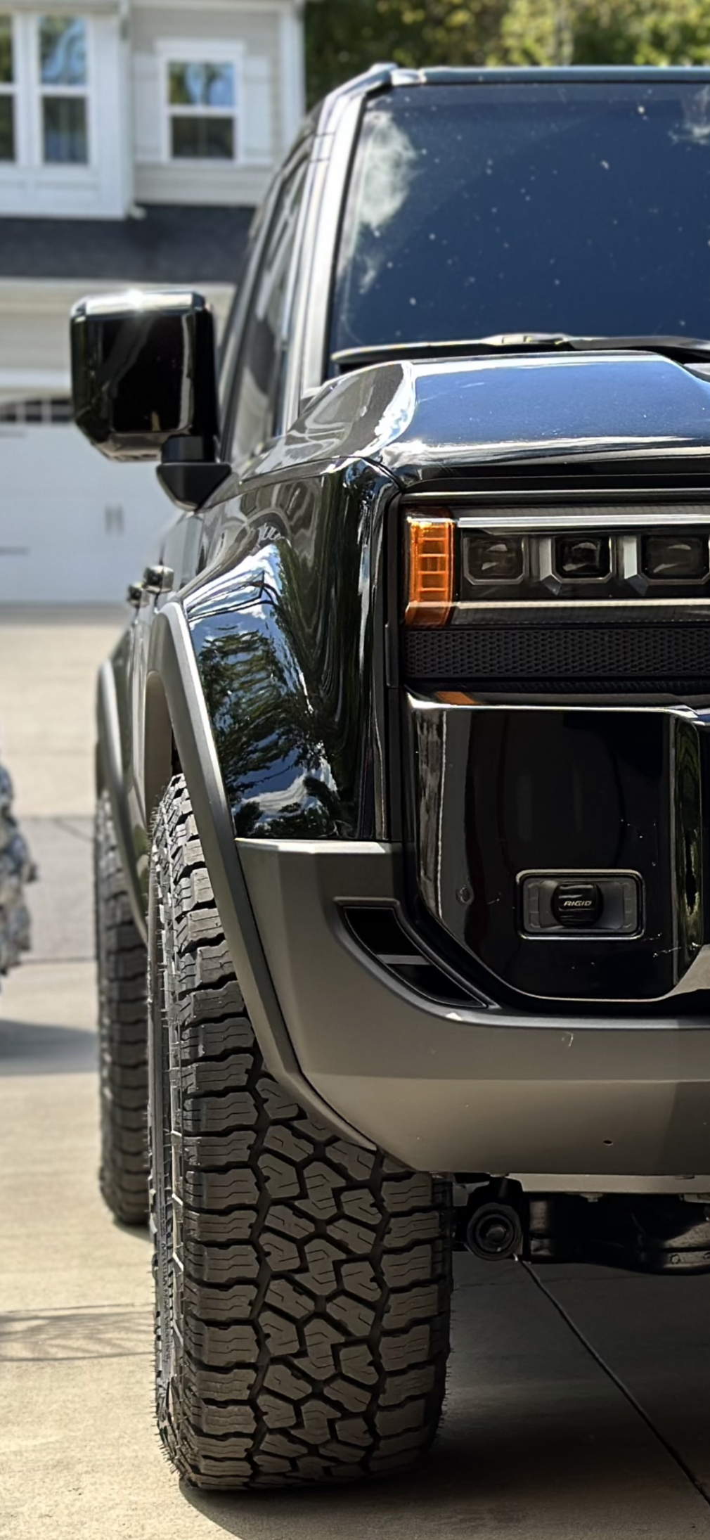

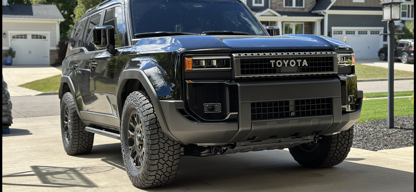

I've been lurking for some time on this thread, obsessing about tires. For now, I want to keep MPG up and maintain the stock wheels, suspension, and ride, but with a more aggressive tire. I also wanted the largest tire that would fit without any mods, and that would fit in the current spare tire location. Yesterday, I had Discount Tire mount General Grabber AT/X 275/70R18 116S and am very pleased with the results. I notice very little difference in the ride, perhaps a bit more firm (which I think is good), and about the same road noise as stock (I have active noise cancellation and fake engine noise turned off). These tires are only 7 lbs heavier than the OEM tires. I also gained about 3/4" of clearance.

I had run those on my 4Runner. I liked them and thought they were decent in the snow.
im glad you posted this because im looking at those same tires when my lift and wheels come in. I like the non E rated versions of those as the tire weight is only 47 lbs per tire. Thank you

I went with KMC IMS 17”x8.5” wheels (KM552MB17856825) and +25mm offset with TOYO Open Country AT/III (285 x 75 R17, 117Q C1 rating). I like the look and ride with these. Additionally this is the largest combination that fits into the spare tire wheel well. 40 psi for wheels on the ground but spare was lowered to 34 psi to fit in wheel well. These are just slightly below 34” diameter.

I like the 275/70/18s on the stock wheels with stock suspension. I think it looks great.
Would love to see a full side shot of the LC.
Do they rub at full lock ?
I’ve been looking at the open country tires
