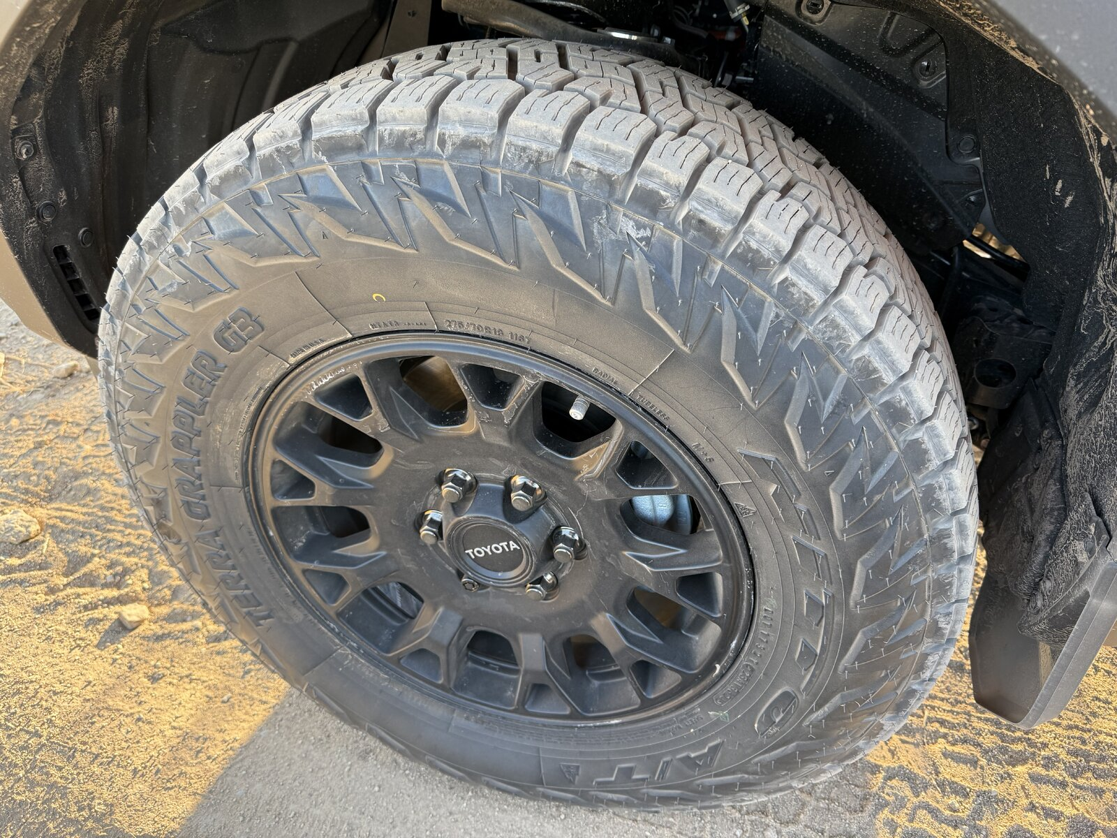

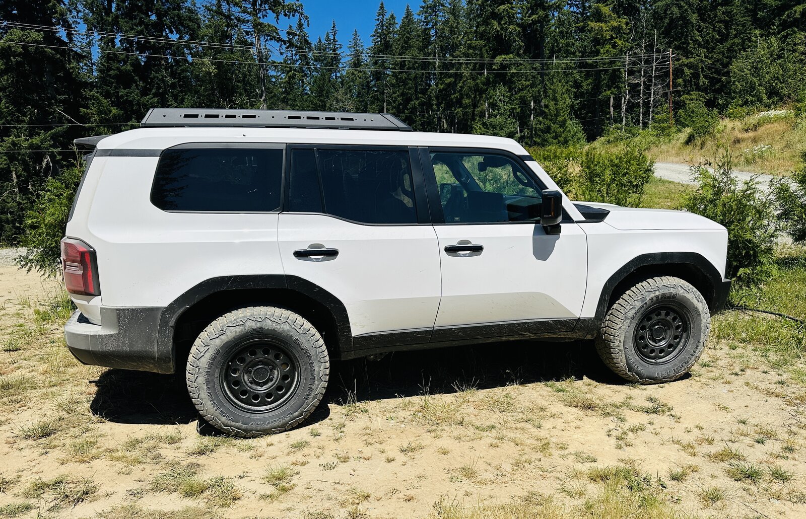

Looks like the 275/70/18 SL Nitto Terra Grappler G3 are available now, as another member posted installed pictures. I think they will be a great option!
Anyone else running the new Nitto Terra Grappler G3 275/70R18 with some side shots and different angles?
Check out the link for the thread.. there are more pictures and the owner was happy to provide others.

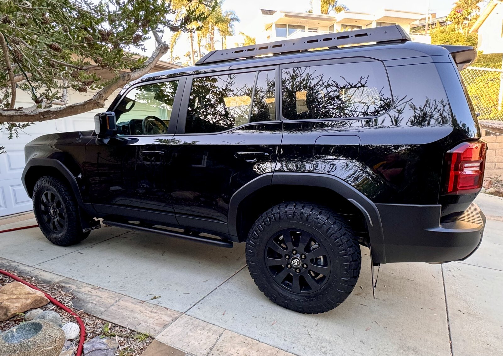

I replaced the 245's on my 1958 with Firestone AT2's in 265/70/18 and there are zero issues - you can use your stock wheels. This is the OEM tire size on the LC and FE trims so no rubbing or poke, the speedo is likely off a 1 or 2 MPH but that's not an issue for me.
Don't know why Toyota used the 245 size on the 1958, there are virtually no replacement options. Many options (100+) in 265/70/18 and your truck will definitely look better with that size.
I had zero issues running stock 1958 wheels with 265's. Looked great!!
But I just went to bigger wheels for a nicer look with KMC's
