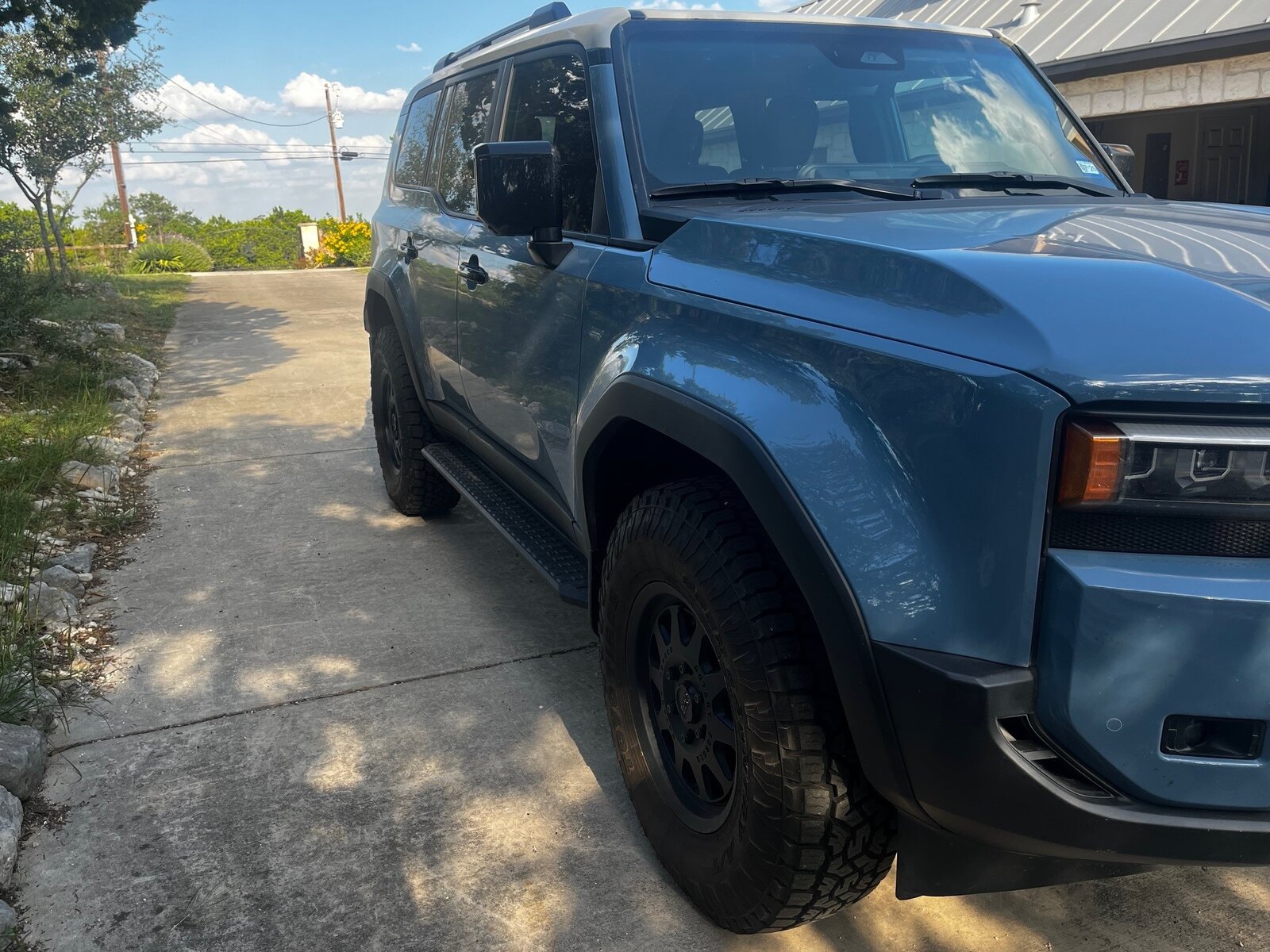

Do you have any photos?
Great to hear your feedback, that was my exact experience with these tires on my GX460. I agree with the E-rated comment, I haven't found a need for E-rated in the terrain we have in Utah (Moab, trails, etc) unless the rock crawling a 4+ with aired down tires.
Great thanks! Awesome looking LC!!
Thanks, I was originally going to run a +35 offset but a buddy suggested I go more aggressive with the poke. I personally am so happy I decided to go with the +0 as the stance on stock suspension is so much more aggressive now. A lift/level would look more proper for sure but the stock setup will get you by for a bit.

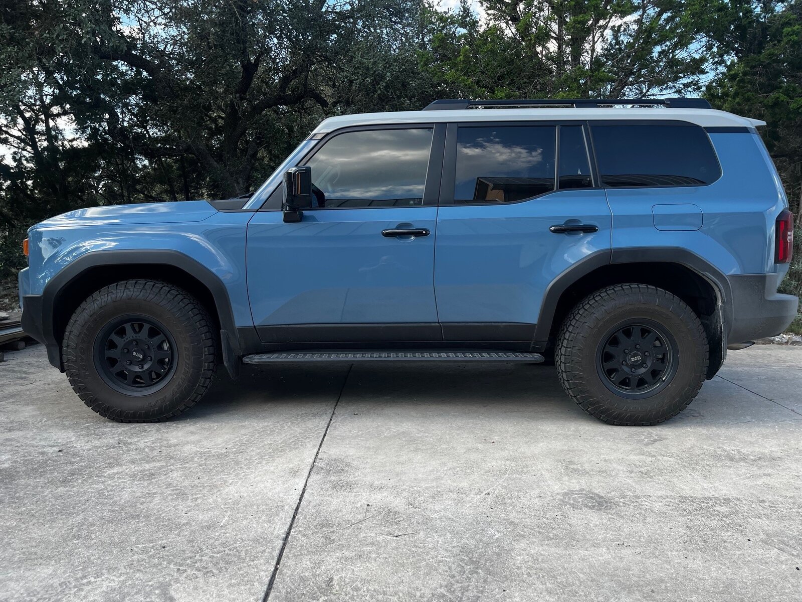

Took my LC up in the mountains and used the 4wd on some trails. Really happy with the 35” tires. There was no rubbing and ran on some ruff trails. Have always ran Ko2s but really happy with the Toyos on and off road.

No, just the toytec leveler.
I think it almost feels softer than then the 20” Dunlops. It’s a different ride than my Tundra but feels more like my sons Jeep but without the clanky feel.
I really think it looks good. Like my wife said, now it doesn’t look like a minivan.

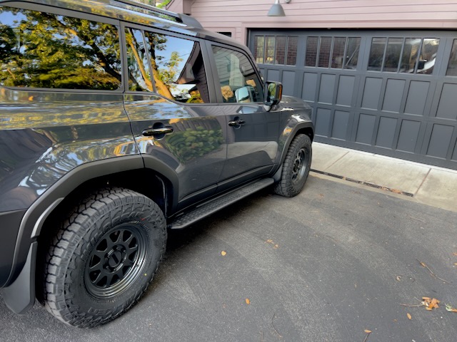

Method 316 Titanium 17x8 | 6x5.5 | 25/5.44"
Tires are Falken AT4 285/70R17 C rated, which is a true 33" tire. The C rated tire shows a bit of radial bulge at 35 psi, which is what I wanted compared to an E rated tire.
what's the offset +25?

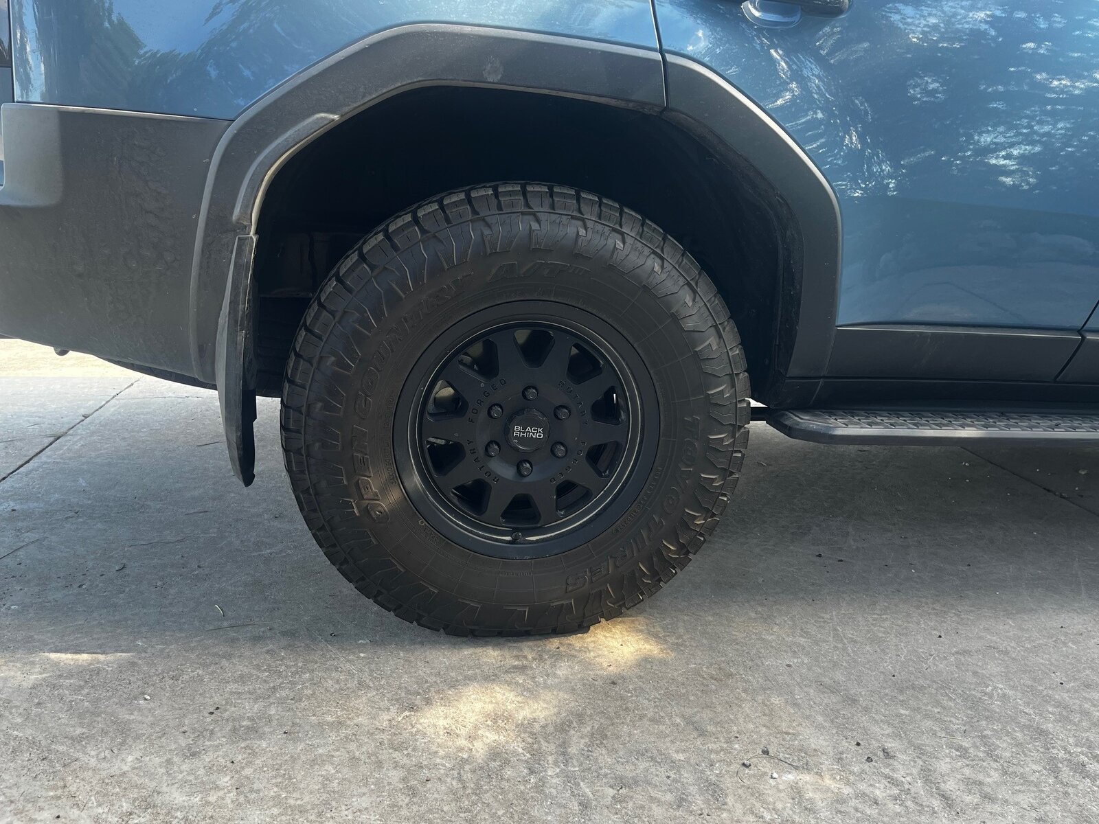

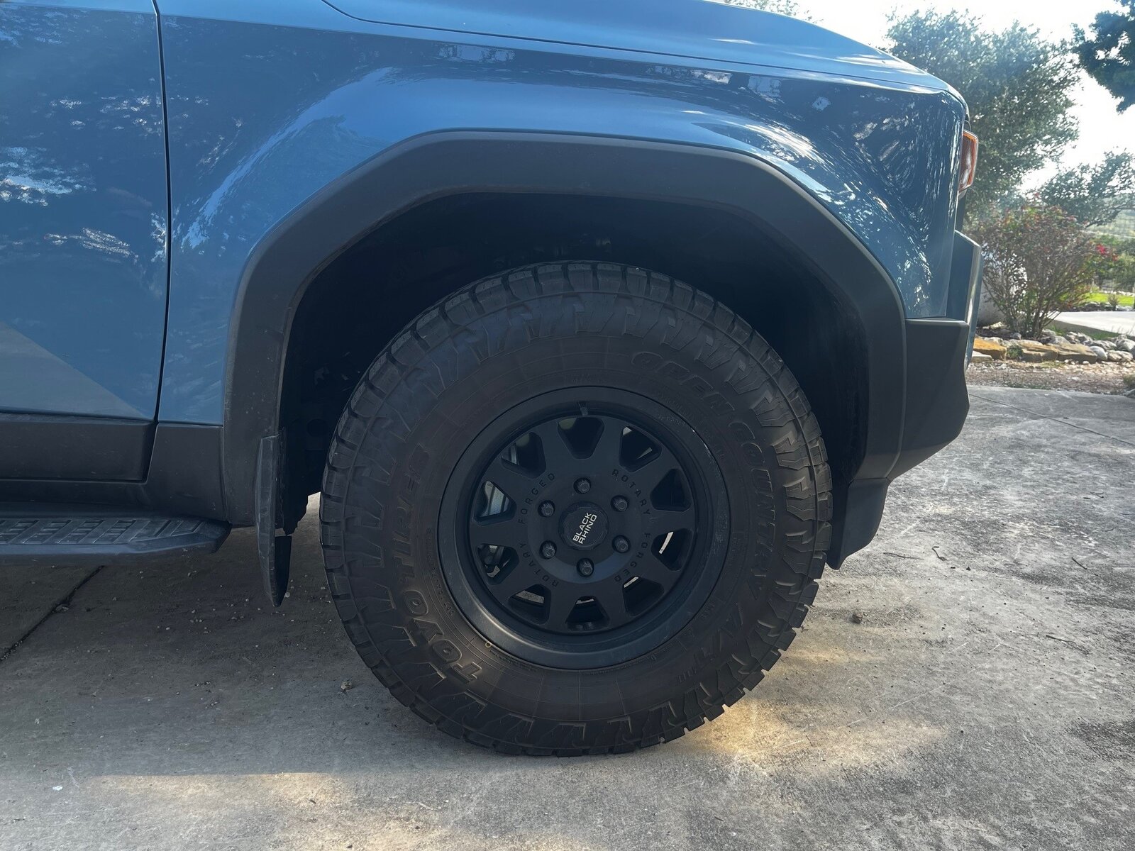

Anyone using and have photos of the Black Rhino Stadium wheel in 17x8" +35mm offset? I'm thinking of doing this wheel with 255/80R17 tires (pizza cutters)
I posted these a few pages back. These are the 17x8 +35mm Black Rhino Stadiums. It is on the stock suspension, no rubbing. I have not tried to fit a spare yet. My tire size is 34x10.50r17 Another alternative tire size which is pretty comparable is 255/80/17, it is more like 10.0 width. I have a 1" front leveing kit I am thinking of adding but haven't decided yet.
I posted these a few pages back. These are the 17x8 +35mm Black Rhino Stadiums. It is on the stock suspension, no rubbing. I have not tried to fit a spare yet. My tire size is 34x10.50r17 Another alternative tire size which is pretty comparable is 255/80/17, it is more like 10.0 width. I have a 1" front leveing kit I am thinking of adding but haven't decided yet. View attachment 13378View attachment 13379View attachment 13380View attachment 13381View attachment 13382
Ok, looking good. I'm thinking about doing this. I tried the Tacoma TRD wheels in 18" with 285/65R18 but after I put them on my truck it just wasn't how I thought it would look in my mind. It's pretty much the same width as the stock tire which I like and I'll bet it's a smoother ride over the road bumps with that 8.5" sidewall. I'm wary of the brake clearance with 17" wheels but no one has reported a problem yet with gravel, mud, ice etc.
