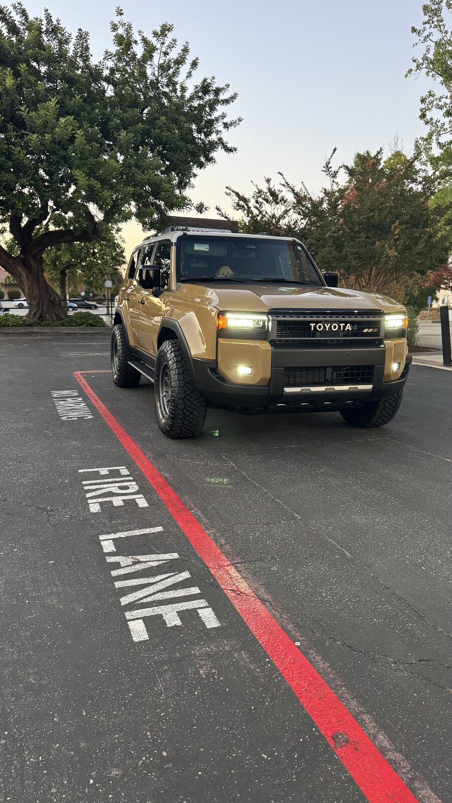

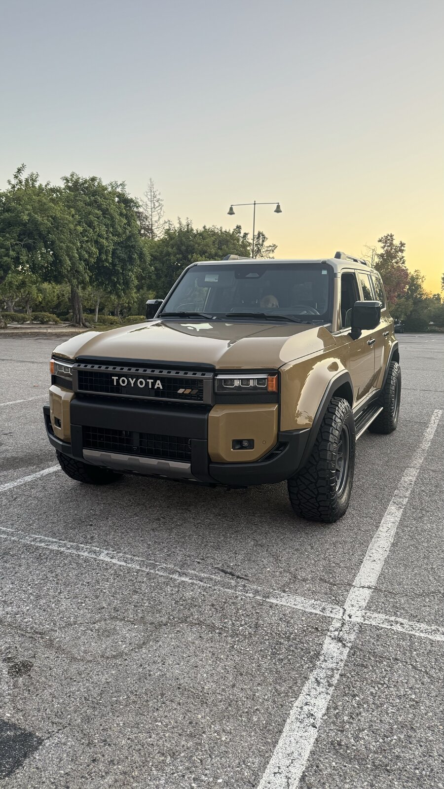

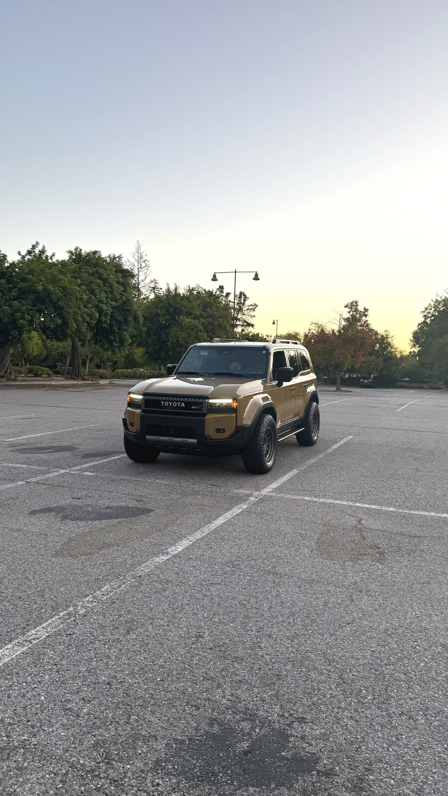

This with the Toyo leveling kit you used is identical setup to that video on how to fit 35"on. And I really like this look. No offset and looks solid.
Thanks. Yes, we followed

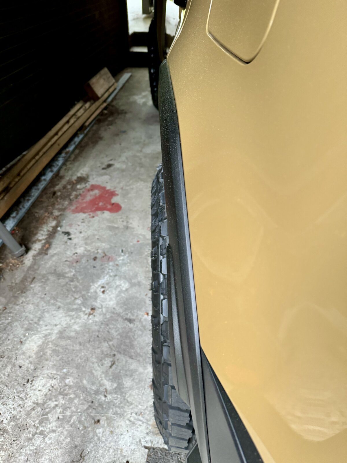

thanks. Yes, copied the YouTube video. Dealer thought we may need to remove the crush bracket but ended up not removing it. No rubbing but it’s real close. I may end up removing it.
This looks awesome! Which method wheels are these and off set.
method 707 matte black with 18mm offset. Toyo AT3 275/70/18. Basically the rounded part of the tire sticks past wheel well flare. The tread is under the wheel well still.

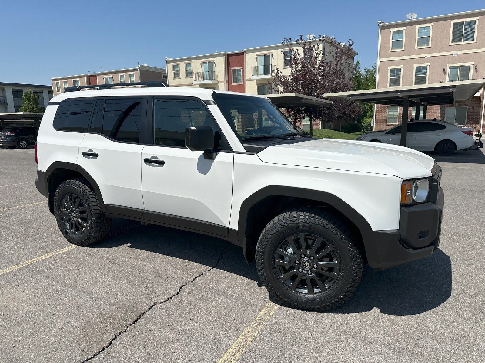

I had 265/70/R18 Falken Rubitreks put on today. First, the ride is softer and improved. They are more noisy than the stock Yokohama Geolanders that come with the 1958 but I honestly am unsure if they're quieter than the Wildpeak AT3Ws I have on my Tundra. They cost about half what the Wildpeaks do and they weight around 10 lbs per tire less. I didn't want to kill MPG or have a loud highway tire so I felt this was a good compromise. Looks just about right to me.View attachment 7298
Looks good. I went with Cooper Discoverer Road and Trail in 265/70/18. I'm curious, noticed you have the roof rails on your 1958, did you buy from dealer? If so what was price? I've decided to go this route vs roof rack due to all the feedback around noise. Thanks!
