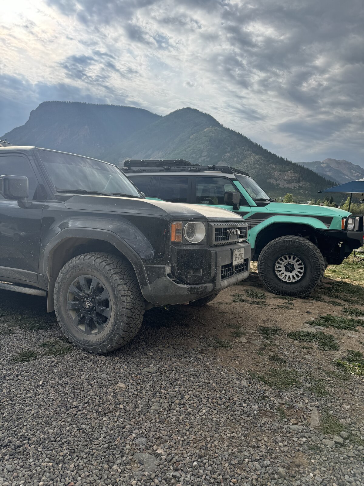

After parking next to this monster back in July (first photo) I decided to do a small upgrade (because size does matter)... Went from 275/70/18 (33.2") to 285/75/18 (34.8") KO3 tires, requiring only minimal adjustments to the front fender clips. Used Toytec strut spacer and Spidertrax wheel spacer on the stock wheels, without any cutting required. Only downside so far is no room for spare tire.View attachment 12051
Any rubbing issues with this setup?

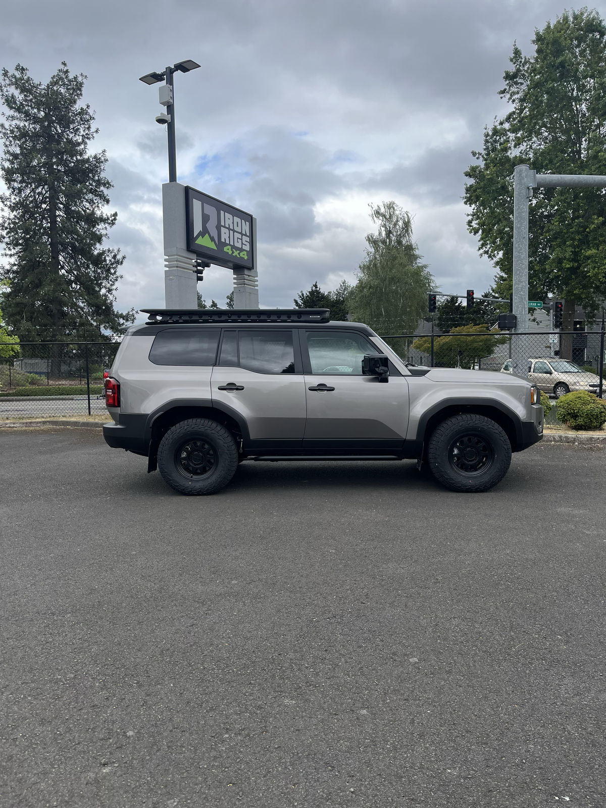

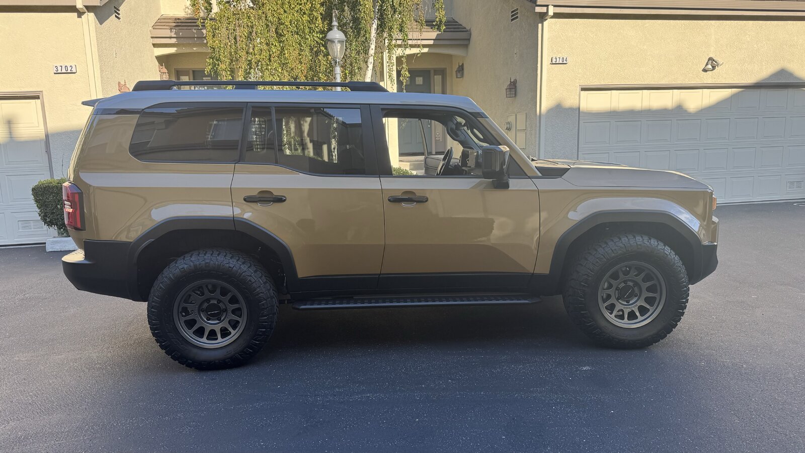

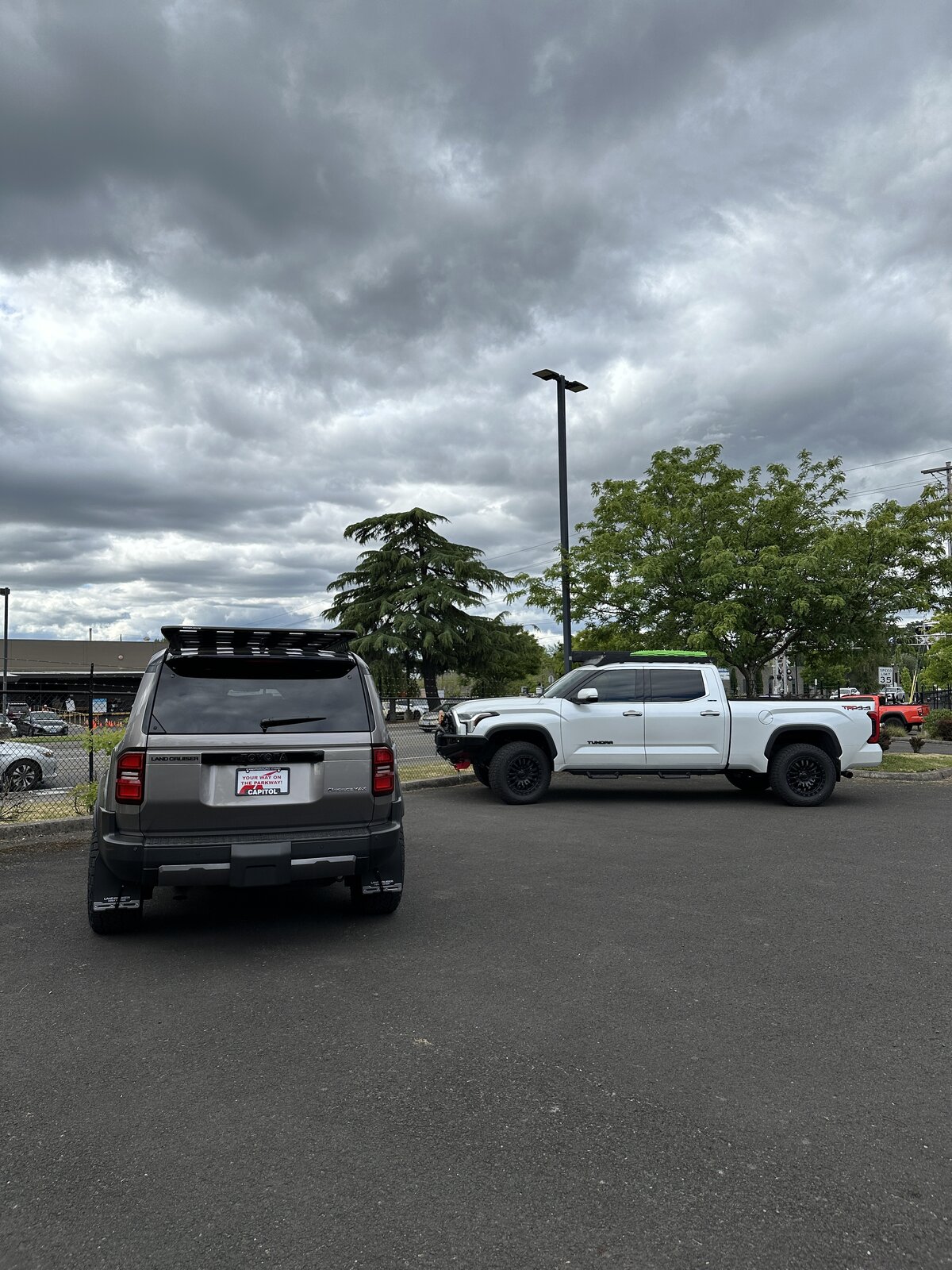

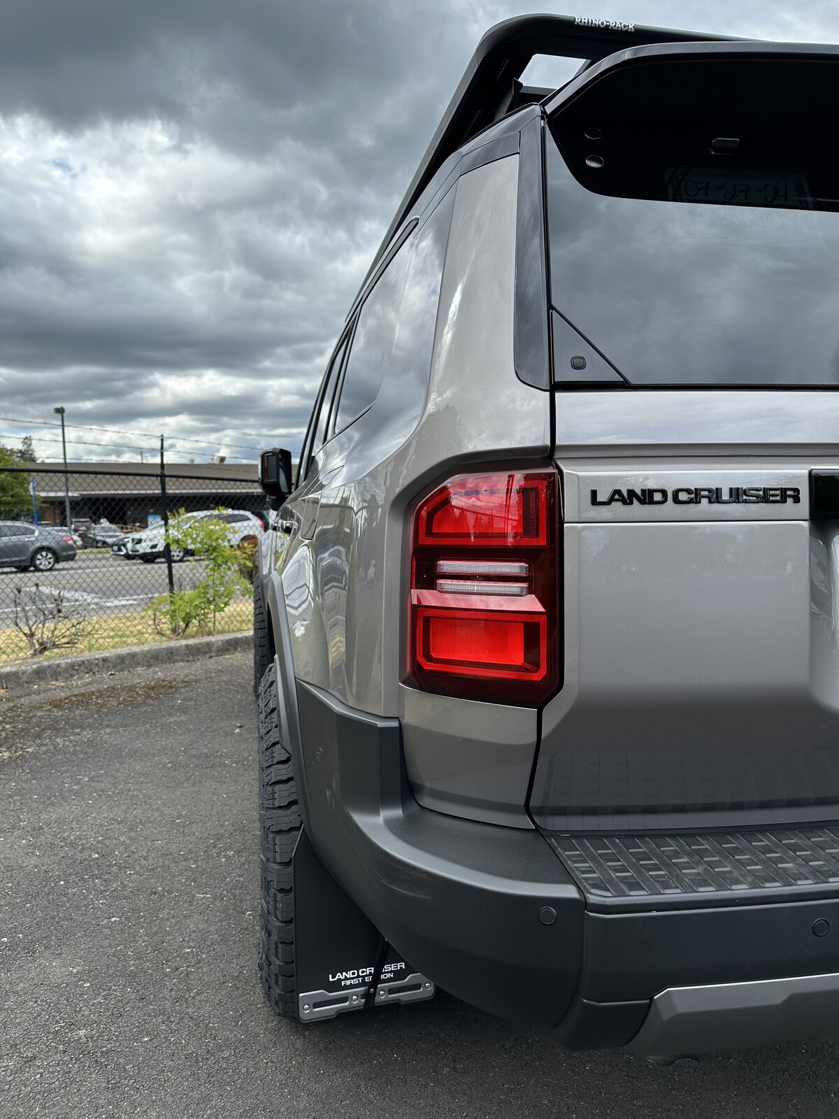

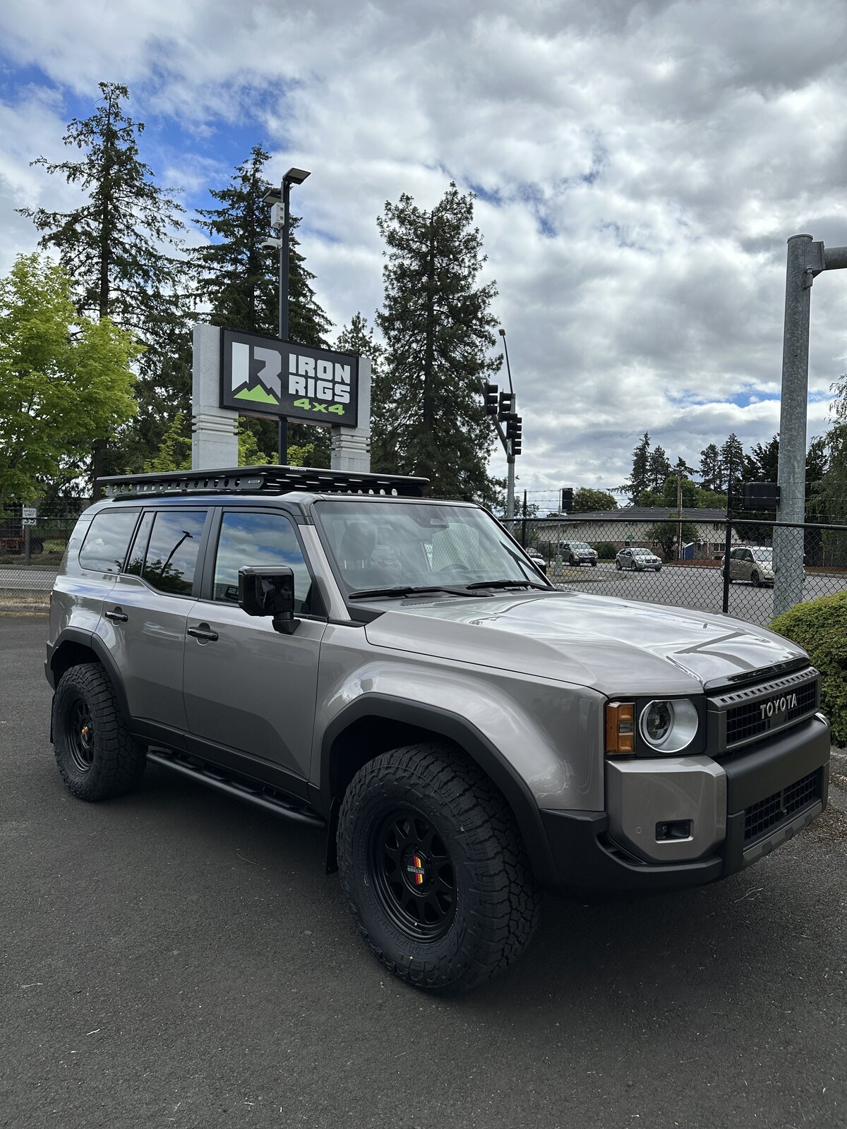

285/70/R17 Falken Wildpeak A/TW4s on Method Race Wheels MR316, 17x8, +25mm offset, 6x5.5
View attachment 3499View attachment 3500View attachment 3501View attachment 3503
My LC is 1-4 weeks out still and I’ve been working with my dealer on swapping out the 20” “premier” wheels for 17” w/285/70/17. The method mr316 was one option but I chose the 707 instead. I didn’t pull the trigger yet but seeing your pics may push me to do just that.
Is yours still stock (no lift/level kit) and have you had any issues with rubbing? I will be doing off roading and was concerned about tire size being too much.

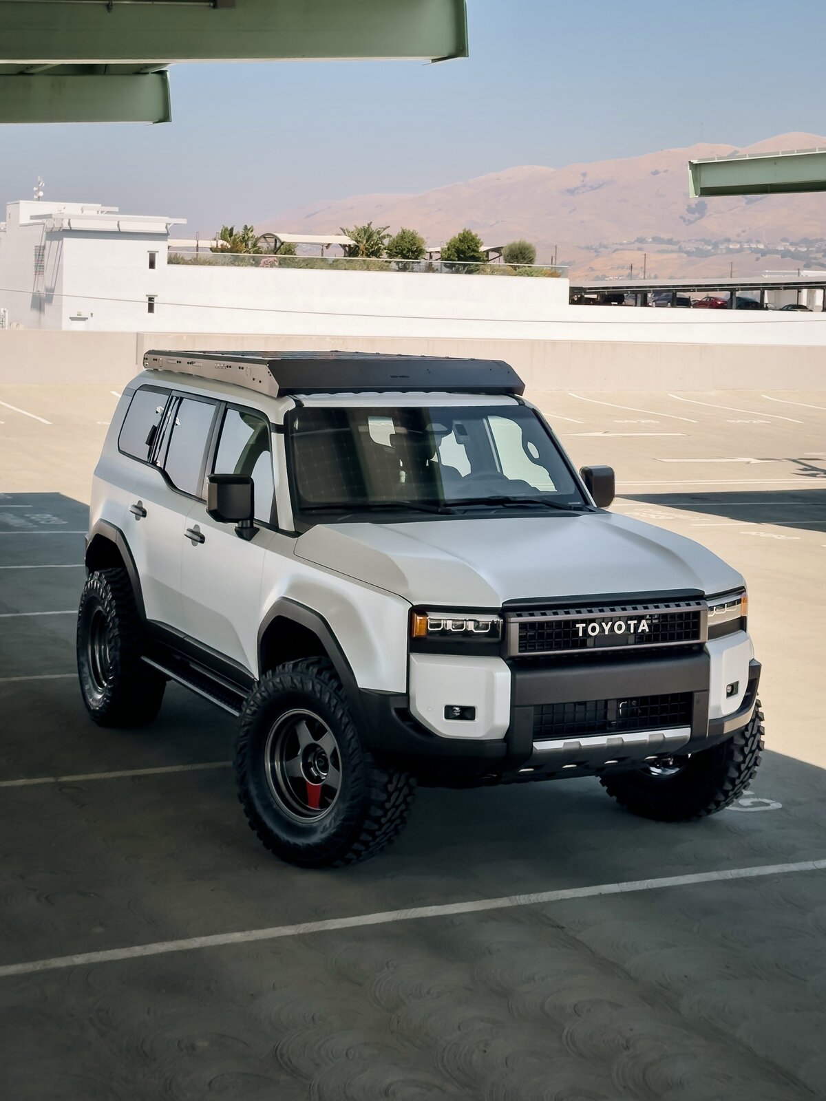

Toytec 1.5” leveler, 18” TRD wheels and 35” Toyos. It’s close but no rubbing.

285/75R18
This with the Toyo leveling kit you used is identical setup to that video on how to fit 35"on. And I really like this look. No offset and looks solid.
