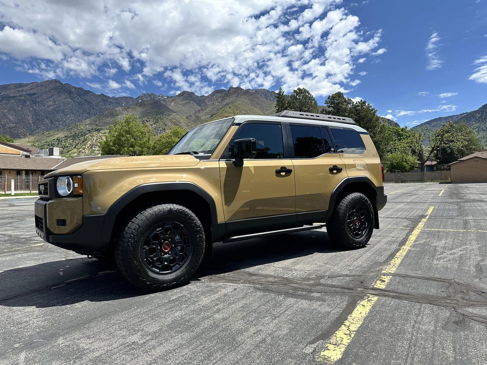

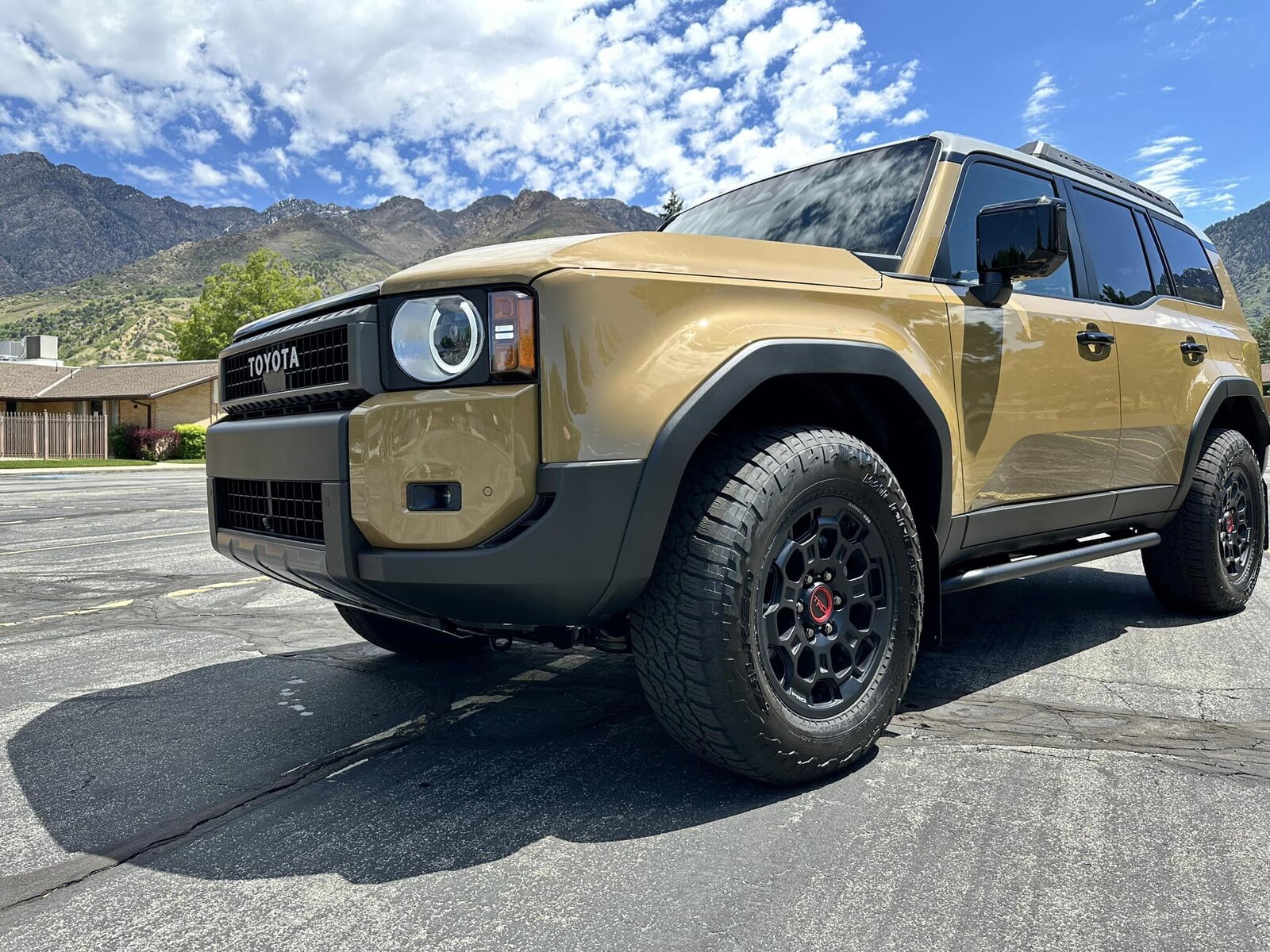

Icon Alloy Recon SLX 18x9 +40 offset

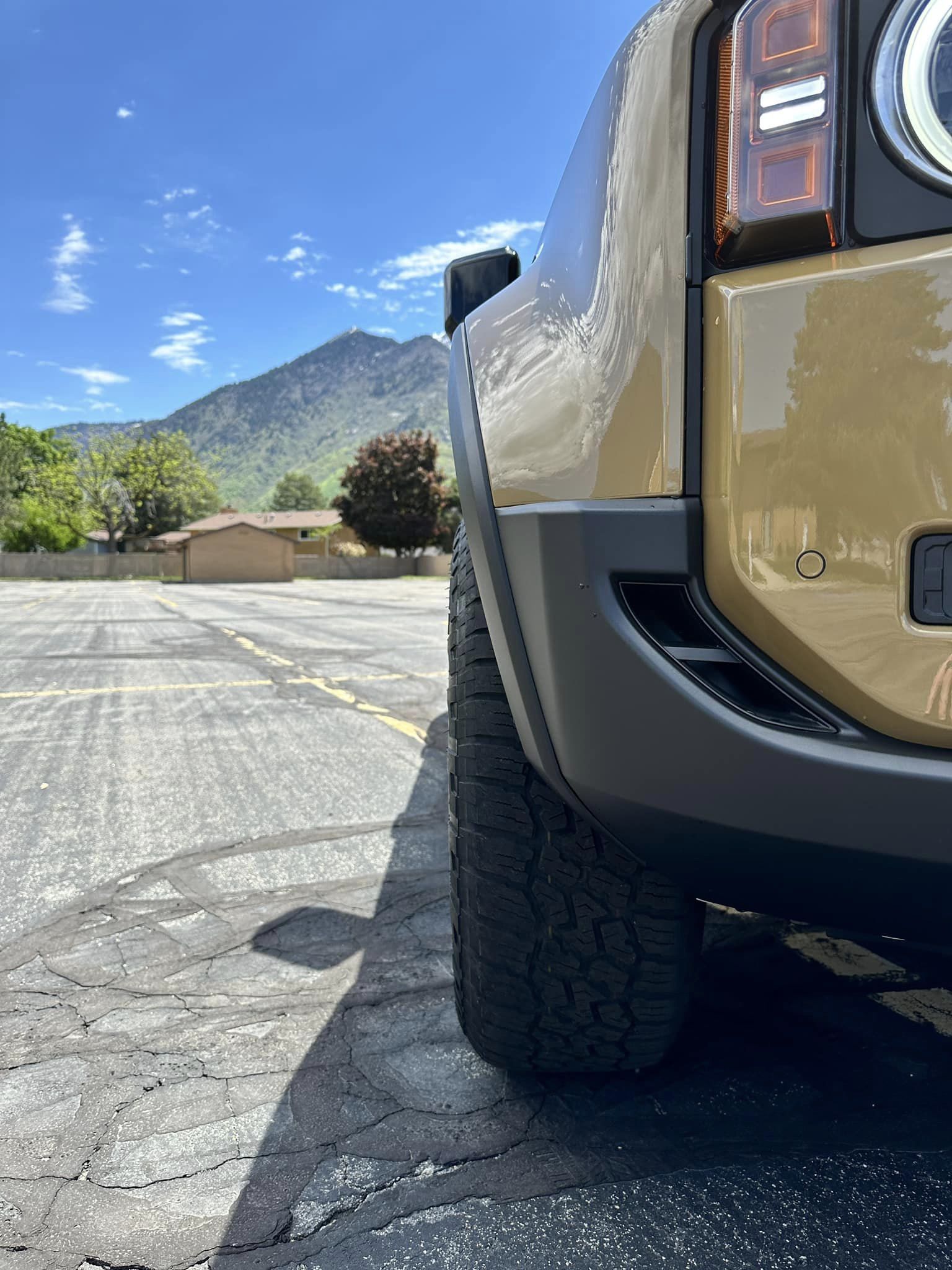

Falken Wildpeak AT4W: load range C, 285/70/r18 33.7 or Falken claims 34โ€
I took it over into the desert by my house and tried to get some rub but never felt or heard anything. Here are some quick photos I grabbed but I would say, success!
