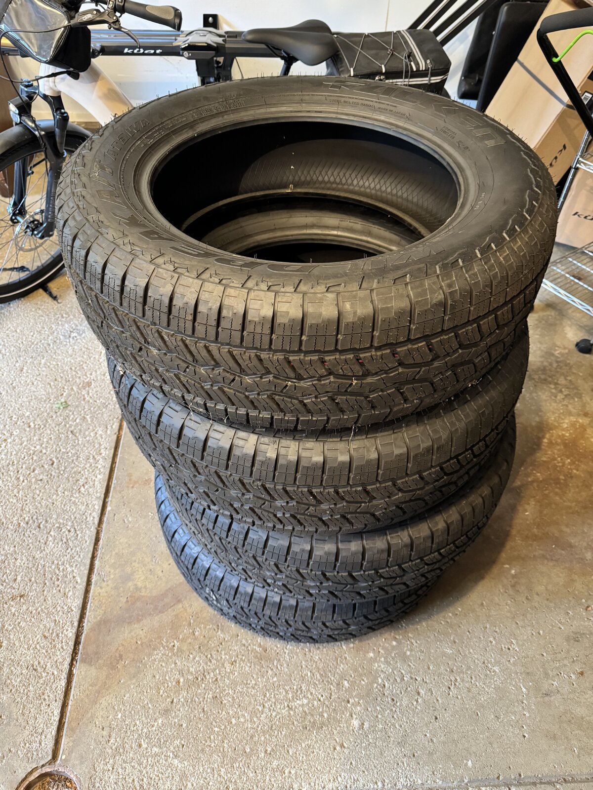

Extra ready for the LC to arrive today
I feel like this is going to be a very popular choice for LC owners. Iโ€™m putting them on my LC, I love them on my TRD Pro Tundra so grabbed a set with spare.

Current status: 8 new tires, 4 wheels, 0 Land Cruisers
Well, at least you have your ebike to get around on until it gets here. ;)
Unless I'm mistaken, that is a Specialized Vado in the background.
good eye ... that's mom's, it's a Como ... my Vado is nearby :)
btw, the IGH is an awesome setup
