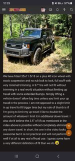

I believe Dissent fit 35x11.5 with no rubbing.
They had to cut a substantial portion of the front bumper to make them fit.
33s should be fine without a lift.
Pretty sure the cutting was for when they put on the 38s.
Edit: I guess it was minimal trimming. Guessing that means just removing the front fairings in front of the tires and trimming a tiny bit. None-the-less it was still trimming and not 100% stock.

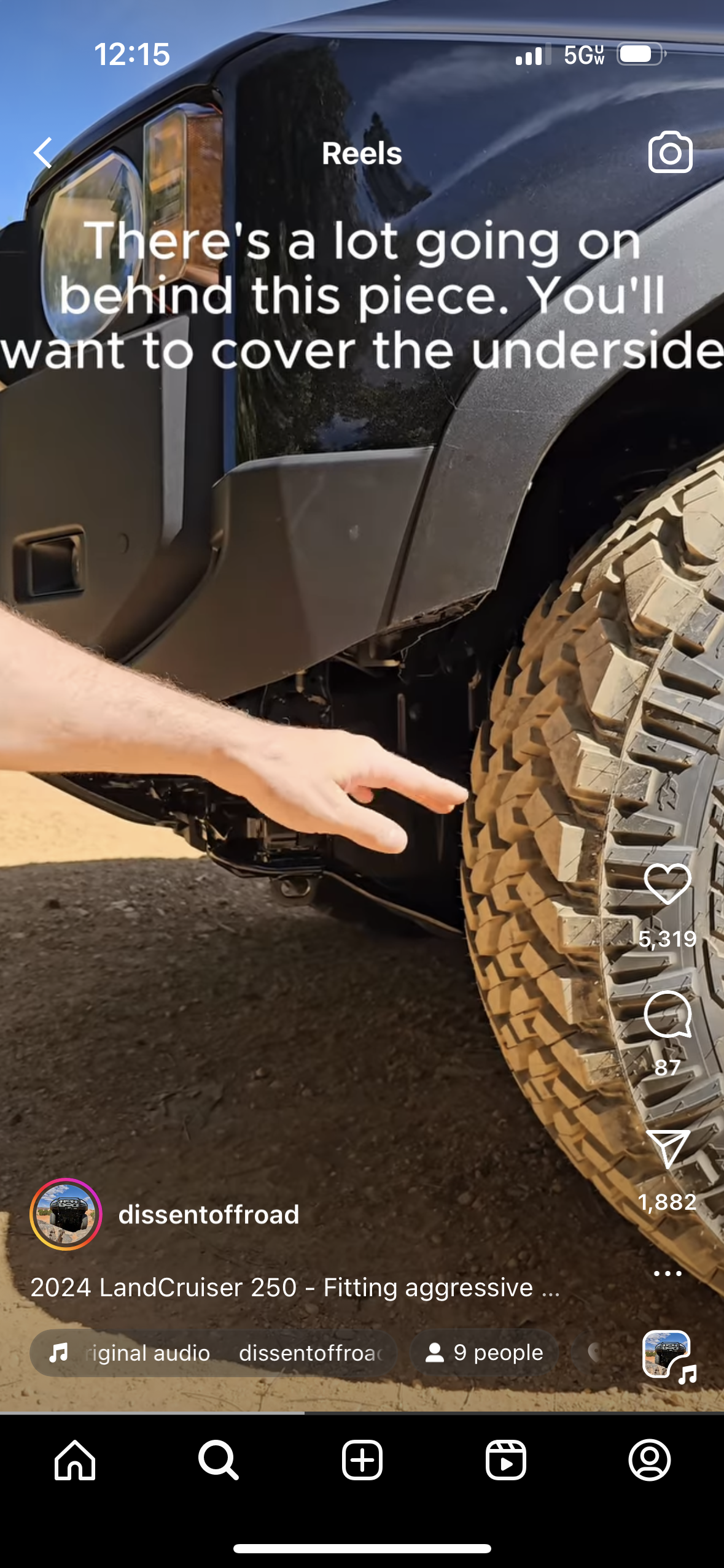

Their 35s video has some pretty aggressive bumper cuts.

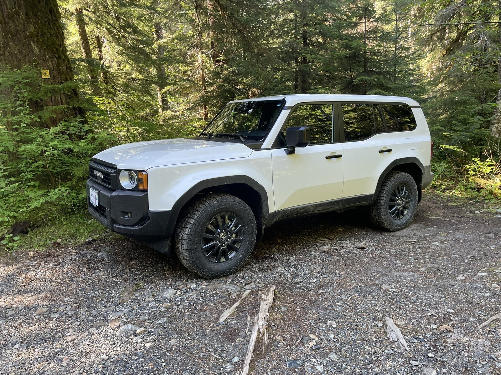

Here it is
Icon Alloy Recon SLX 18x9 +40 offset
Falken Wildpeak AT4W: load range C, 285/70/r18 33.7 or Falken claims 34โ€
I took it over into the desert by my house and tried to get some rub but never felt or heard anything. Here are some quick photos I grabbed but I would say, success!
Did you buy the same size for the spare and did it fit underneath in the spare compartment area?
Fits on mine, barely. A couple mm to spare. I pushed it rearward where it is touching the hitch to gain a little clearance near the diff. Itโ€™s close. Donโ€™t think I could fit any larger in the spare.
BFG KO3 275/70R18 @ ~ 33 psi.
Oh wait, you fit your 34" tire in the spare area?? Toyota techs advised me not to put a 33" under there.
