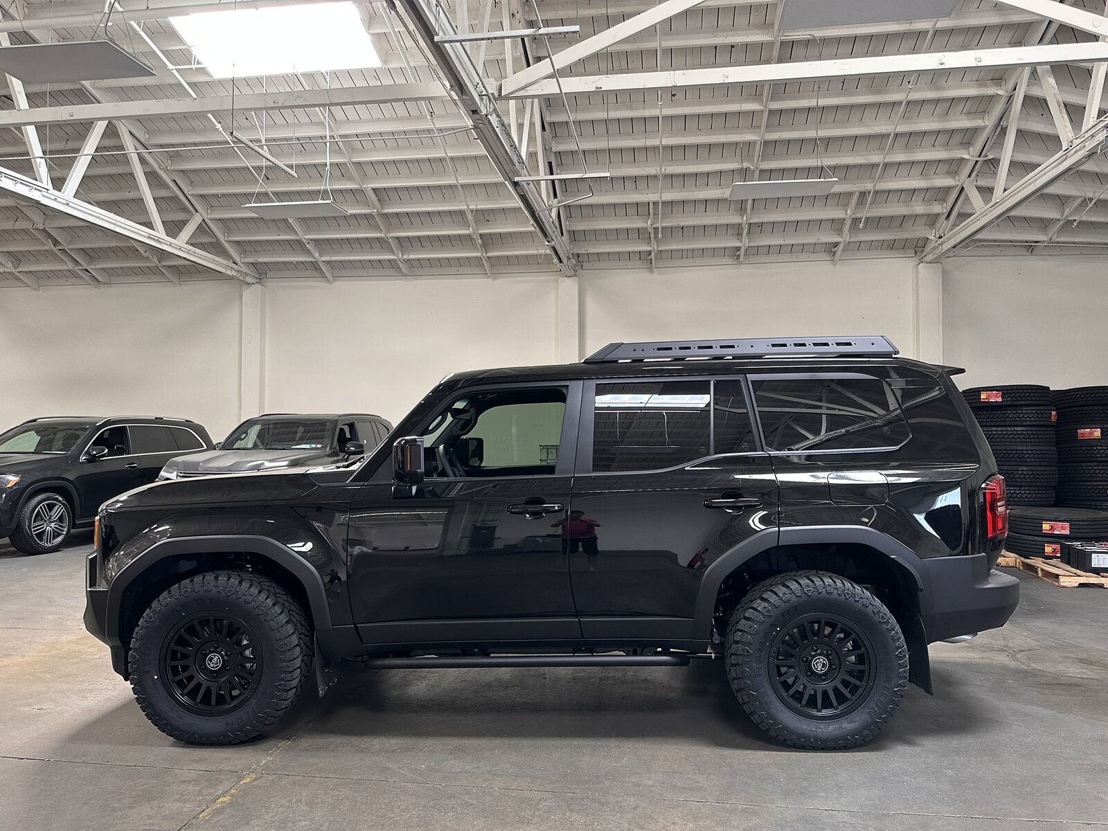

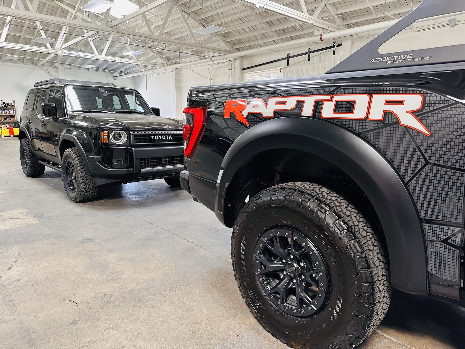

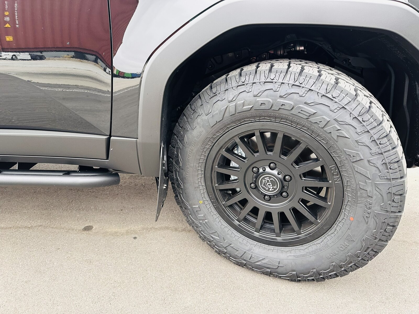

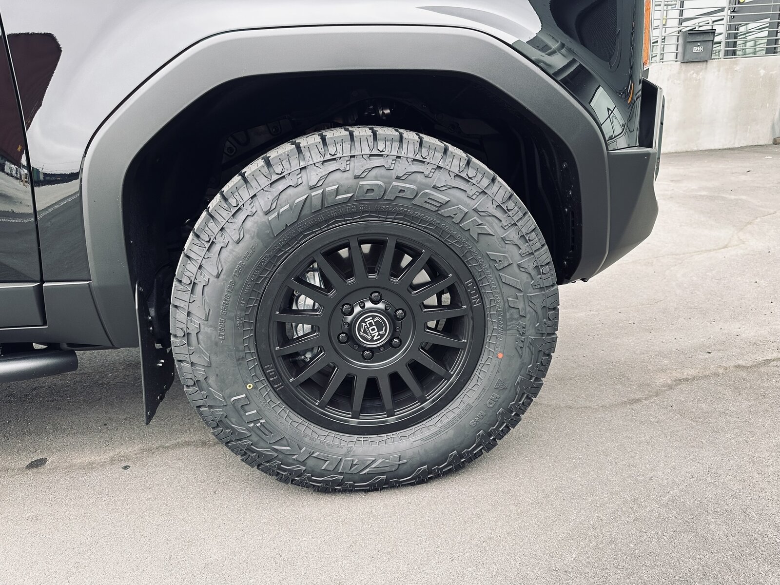

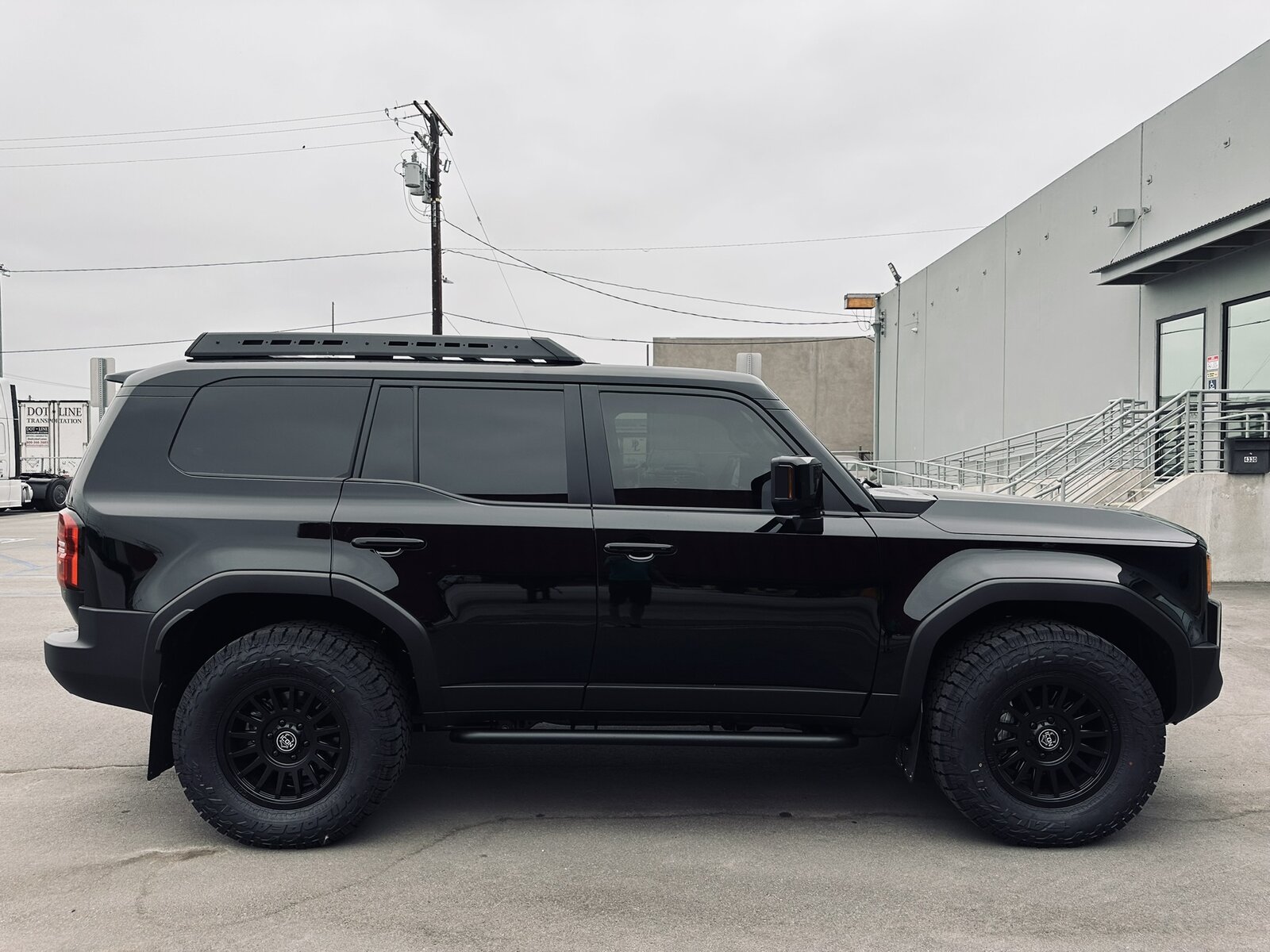

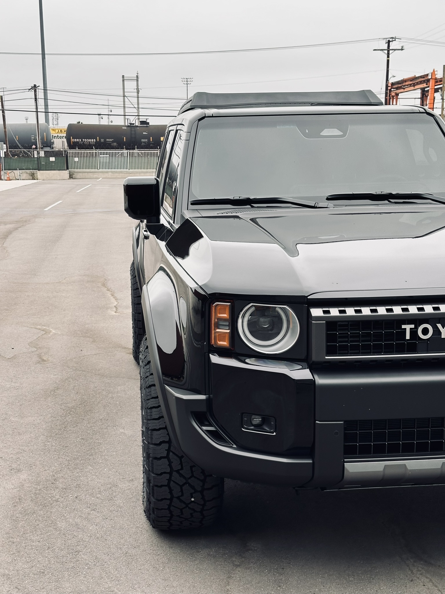

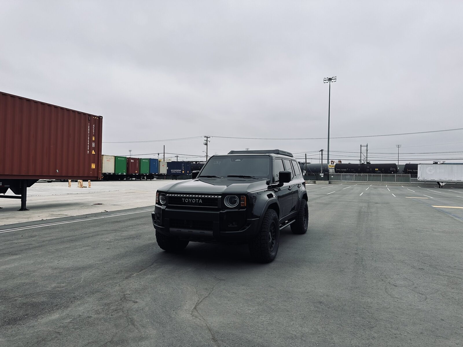

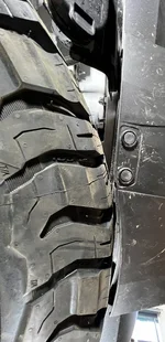

LC on 34s
Wheel: Icon Recon SLX ET 40
Tire: Falken Wildpeak AT4W, LT305 / 65 / 18
Pressure: 32 PSI
-OEM Suspension, No lift
-Barely made it with no rub, may need to remove that wheel plate if going offroad for additional clearance.
-MPG, you don't wanna know
That looks like it will be a problem with min. Articulation of suspension .
No room to clean mud /ice/snow between tires and fender wells .
I wonder what this will do to warranty especially transmission.
Possible overheating from 2 inches over stock diameter

Fits on mine, barely. A couple mm to spare. I pushed it rearward where it is touching the hitch to gain a little clearance near the diff. It’s close. Don’t think I could fit any larger in the spare.
BFG KO3 275/70R18 @ ~ 33 psi.

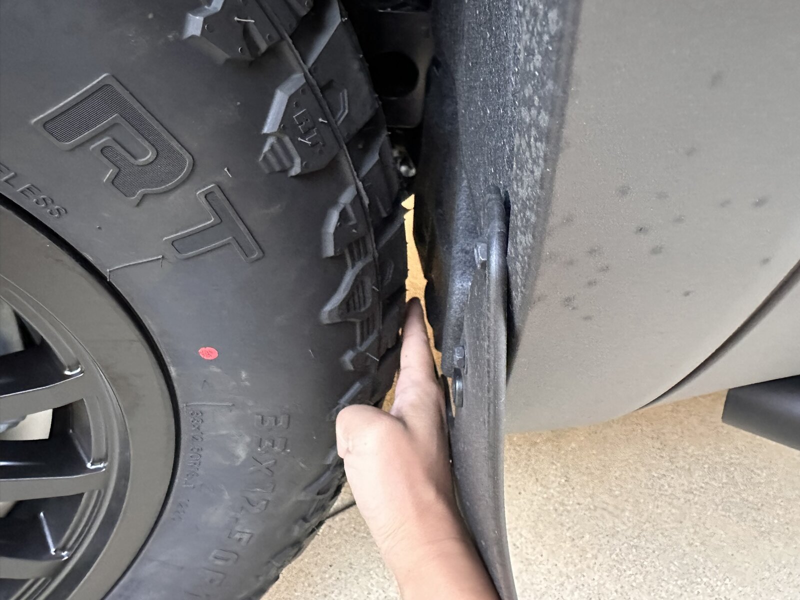

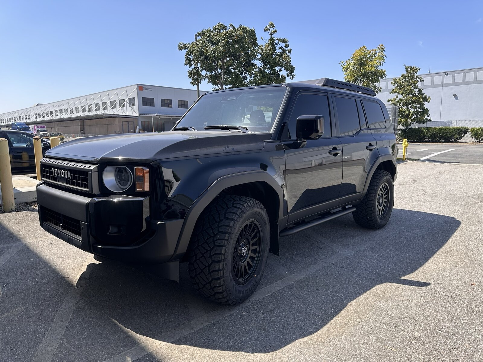

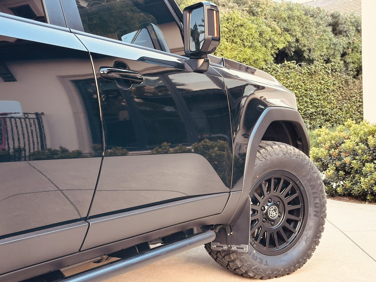

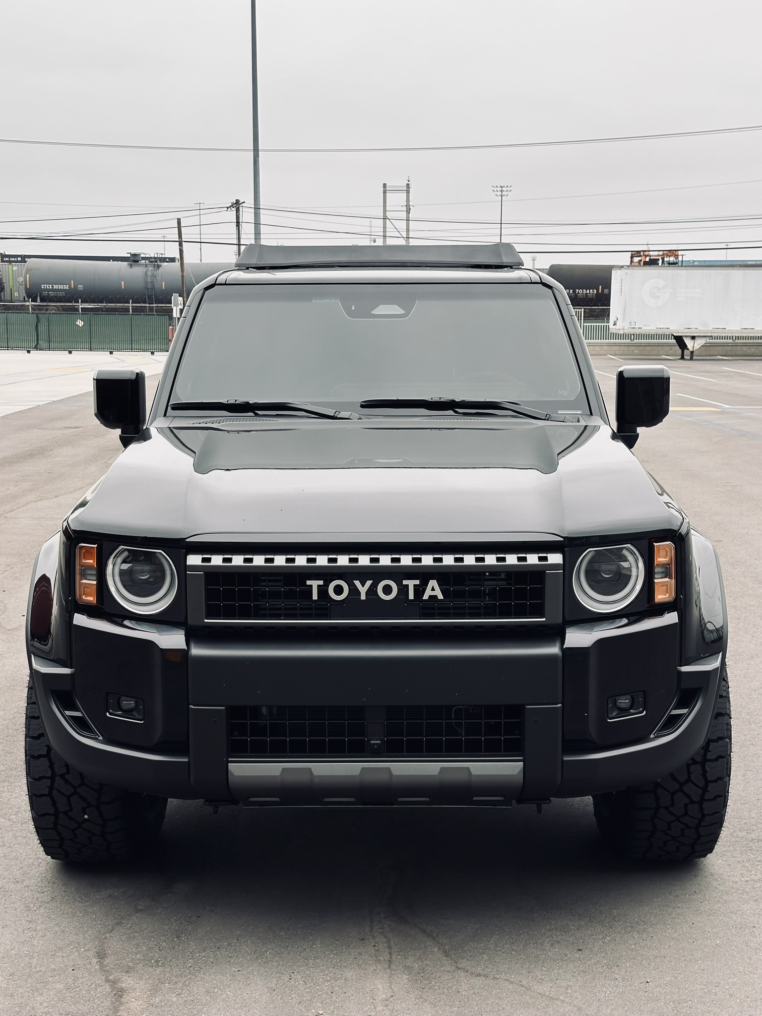

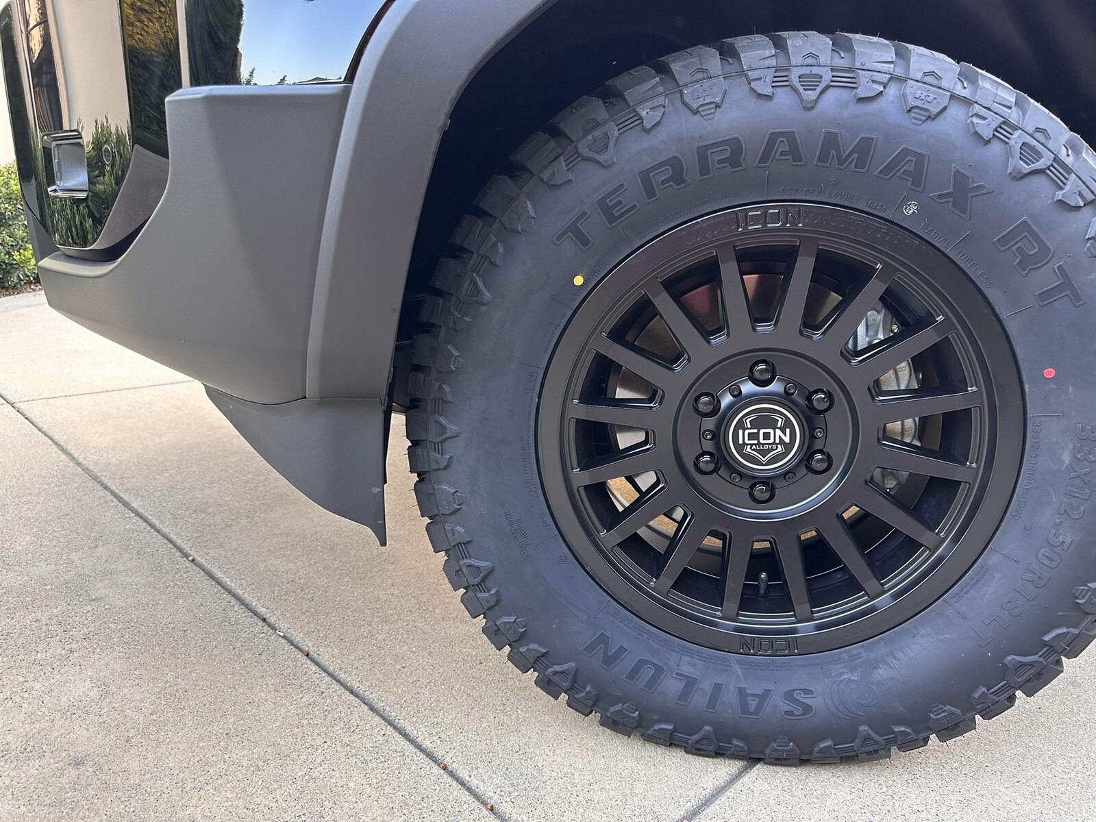

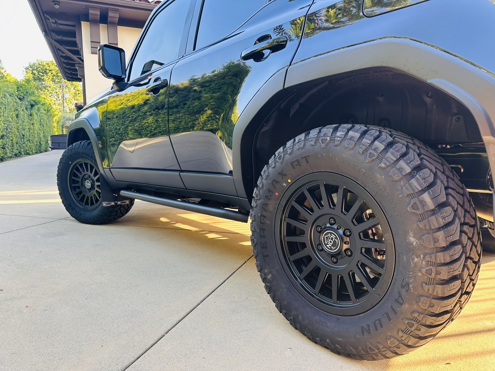

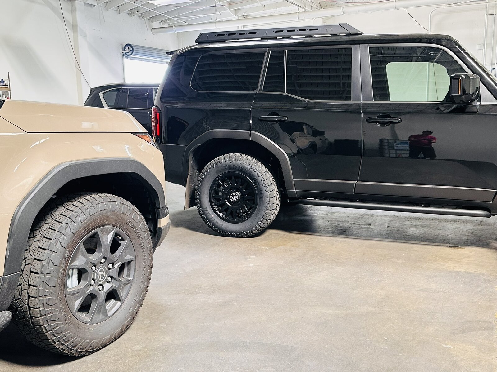

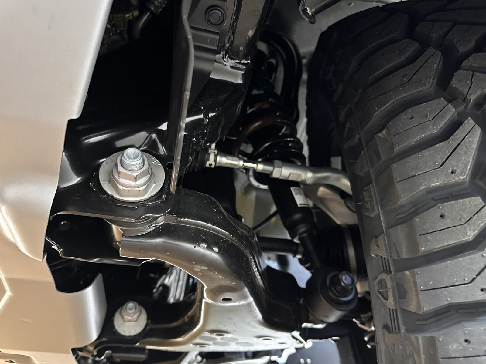

It should, and I would recommend 285 on the LC. Less on weight, less drag. I’m just a wide tire lover all my life, unfortunately.

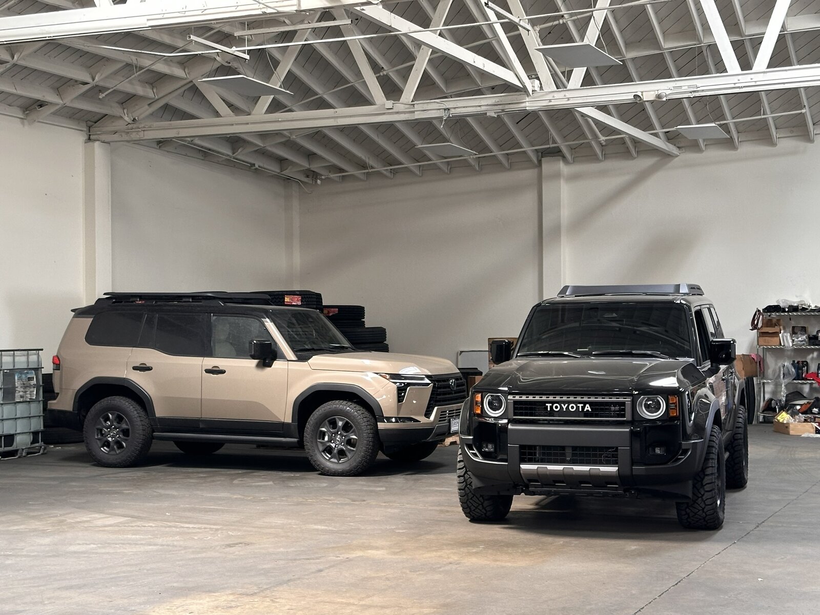

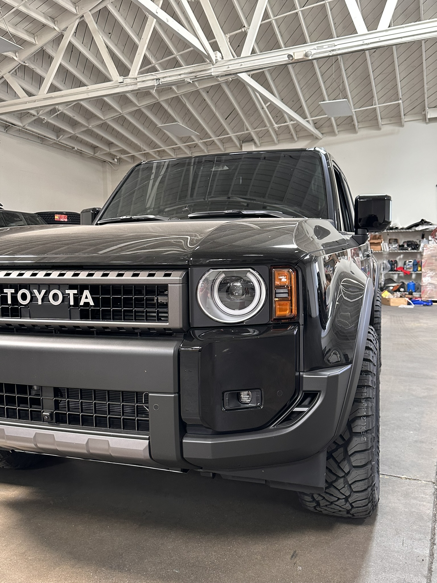

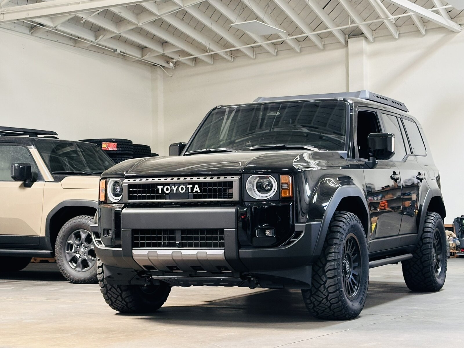

Here are some more photos. Clearance wise, I was able to fit my hand into front & rear at full lock, either direction. At ET40 offset, fat tire pokes out just a bit (really depending on your angle), to my exact liking. Looks so mean from distance. City driving, I'm happy with this Sailun tire, road noise wise close to KO2. Aiming to go offroad in a week or two.
What do you guys think of the wheel style from ICON? I do like it, but I would love it if it was bronze color. Thoughts?
View attachment 2012View attachment 2011View attachment 2010View attachment 2009View attachment 2008View attachment 2007View attachment 2006View attachment 2005View attachment 2004View attachment 2003View attachment 2002View attachment 2001
