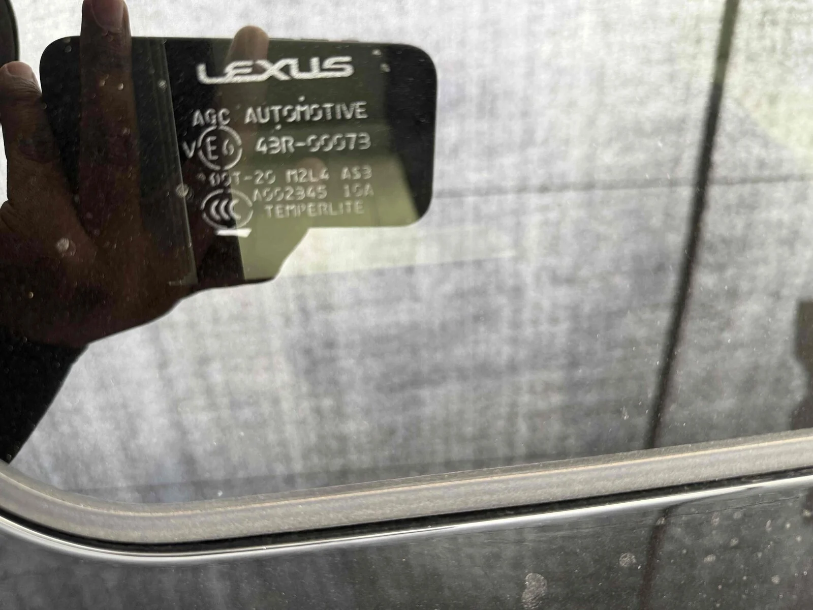

Got these installed today - noticeable difference in quietness.

Windows feel like biggest improvement in interior sound. The doors is a nice improvement inside but probably nicer in the getting rid of that “tinny” sound
