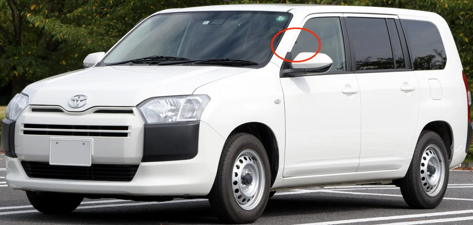

It’s the same part for all the Toyota and Lexus vehicles that use that kind of clip. I saw it was even listed as a part for the Toyota Probox, which is a rather utilitarian little thing that certainly wouldn’t have any kind of acoustic side glass.
Yes, do try it and let us know what you think. I suspect it won’t help much—because what I hear is the wind beyond the glass, not the glass itself moving—but it is indeed a cheap experiment.
When you drive a vehicle at high speed with the front window(s) slightly open, they will try and pull away from the vehicle due to vacuum, to the point where you might not be able to close the window until you slow down.
The clips just guide the window back into the window track. If the window was rectangle, it would remain in the track the entire time and the clips would serve no purpose.

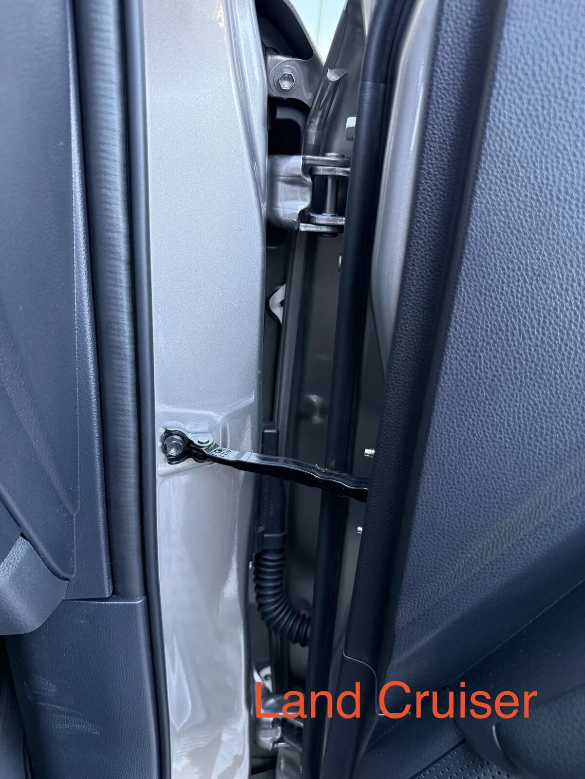

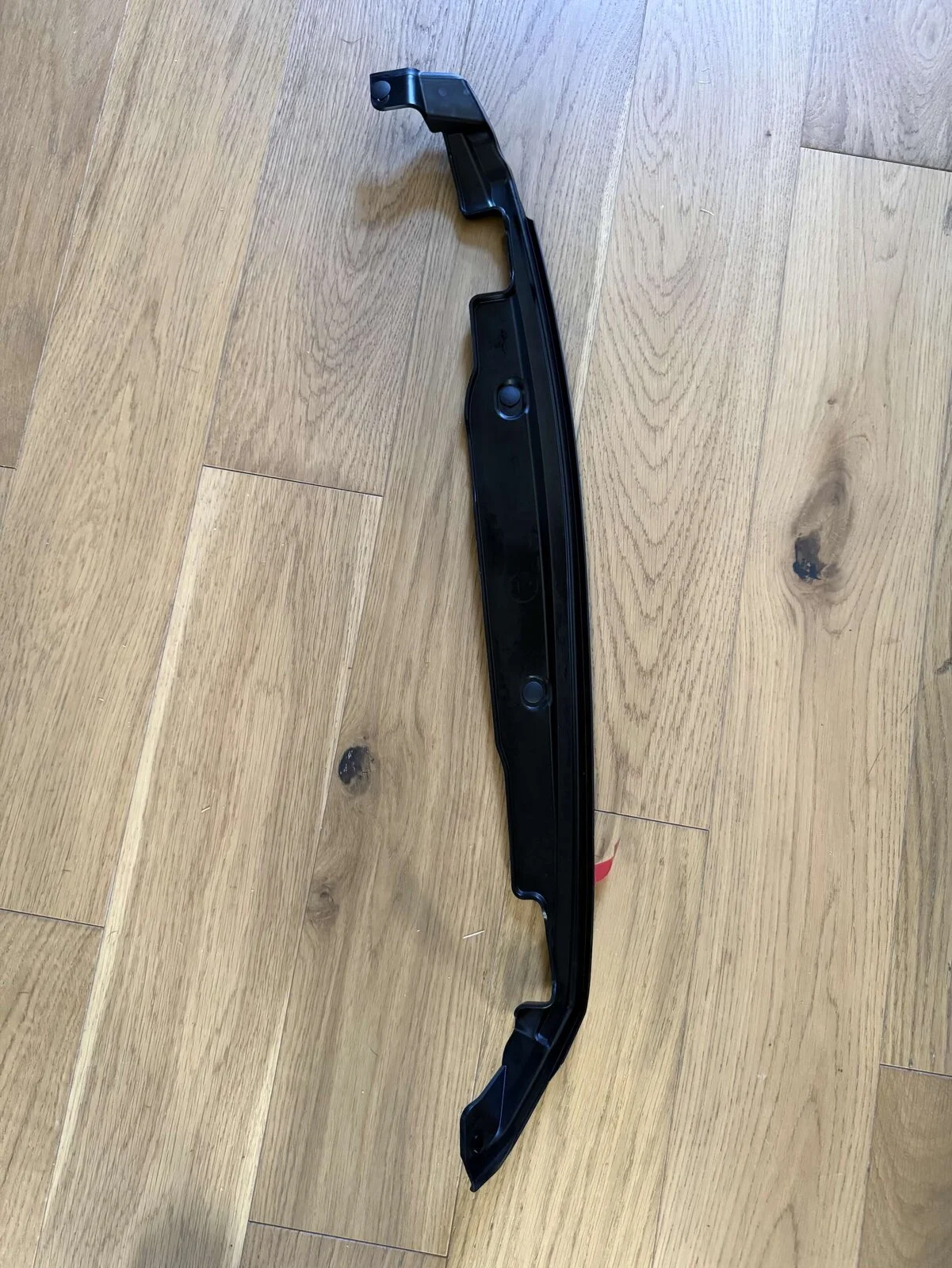

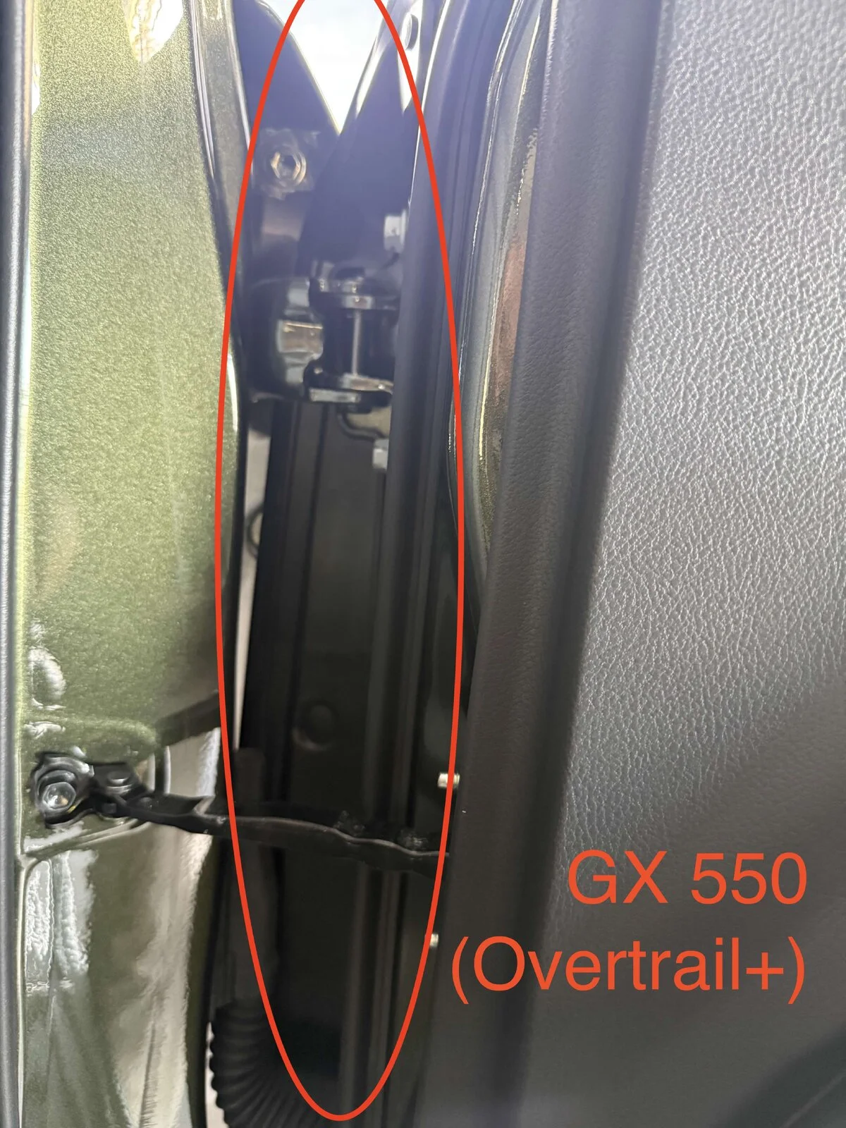

Another difference between the LC and GX with the acoustic package ("NV PACKAGE HIGH GRADE") is a set of seals that go around the leading edges of the front doors, around the hinges. The LC does not have these. They seal up the gap in the forward part of the door when it is closed, and I'm sure that cuts down on wind noise, too.
View attachment 57912 View attachment 57913 View attachment 57915
Part No.Part Desc.Qty.Price
6786660020Door Seal, Left Front1$62.50
6786560020Door Seal, Right Front1$61.29
I have both of these, for left and right, but they are extremely difficult to install, even after unbolting the door checks to get a little extra room. What's more, the LC's door skins lack the middle two holes for these pieces to clip in, and even I draw the line at drilling holes into a brand-new $70K+ car. I haven't figured out how to finagle them into place with the doors installed, so most likely the doors would need to come off to place them. And they'd have to rely upon double-sided tape in the middle, since the holes for the middle two clips are missing on the LC. The upper and lower holes are there, though, and are covered by rubber grommets in the LC.
