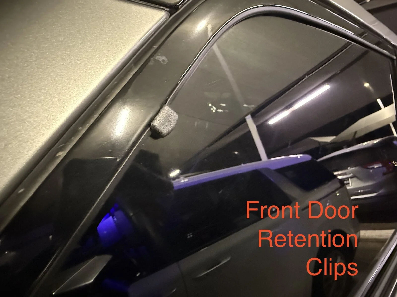

Great write up. I do wonder what the purpose of those clips is. If they’re pushing the window tighter against the seals, could they possibly reduce some noise intrusion on their own?
Possibly. It did seem even quieter when I took it out a couple of hours ago, after the retention clips were installed.
I wonder installing the clips to non-acoustic window would helps with noise. I doubt it would help with wind noise, but it may improve window rattling.
Possibly.

Possibly.
I will install the clip on with regular windows and report. For only ~$5, it is a cheap test.
I actually found the same part in Toyota (same part number but with a "-"). Toyota part number for the clip is 62367-60030 for anyone interested.
It’s the same part for all the Toyota and Lexus vehicles that use that kind of clip. I saw it was even listed as a part for the Toyota Probox, which is a rather utilitarian little thing that certainly wouldn’t have any kind of acoustic side glass.
Yes, do try it and let us know what you think. I suspect it won’t help much—because what I hear is the wind beyond the glass, not the glass itself moving—but it is indeed a cheap experiment.

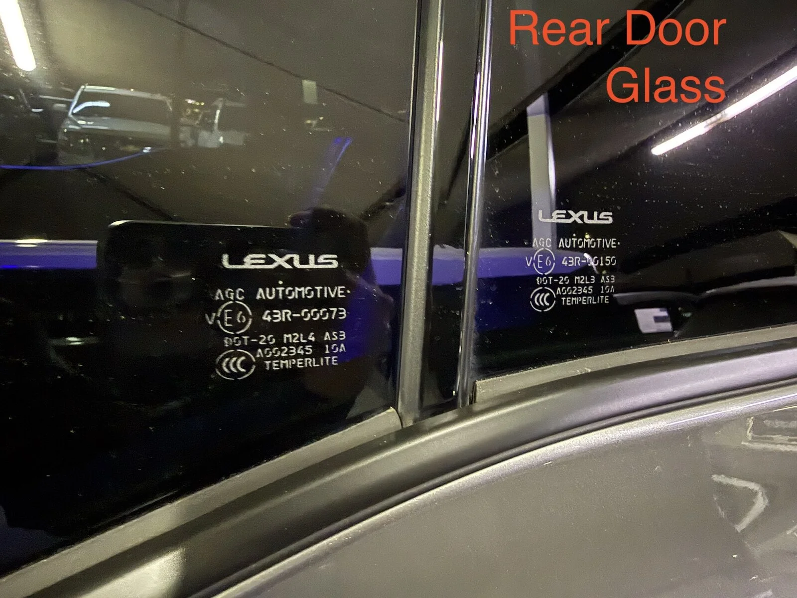

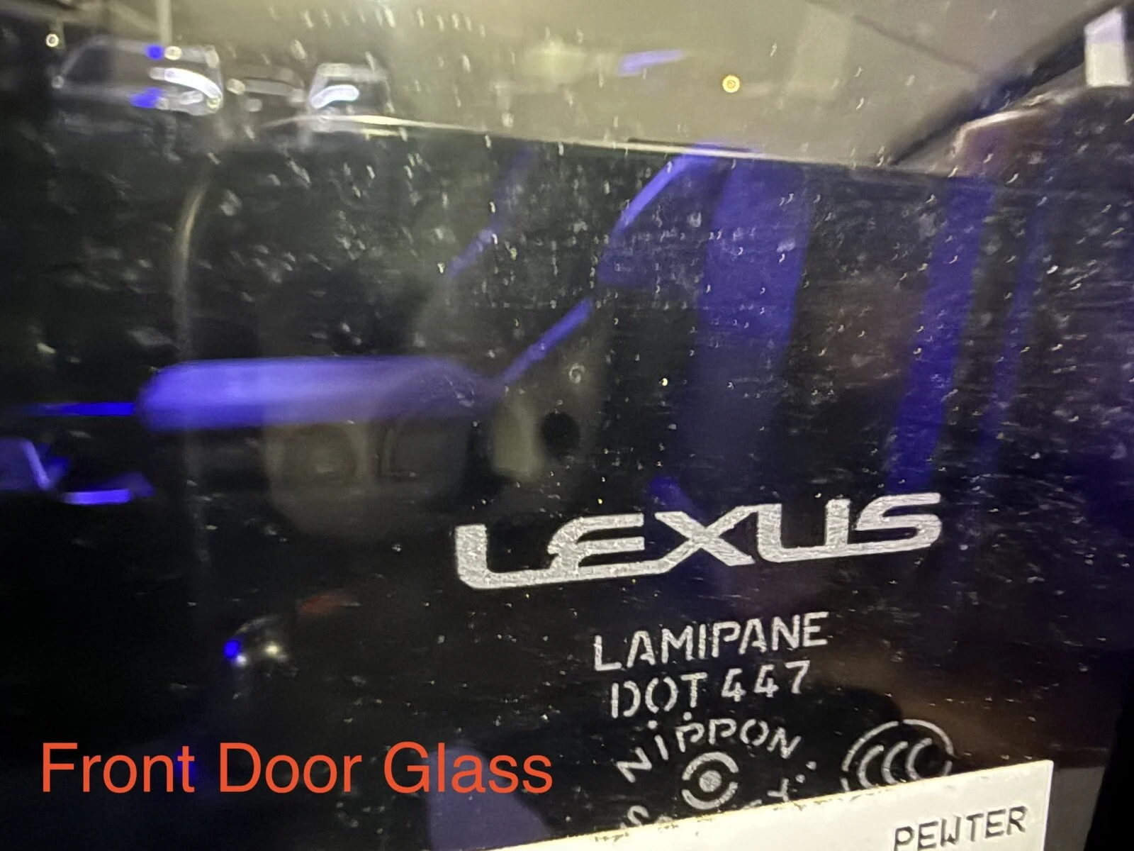

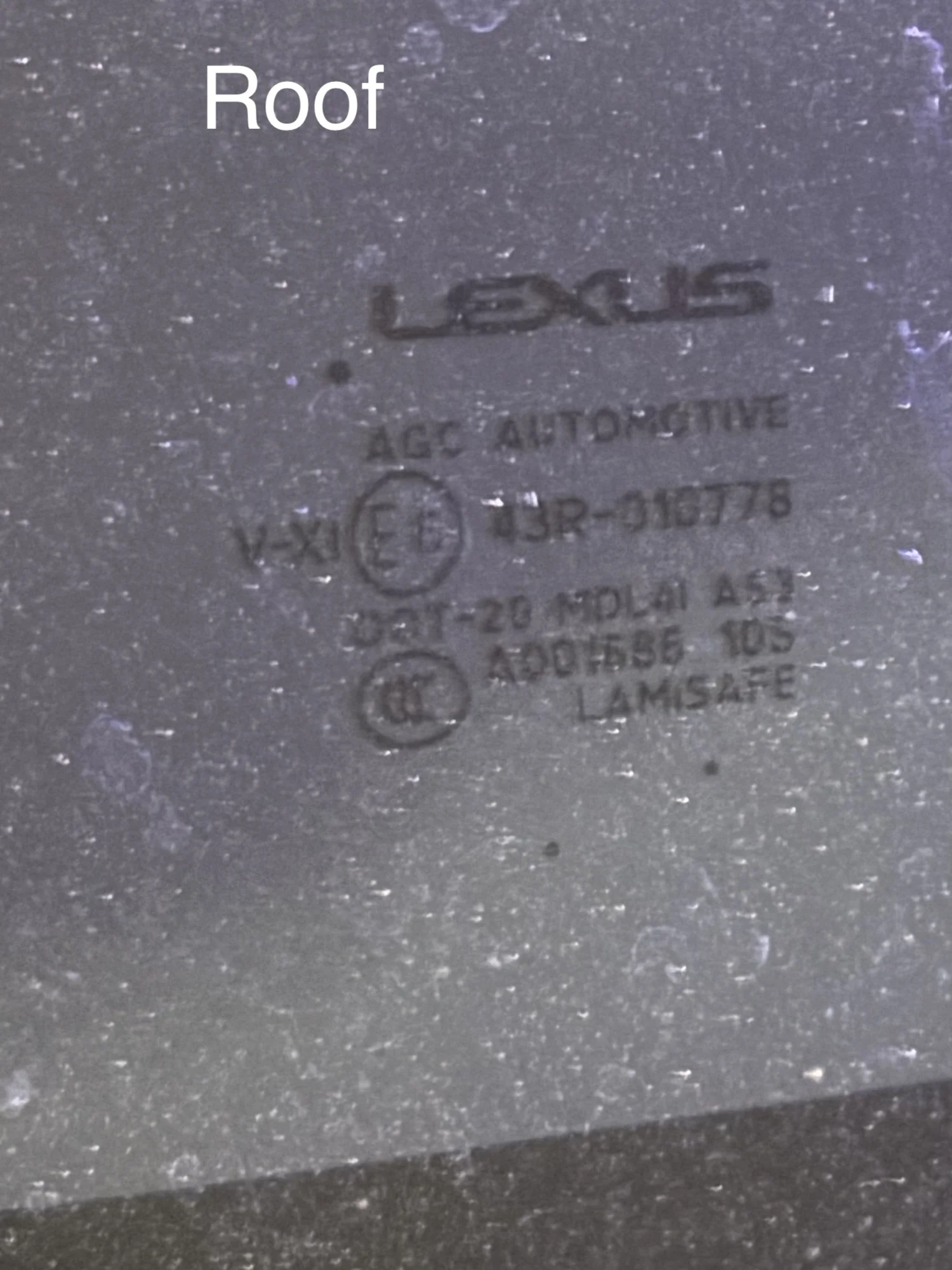

To make a long story short, I was one of the many folks who was pretty disappointed with the LC's noise at highway speeds. So I pored over the GX 550's catalog to see what was different, and the biggest thing was of course the acoustic (aka laminated or double-pane) front door glass on most versions of the GX, in fact all trims other than the Base and Overtrail. The Land Cruiser does not offer acoustic front door glass on any trim. Oddly, the 4Runner does have acoustic front door glass, for Limited and Platinum trims. There are other differences, too, and I'll get to those at a later time, but I was surprised at just what was common between the GX w/acoustic glass and LC, door-wise. I figured, minimally, the window regulator/motor and window seal were different, but no. Those part numbers are identical.
The GX does list multiple glass versions for the front door, for versions with and without the acoustic package. All parts dealing with the acoustic package are listed as being for the "NV PACKAGE HIGH GRADE" in the Lexus catalog, and that was how I figured it out. Again, it's not just the front door glass, as Lexus took other measures with seals and sound deadening, but the front glass is a good start. You can readily identify the acoustic glass because it says "LAMIPANE", instead of "TEMPERLITE" in the bottom right corner, and of course looking at the edge of the glass, you can see it's two panes sandwiched together.
I must also stress that the GX, like most vehicles that aren't the price of a Rolls-Royce, only has acoustic glass on the front doors, windshield and sunroof. Possibly not even the windshield and pano sunroof, which have to be laminated anyway. The rear door, rear quarter panel and liftgate glass is just regular single-pane tempered stuff, identical to what's in the LC in those places other than that the GX's is labeled "Lexus" instead of "Toyota". But even my prior car, a Range Rover Autobiography costing $140K when new, didn't have acoustic glass aft of the front doors. I guess it's not necessary, since the wind isn't hitting those areas as fiercely.
I test drove a used 2024 GX 550 Luxury+ last week and confirmed that it was indeed much quieter at highway speeds. I looked at it and confirmed where it had acoustic versus tempered glass. Here's what I discovered:
View attachment 57883 View attachment 57884 View attachment 57885

I also noticed that versions of the GX 550 with acoustic glass, including the one I test drove, had these small little retention clips on the leading edges of the window seals. According to my cursory research, these are to hold the thicker acoustic glass in lateral tension and stop it from rattling.
So I ordered one for each side. Those are:
Part No.Part Desc.QtyUnit Price
6236760030Door Glass Attaching Clips, Left and Right2$5.11

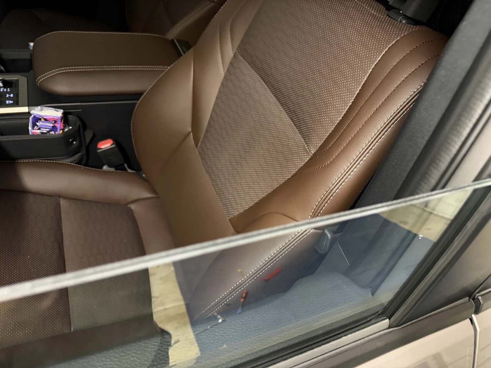

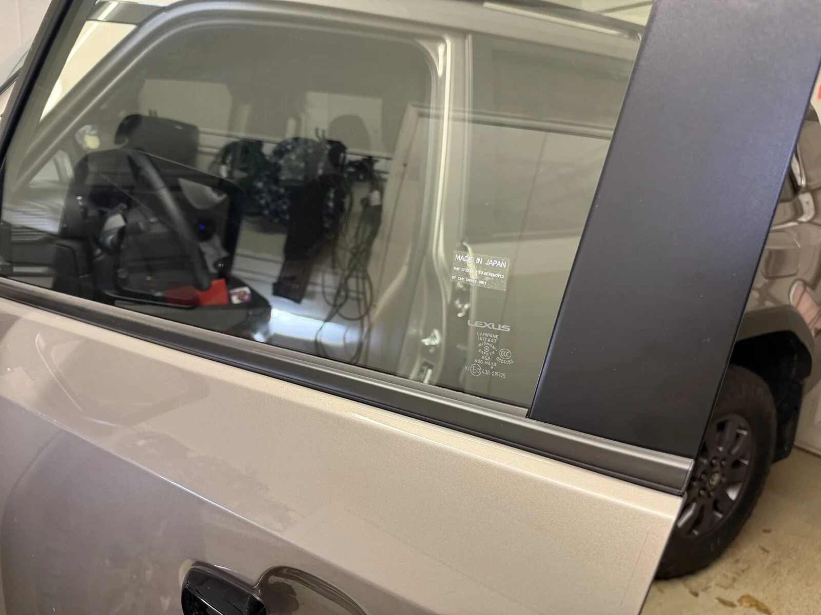

Taking the door apart is a pretty simple process (the J250 is dead-simple to disassemble), and the glass transplant was a success. The mechanism isn't behaving any differently with the slightly thicker glass, nor is it binding on the window seals. So, all is good. I haven't figured out how to attach the retention clips, but the car doesn't seem to need them in the short term.
It's not as quiet as the GX 550 Luxury+ I test-drove last week, but it's a ton quieter than it was with just the tempered glass and is already what I would consider acceptable for livability. Like I said, there are some other differences between the GX w/acoustic package and the LC, like some additional seals and sound deadening. I figure the acoustic front door glass combined with tacosupreme___'s comprehensive and amazing sound deadening tutorial would meet or exceed a GX 550 in terms of overall quietness at higher speeds, so I'll pull the panels back apart and try some of those enhancements later. But this is a good start. I will, of course, have to go and get my front windows tinted all over again, though (grr!!)
View attachment 57887 View attachment 57888
