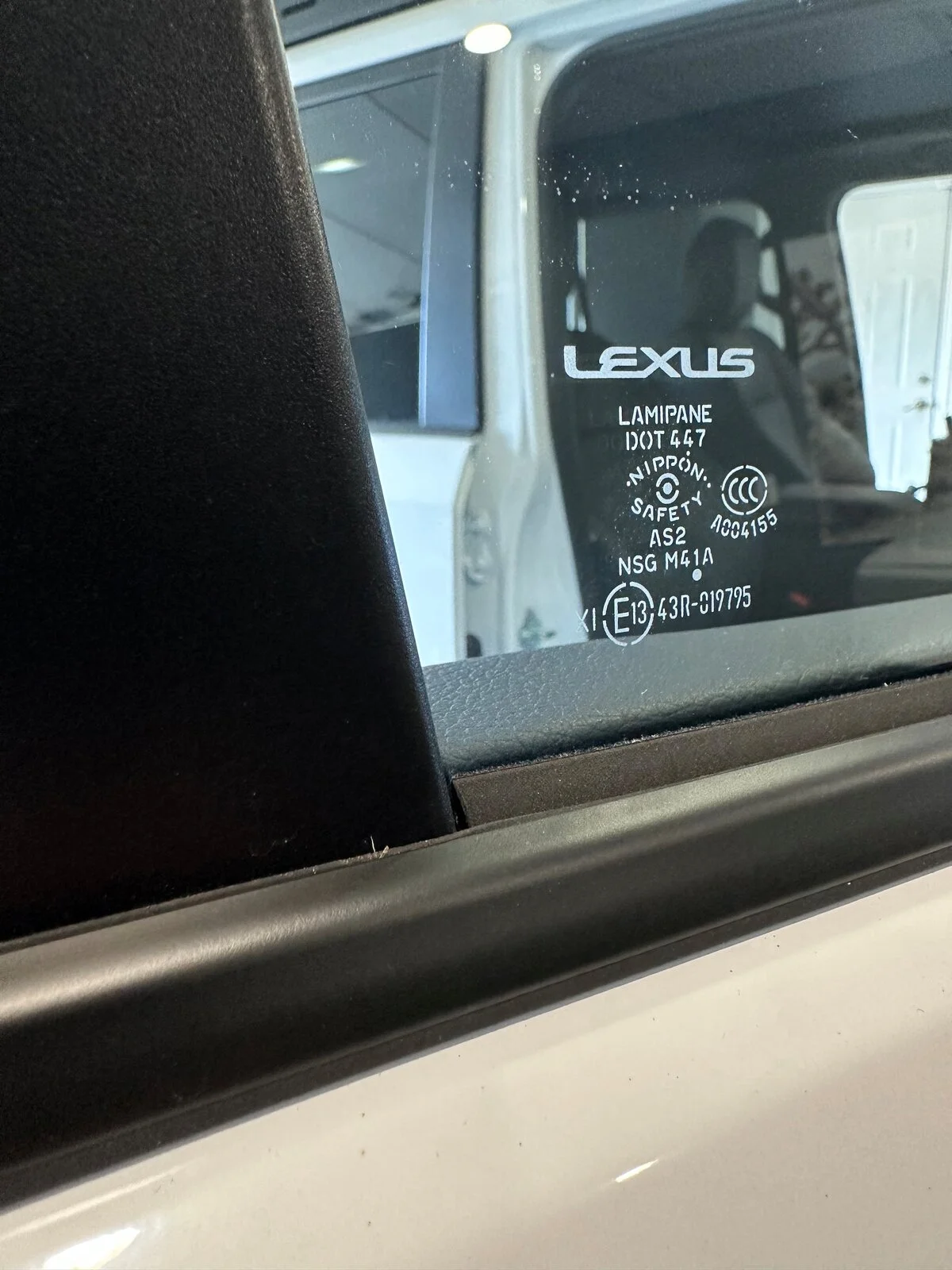

I upgraded my Land Cruiser front side glass to the GX double pane glass over the weekend. Ordered and picked up from my Local Lexus dealer:
6810160870 1 $ 423.47 GLASS SUB-ASSEMBLY, FRONT DOOR, RIGHT
6810260870 1 $ 389.87 GLASS SUB-ASSEMBLY, FRONT DOOR, LEFT
-Install was an easy DIY, agree it is not worth paying the dealer to do this job. The sound deadening video posted by @tacosupreme____ on youtube on how to remove front door panels was helpful and is worth a watch.
-Plastic pry tools are a must.
-Before starting, roll windows down so about 3" of glass is showing.
-The black moisture barrier doesn't need to be fully removed to get to the bolt holding the glass.
The GX glass made a noticeable difference at speed. The wind noise off the mirrors has been reduced drastically to the point it is pretty much gone. It's a worthy upgrade for sure and I'm happy with it. The side view mirror wind noise was one of my biggest complaints with the LC, so it's worth the cost IMO.

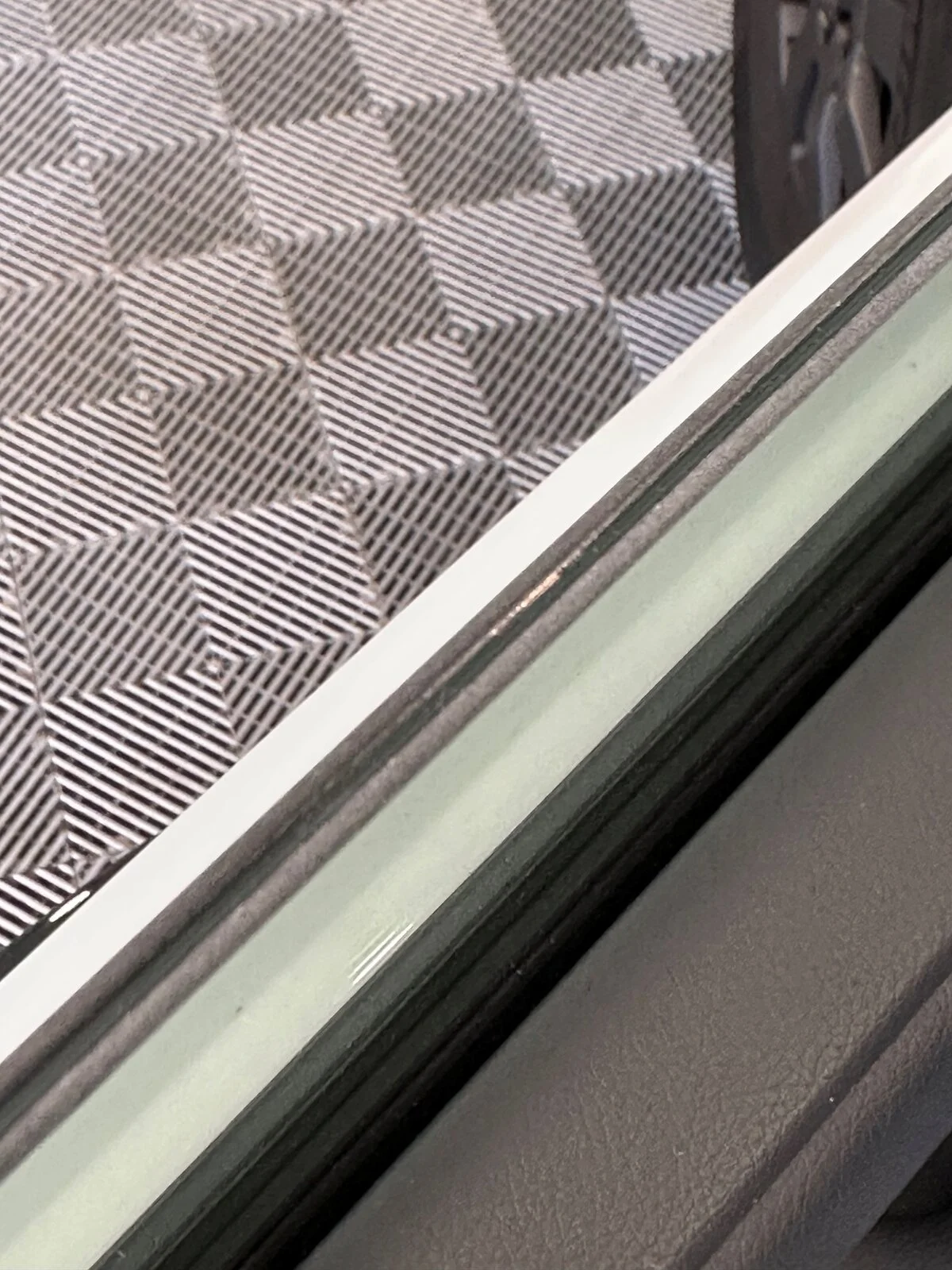

How tight is the tension on the retaining clips? It feels like there should be a screw, otherwise why have the hole in the frame already
I installed my windows and sound deadening, will test the noise before I add the windshield strips
The clips fit pretty tight. I think the hole is just there for alignment (?). When you snap them in the tension from the clip holds them in place in the weatherstripping channel.
So tight. It took a lot of force to snap them in.
