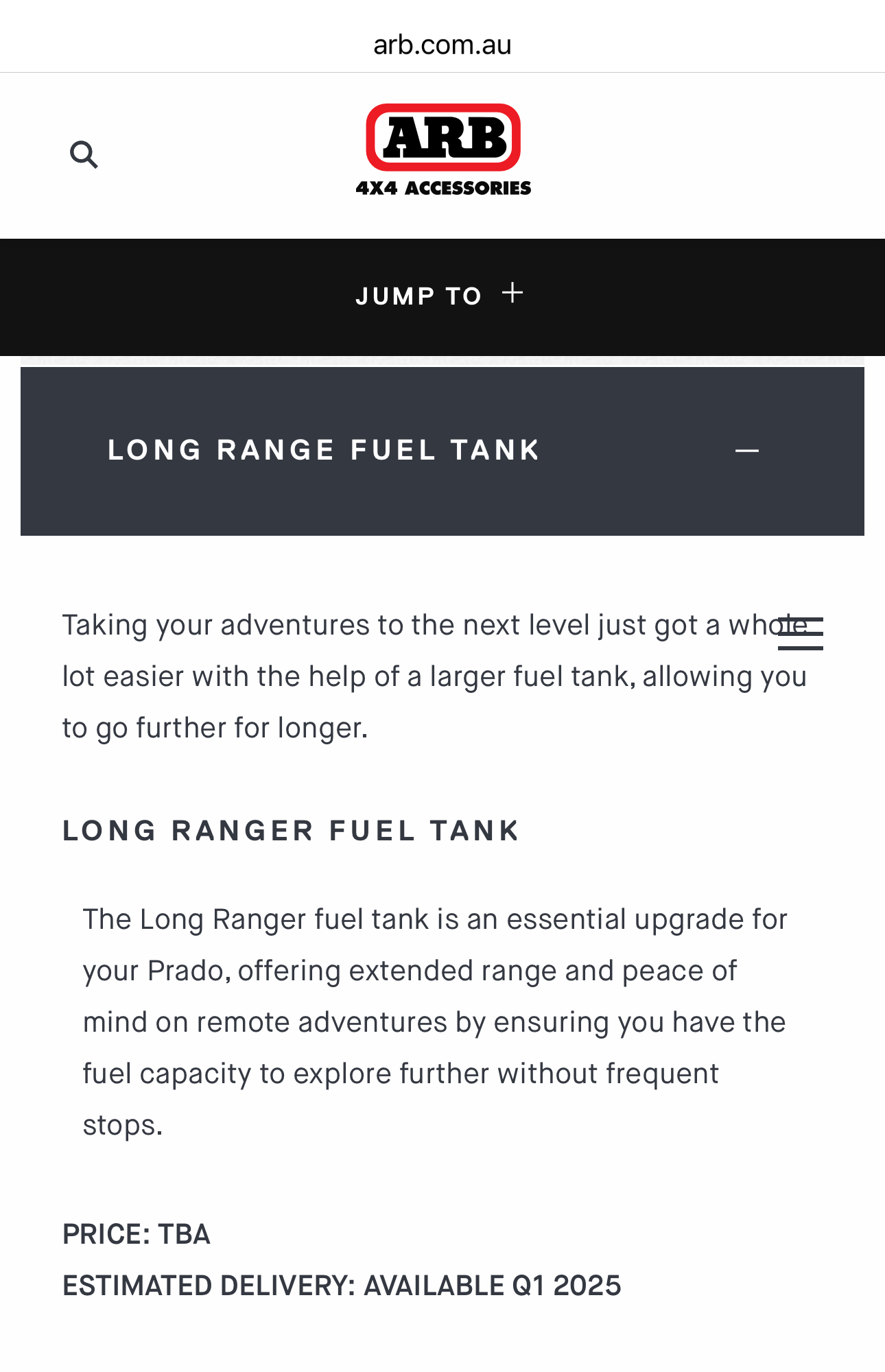

Arb AU has stated that are making a long range fuel tank. Not sure if they offer a gasoline engine over there (certainly not the hybrid) or not but maybe they’ll have something for the US market…
