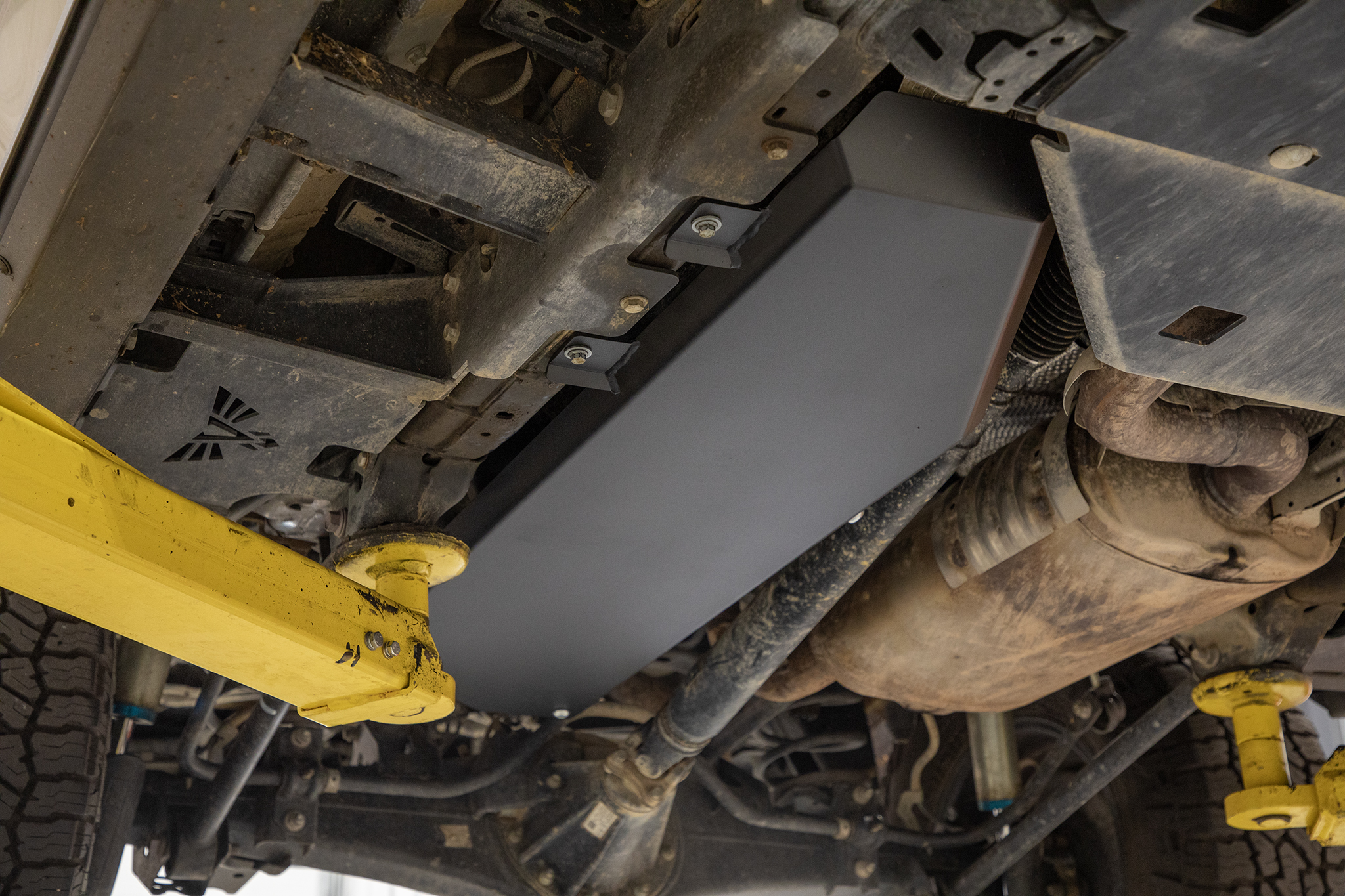

Has anyone tried a fuel tank skid? I’ve reached out to one or two companies and they obviously can’t confirm fit compared to OEM tank. I gouged and dented mine on a pretty rough trail.
Did you by chance contact Victory 4x4? Their skid looks nice & they make them as you order. Hopefully they might mod one up for you.
It’s 5mm think on the bottom. Looks fine.
