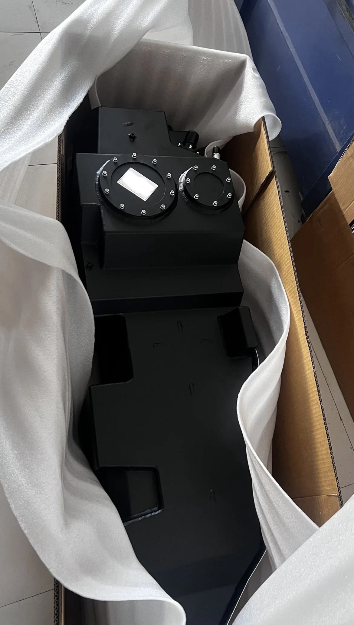

Woo Hoo! Got a call from the shipping company, 12gal Aux tank is scheduled delivery for tomorrow!
Oredered: 24 Jan 26
Scheduled delivery: 3 Mar 26.
For anyone ordering directly from FK/Alibaba, They do not use a conventional tracking number (at least what the carriers in the US use), They use a "Card Delivery Code" (tracking number) this caused great confusion, when I called the shipping company and tried to schedule my delivery, as they had no record of my phone number or order number. After contacting Alibaba, they provided the Card delivery code and I called the shipper back and convinced them to please try the weird code (their words, not mine) and what do you know my order popped right up.
If anyone orders a tank, it was very beneficial setting up an account with Alibaba, as that was the only reason I got an email about the shipping company.
It's been a long wait.......

well i managed to install mine today. needed two people and a lot of patience. as has been noted in the thread already, removing the electrical connectors was by far the hardest part. for install, adding the additional nuts was quite tricky and the one with the tail actually broke off, so i need to go to a shop and find a replacement. took about 5 hours of labor.
so far, the MTE gauge seems very confused.
