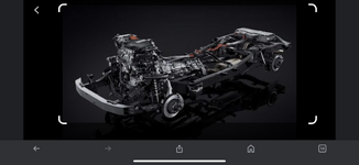

I dont know how much of space would you have to take to accomodate the least size of 25-30 Litre tank, and relocate some of the contraceptions currently as the feeder lines to the Hybrid Batt going around I guess. I maybe wrong.
Great photo! Had not seen that one. I think EOD guy posted some photos of the underside of the chassis with the main fuel tank removed. It looks from the photo that those wires pass over the the right side of the chassis where the main tank is. Hopefully they would not interfere with a sub tank on the left side, but exhaust definitely would.

My bad🤣. Fuel Tank Design or Fabrication with such in mind would require much more thought. The Fuel Y supply pipes, between the Main and sub, having dual evaporative control systems, the fuel pressure sensors, the sub tank fuel pumps connecting the main fuel tank assy, leading to high pressure fuel injectors, Fuel tank vent hose, charcoal canister, . The ECM would required to be be reprogrammed or changed to read the sub tank values and interpret on the ODO based on the Temp sensor reading. It would be a humungous job I estimate. Such a tank def not with Aftermarket I would not go that way having a family riding on top.

Completely agree with your appraisal of the complications. The ejection seat might actually be easier! However, the good news is Toyota has already thought through all of that for the petrol sub tank that they offer in some markets. Therefore, all of those systems should be readily available OEM.
