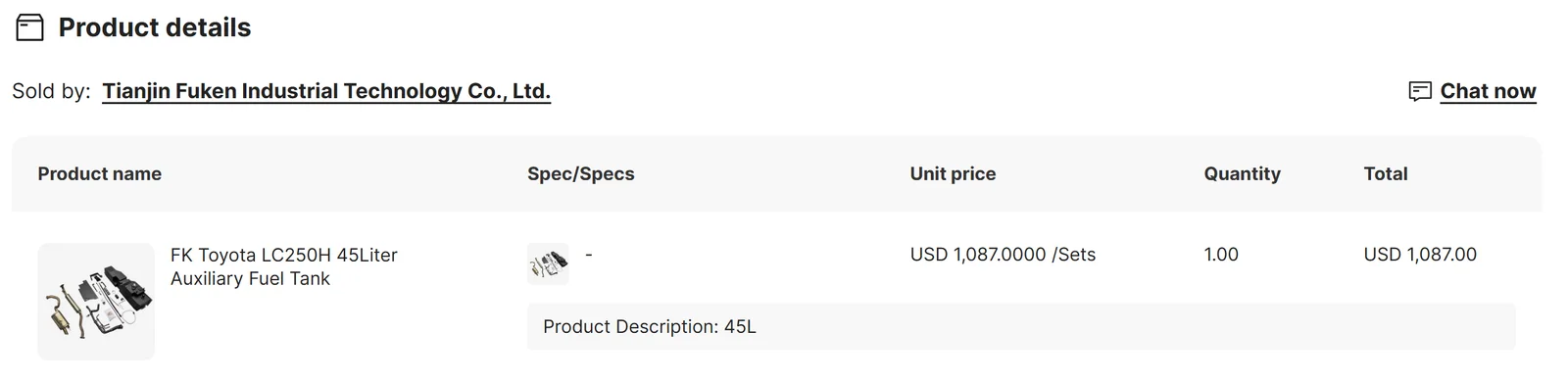

I'm in the process of ordering the 12 gal tank. It's a "Chat box" process, once you agree to the shipping they create a purchase order. $308 to ship to Alabama.
Follow the link below:
Copy this from their web site:
Open the chat box and tell them you want to purchase (paste the FK 45L(12 Gallon) etc..... be patient and answer their questions (Ph # and address) They coordinate with the shipping company and provide you with a quote (takes a few minutes) Once you agree to the shipping costs they send you a Purchase link, follow the purchase link to yet another link to pay. I used PayPal so it was super easy.
All-in-all about a 1 on the 10 scale.
