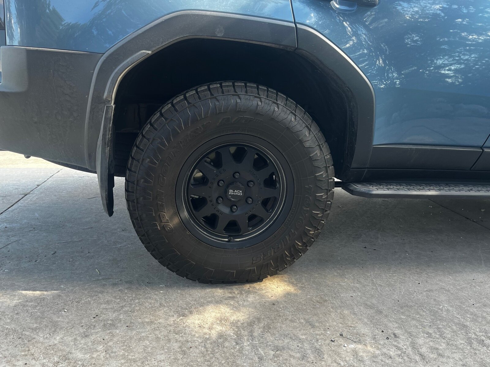

I went with method 17" with I think 25mm offset. My tires are 285 and with more poke than ideal, but I'll get extended mud flaps.

Method 316 Titanium 17x8 | 6x5.5 | 25/5.44"
Tires are Falken AT4 285/70R17 C rated, which is a true 33" tire. The C rated tire shows a bit of radial bulge at 35 psi, which is what I wanted compared to an E rated tire.

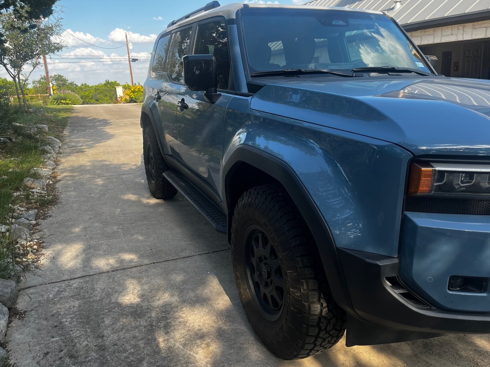

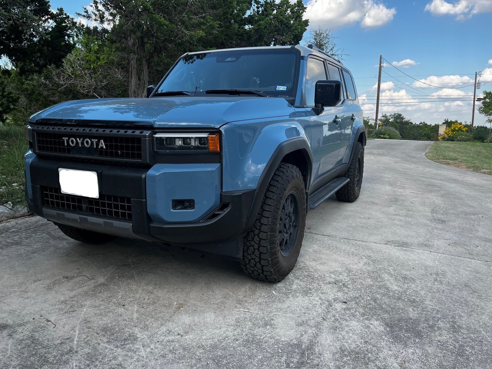

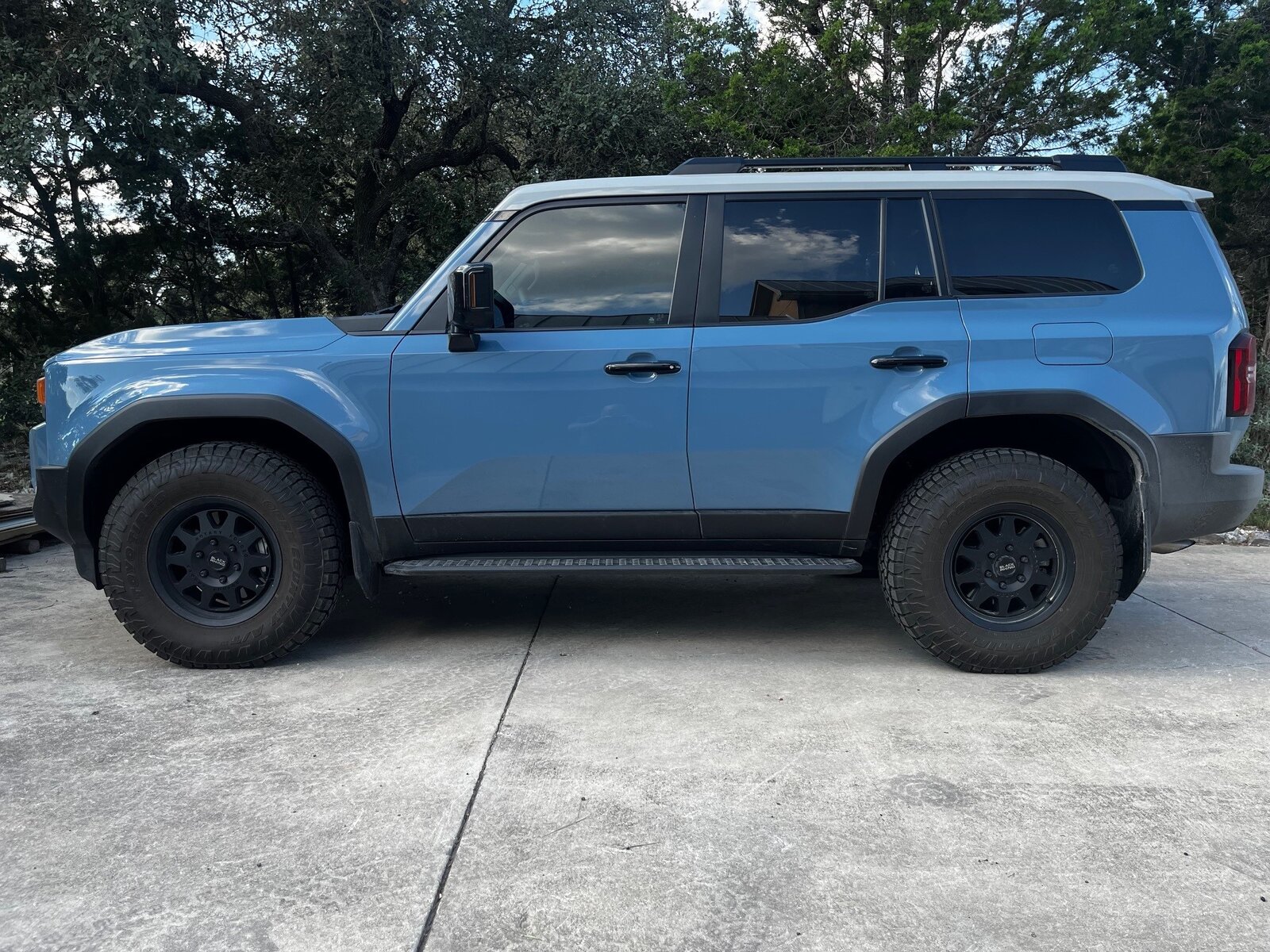

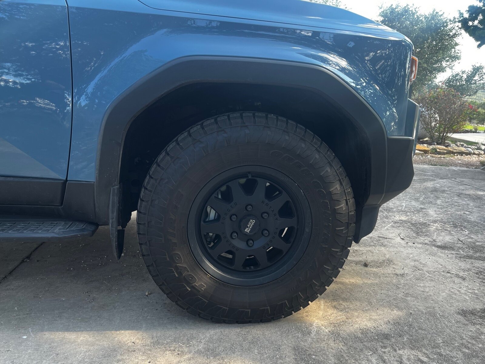

I went with 17x8 35mm offset wheels with Toyo AT3 34x10.50r17 tires. These tires are "D" load rated, but only weigh 55 lbs which is much less than many of the alternative tires that are in the 60+ pound range. I like the additional height without the additional width and weight.

It is on the stock suspension, no rubbing. I have not tried to fit a spare yet. Another alternative tire size which is pretty comparable is 255/80/17, it is more like 10.0 width.
Please excuse all of the dust/dirt in the pictures, haven't had a chance to wash the LC lately.
