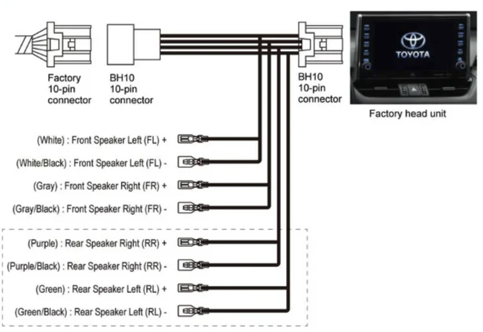

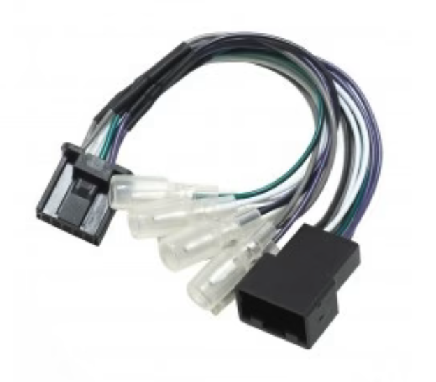

1. Interface with factory head unit and speaker wiring. One end plugs into head unit sound output, other end plugs into factory speaker harness. Cutting midway and splicing sends input to amp, and then powers 4 factory speaker circuits with amp output. This harness receives all the cutting/splicing leaving the factory wiring entirely untouched. I figure the ideal place to cut is right just near where those side wires split off to give max wire length to work with. I clipped off the speaker connectors in the diagram and Posi-lock connected there. The unused exposed wire tips were wrapped securely in electrical tape to insulate/isolate.
View attachment 37433View attachment 37434
Beat-Sonic BH10 SPEAKER HARNESS FOR TOYOTA 10-PIN CONNECTOR

After routed through the console, the two 9-wires connect to the 8 BH10 input signal wires and 8 BH10 to-factory-speaker-harness wires. All 8 wires are color coded and matching.

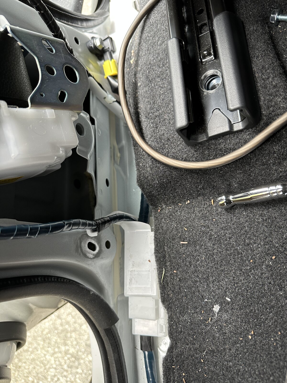

Grounding bolt was placed in factory hole in the B pillar. Unbolting the bottom of the seat belt and door sills reveals the spot from the rear seat view. See the sanded oval, that is an unused spot where I bolted the ground wire. Needed to also unbolt the seat belt at another bolt to access behind to wrench hold the nut while tightening the bolt head with ratchet.
Grounding bolts
Amazon.com
Star lock washers
Amazon.com
Dielectric grease after ground secured to protect metal.
