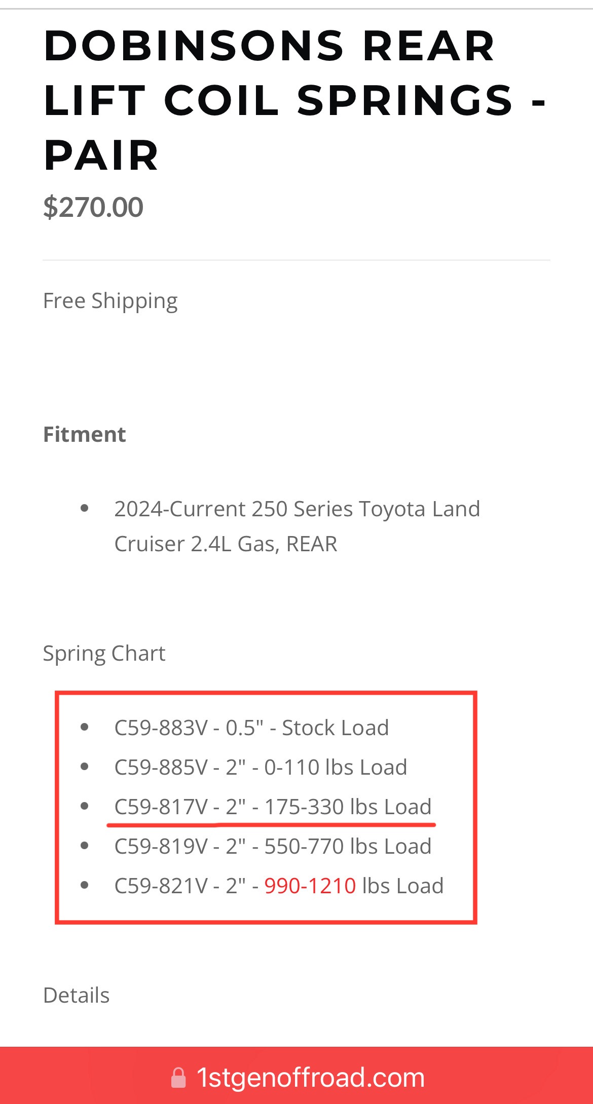

Today, talked to RPM Garage (local tech here) which I tend to have them to install the set. They told me that Dobinson is a bit stiffer ride in town without heavy loaded compared to Icon, but handle loaded better while off-road.
I would consider you fairly heavy loaded. Basically the same as me, and I had to add a .5" spacer in the rear and lower my front to 2.1" of lift to gain just over .5" of rake. Perfect for when I pull my camper.
Which Dobinsons Springs you had?
817s. 175-330lb.
I had Frontrunners drawer system + fridge slider installed permanently in my LC cargo. It is 150lbs with nothing in them. Every off-road/family camping trip, we loaded a lot of stuffs + hitch mount spare tire carrier, so easily total weight added up to 330 plus lbs.
Dobinsons 817V (175-330lbs) is the right springs for me ! Thanks much for your information !

Talked to Dobinsons and was told…Backorder: RED springs in mid Feb while Black in few more months!
I got everything ready (TC+Adjustable King suspension F+R and fair installation labor fee), but the springs hold me back!
