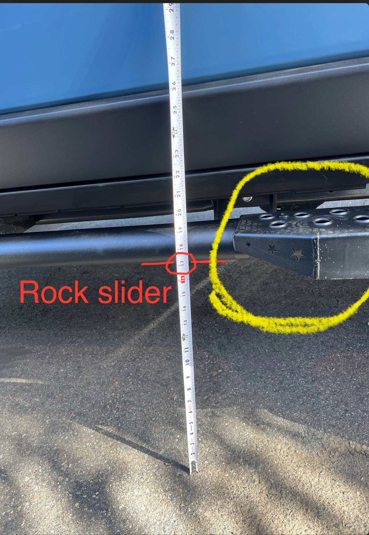

Anyone happen to know what the yellow circled item is? Looks like a clamp on side step for the OEM sliders???
That's the custom made step on @t3lcfe's ride. While those are one offs, if you are looking for clamp on steps for the OEM rock rails you can look at the ones from Z-overland . I got them and would recommend them. That said they could be made better if they where 1" wider and a couple inches longer.
Those z-overland ones look nice! Do you only get 2 per order?
I'm sure they'll build more....
As far as I'm aware, Z-Overland is the only off the shelf option currently available for the OEM rock rails.
