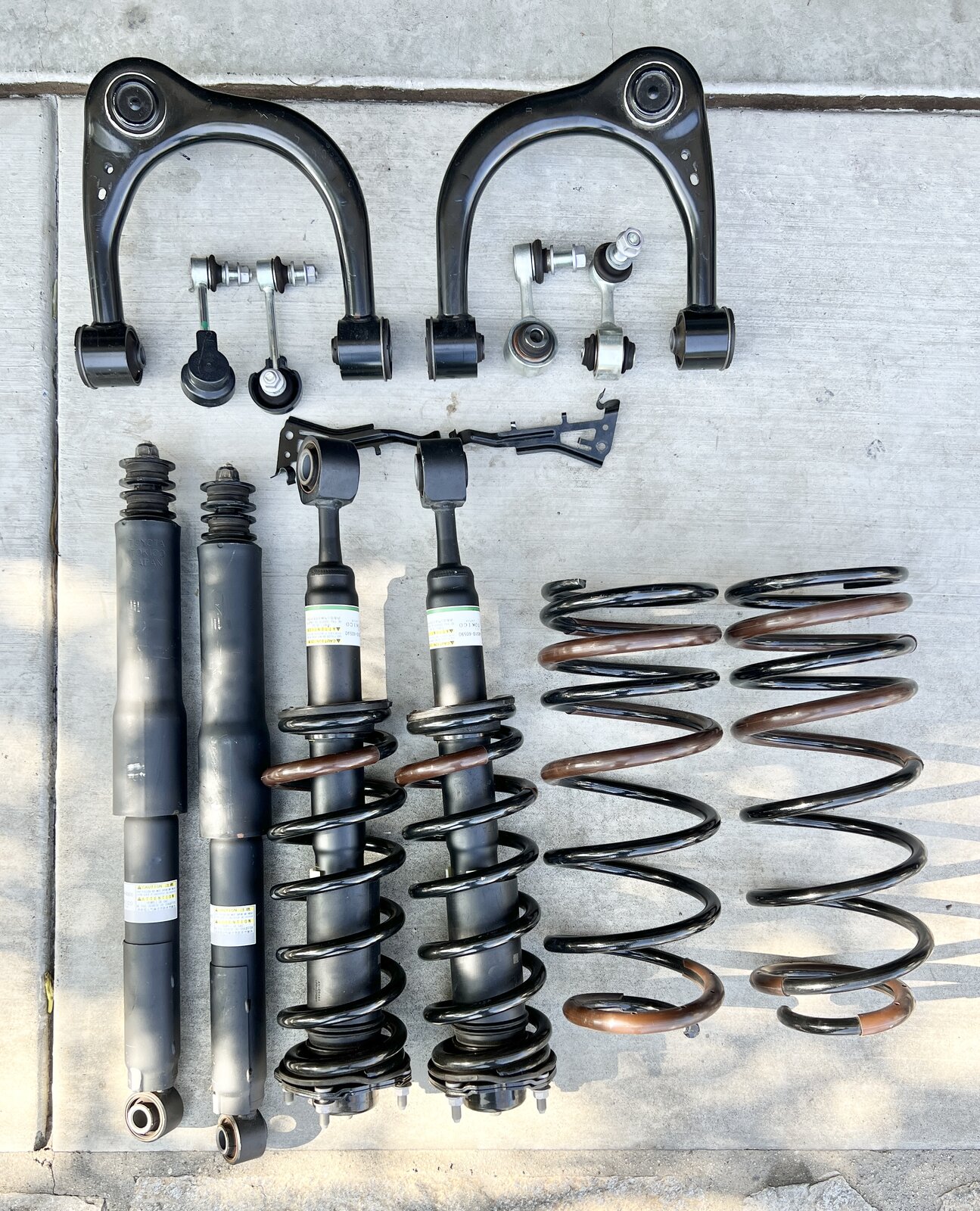

Here are the stuffs I took off from my LC only 3400 miles

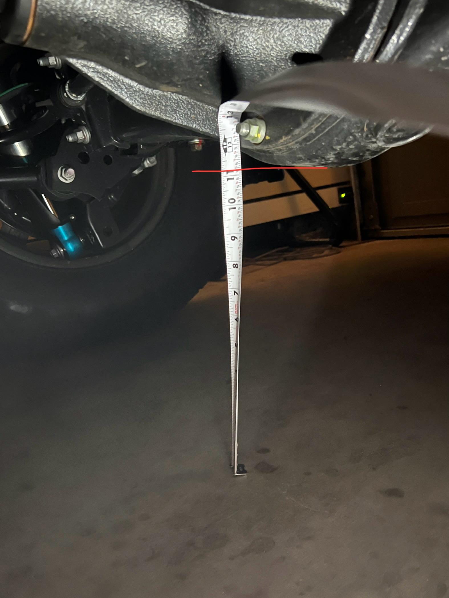

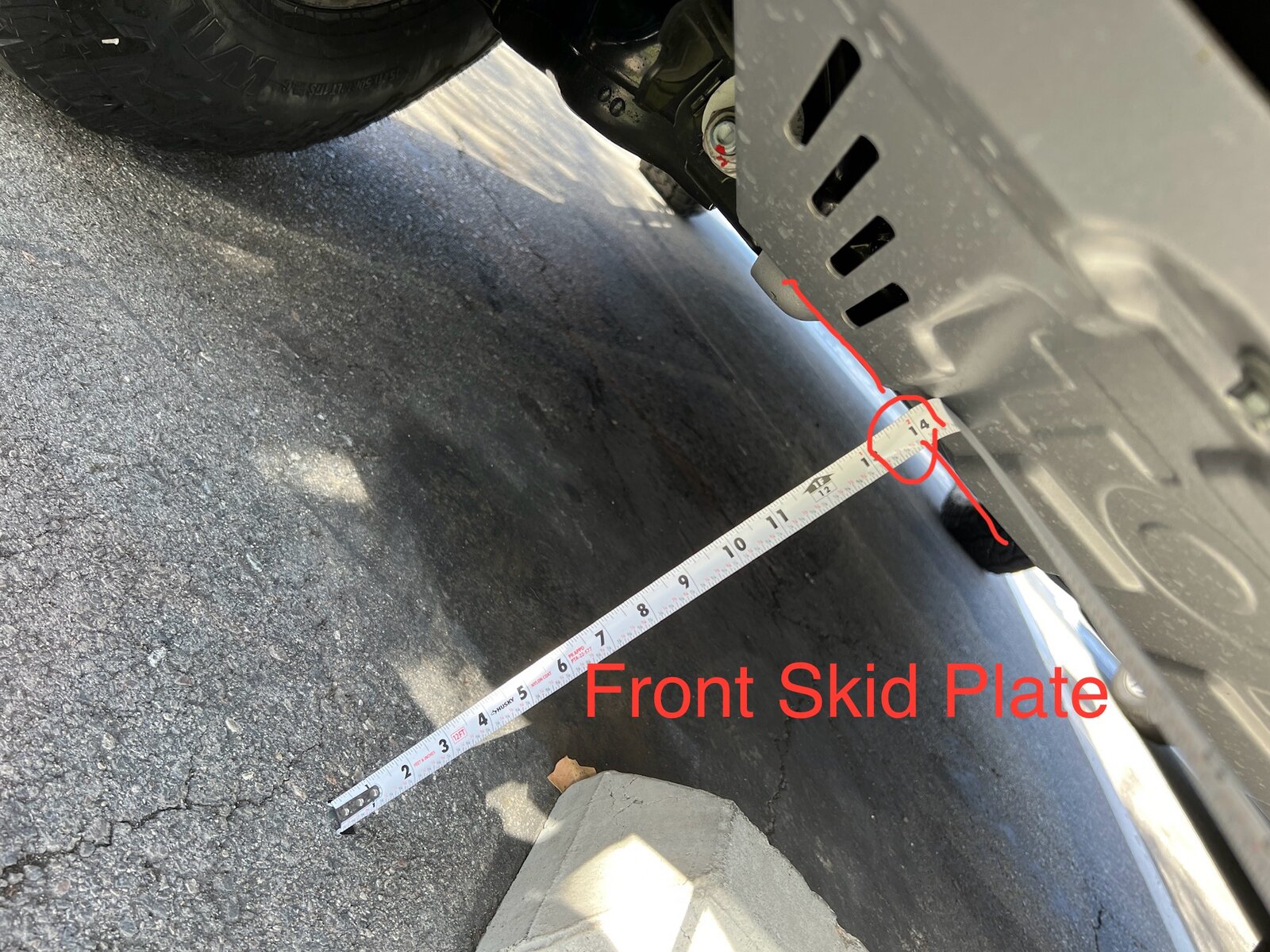

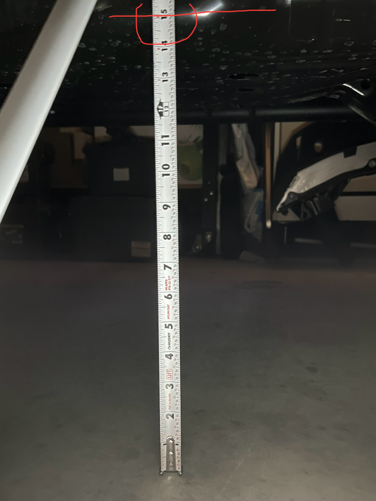

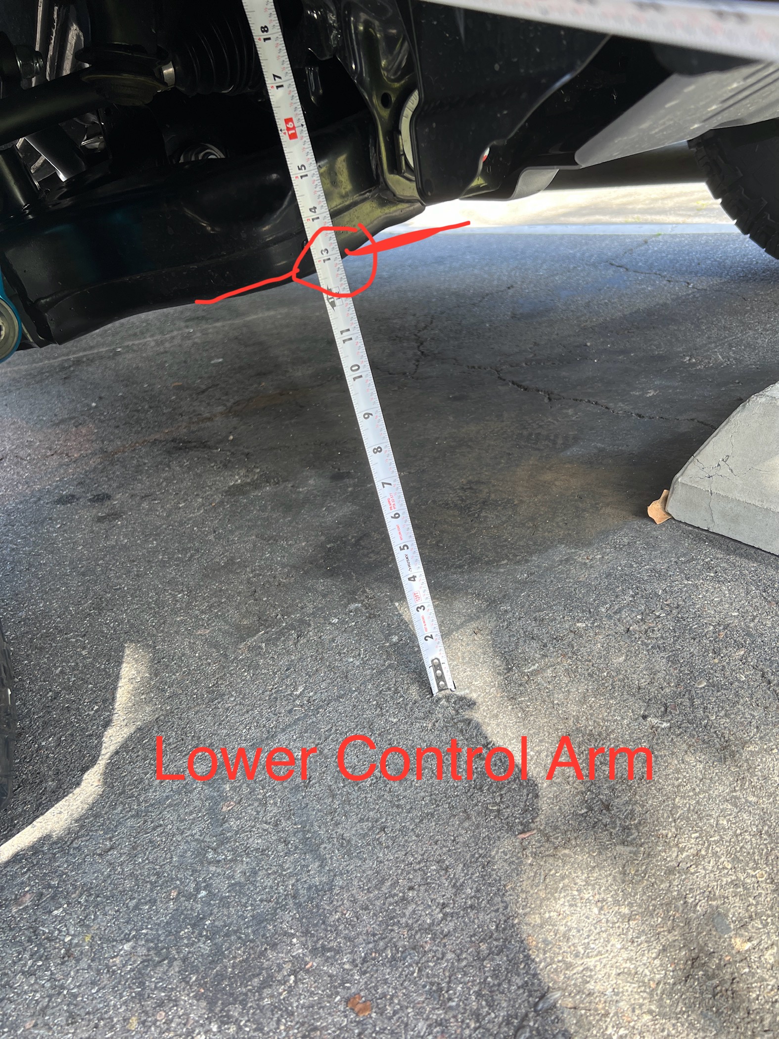

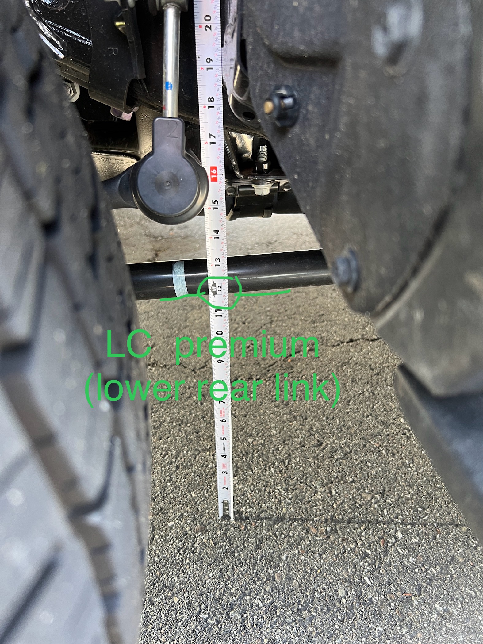

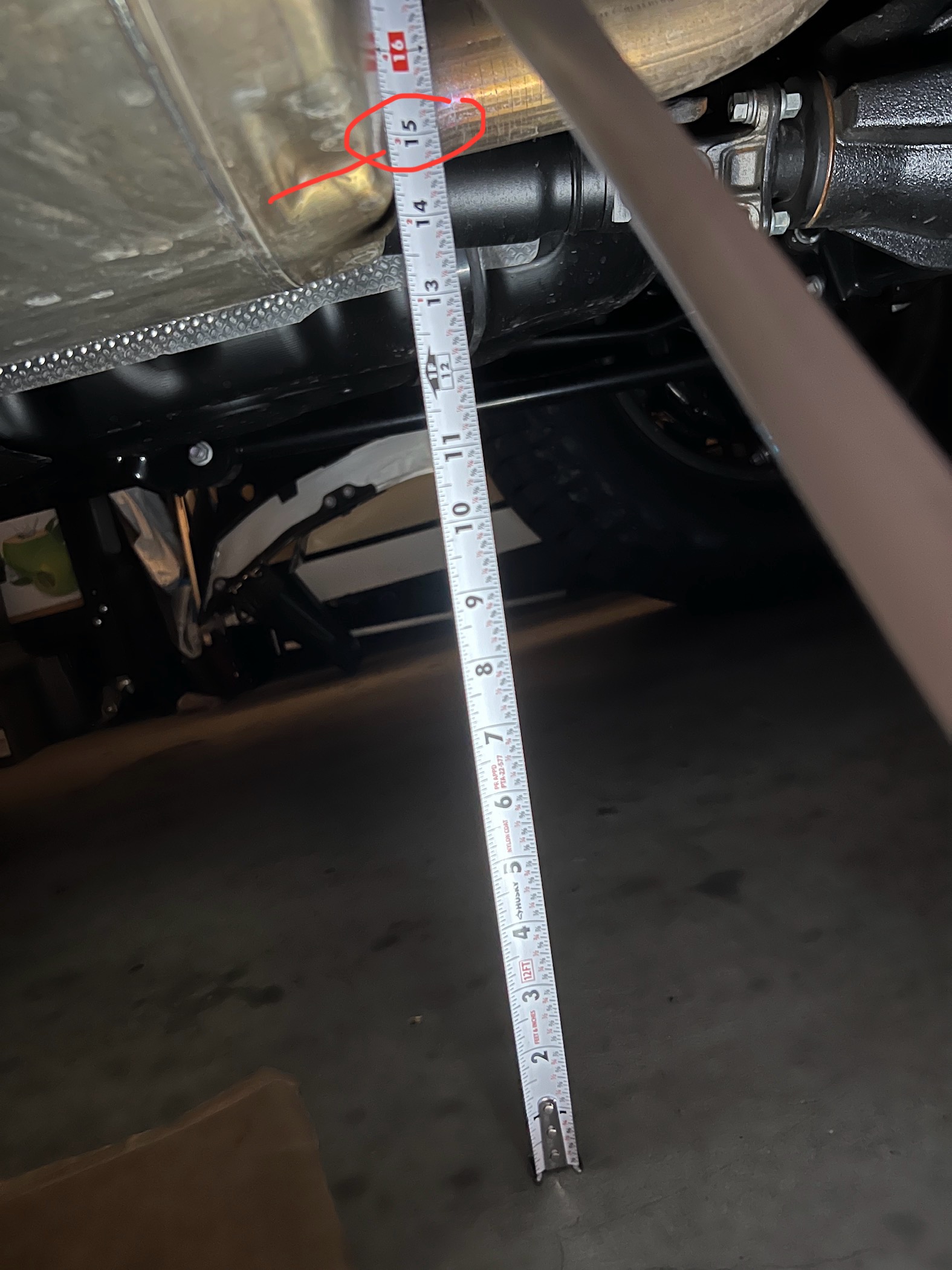

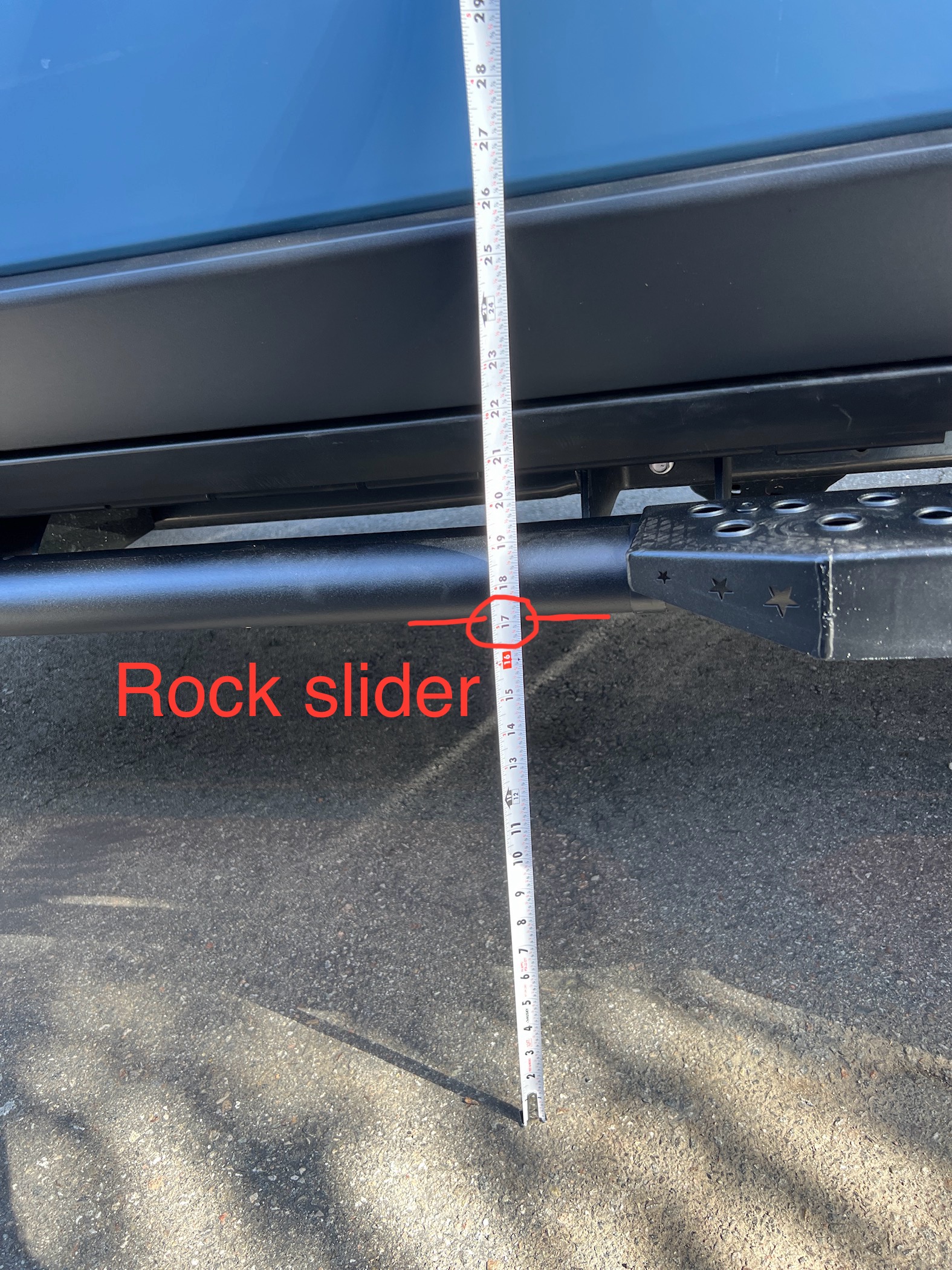

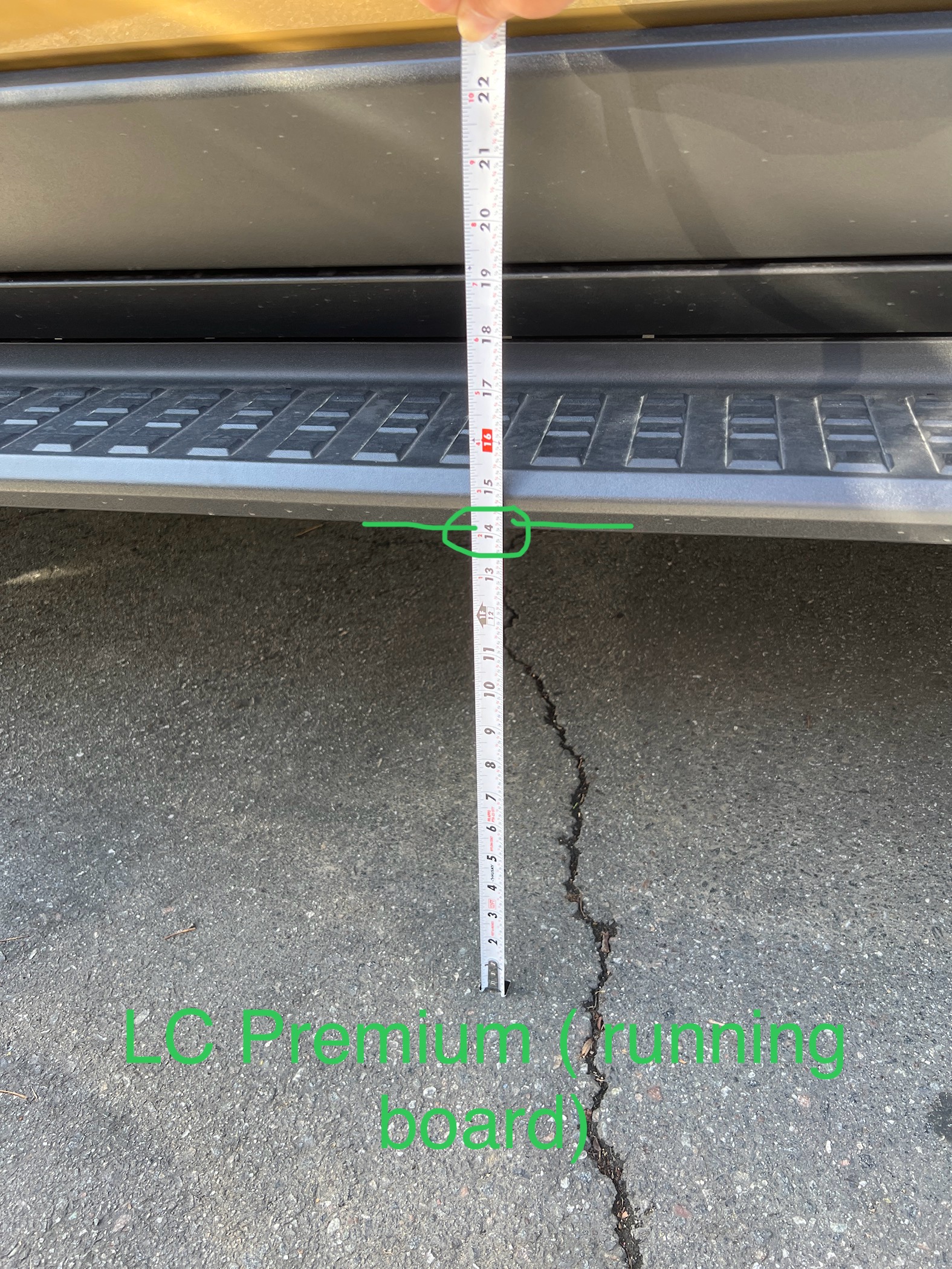

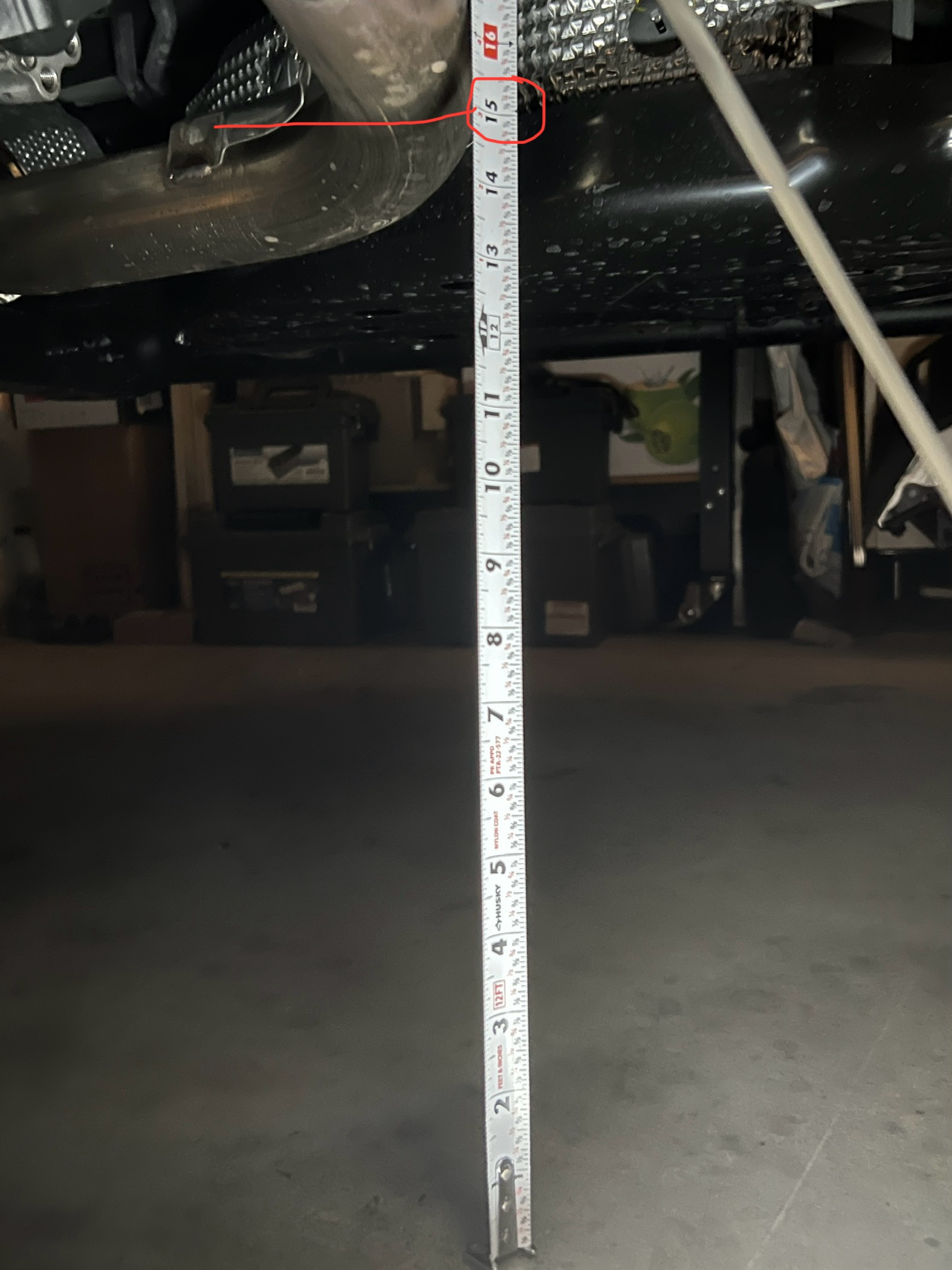

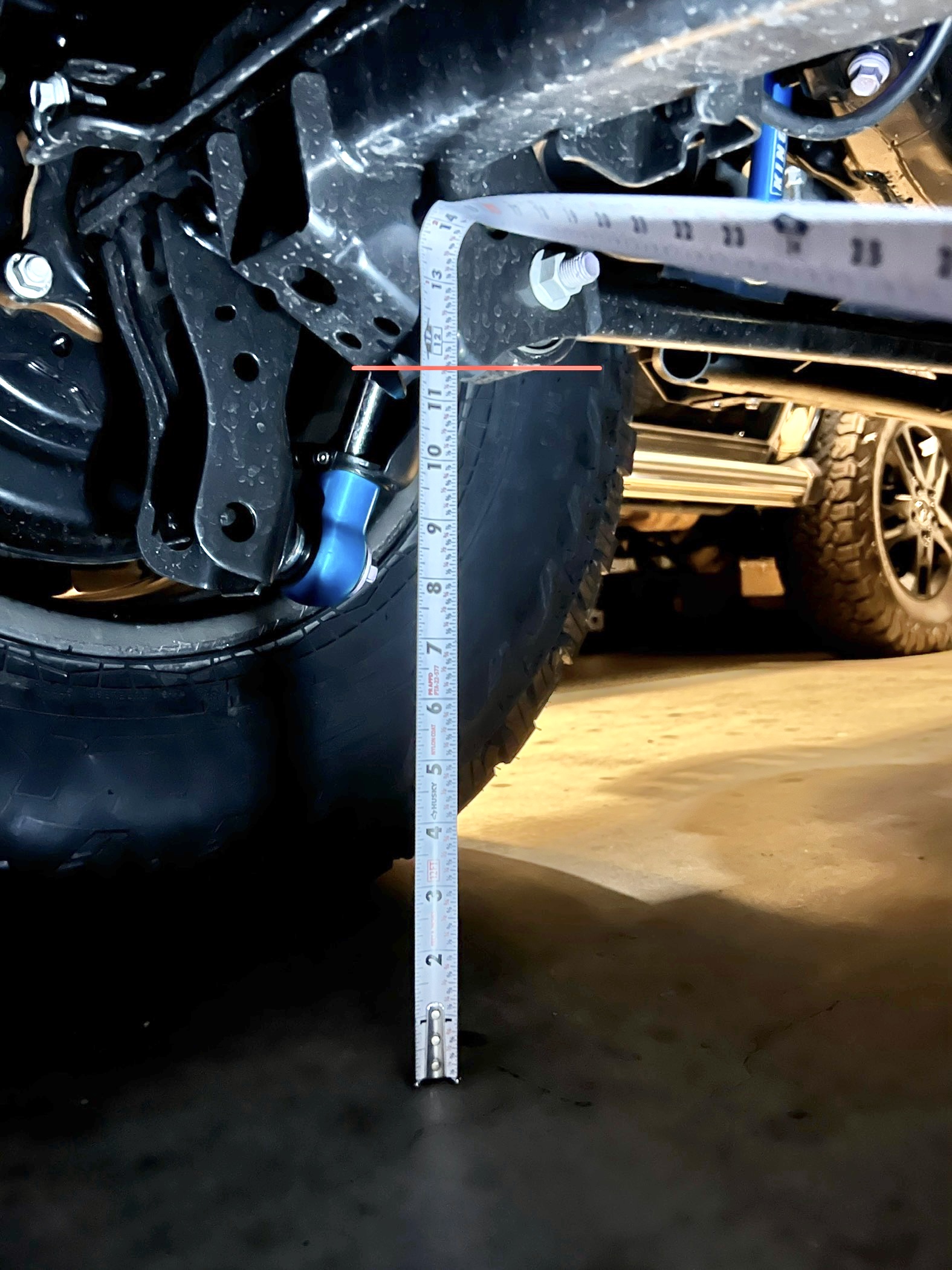

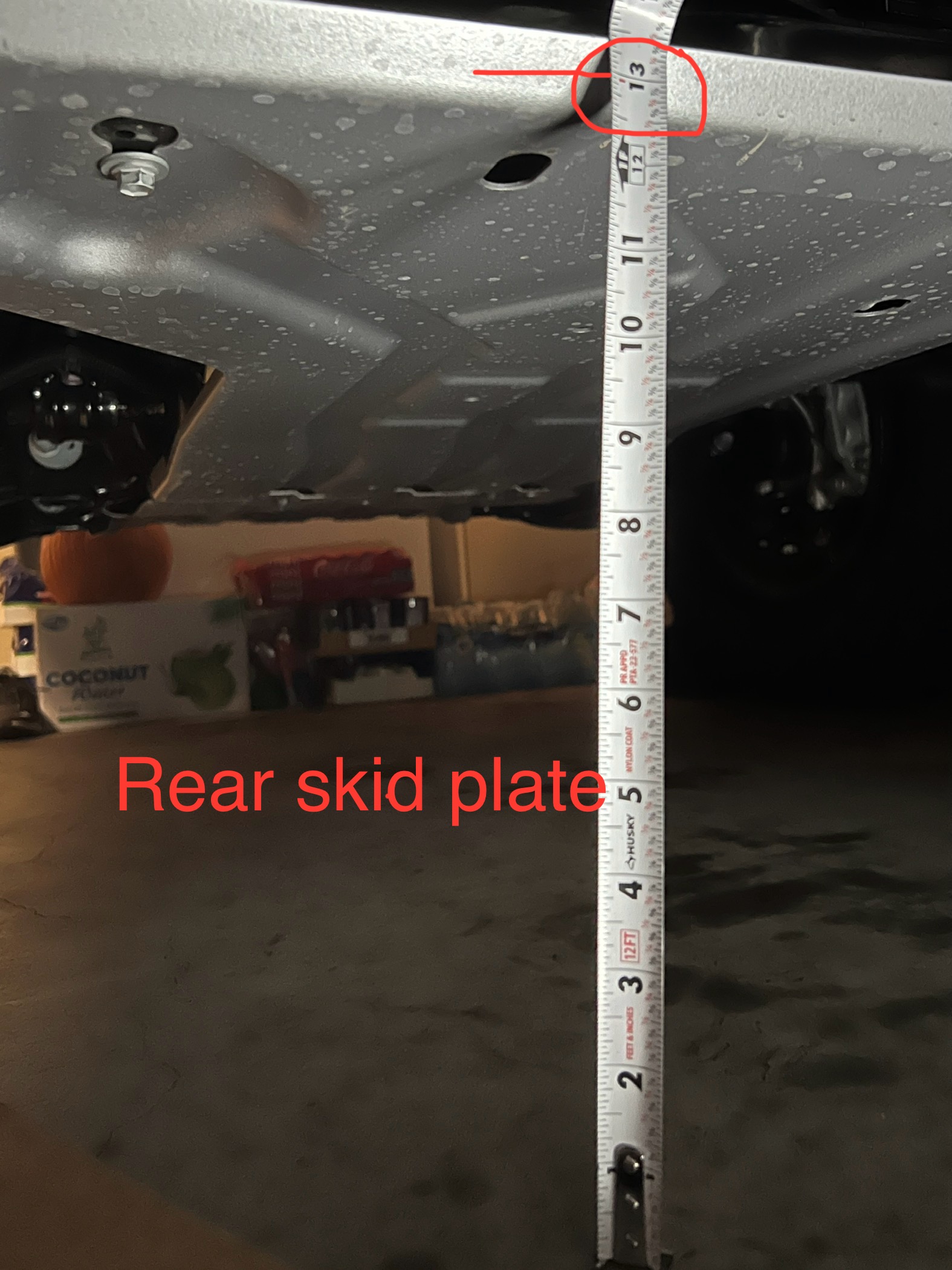

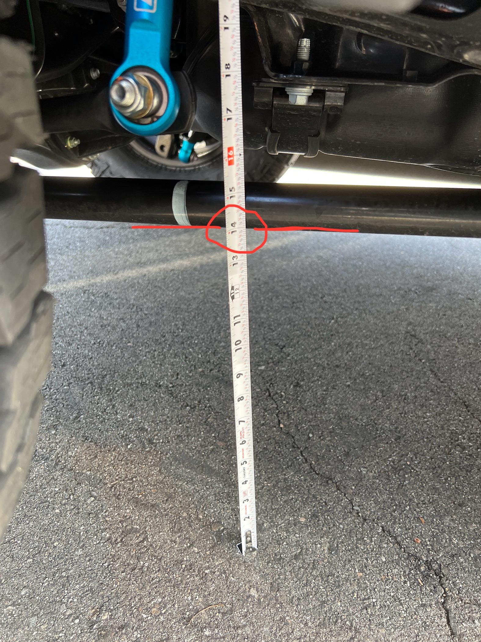

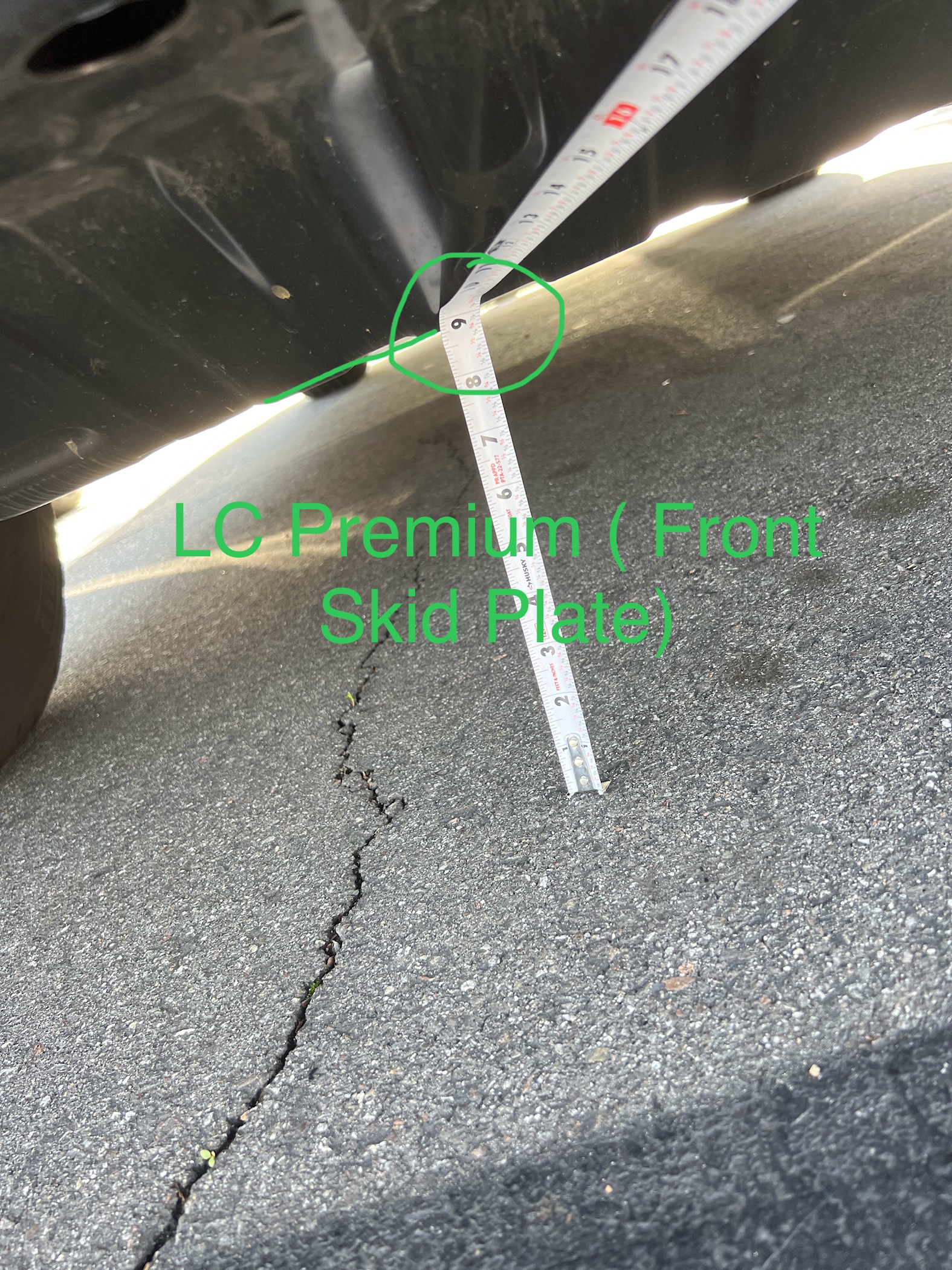

Here are some photos with measurements.
The RED marks are my lifted LC. The GREEN marks are from my friend LC Premium (at my work). These help you to see the clearance differences
Generally, clearance is minimum 2” higher (?)
Thank you!!! Very helpful.
