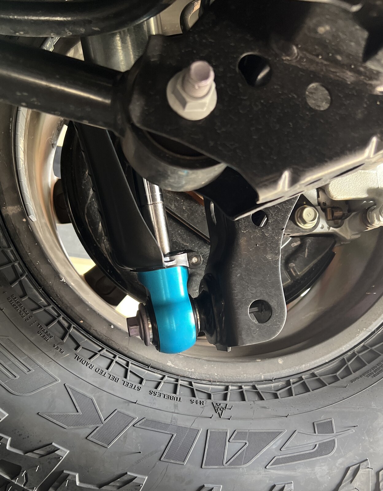

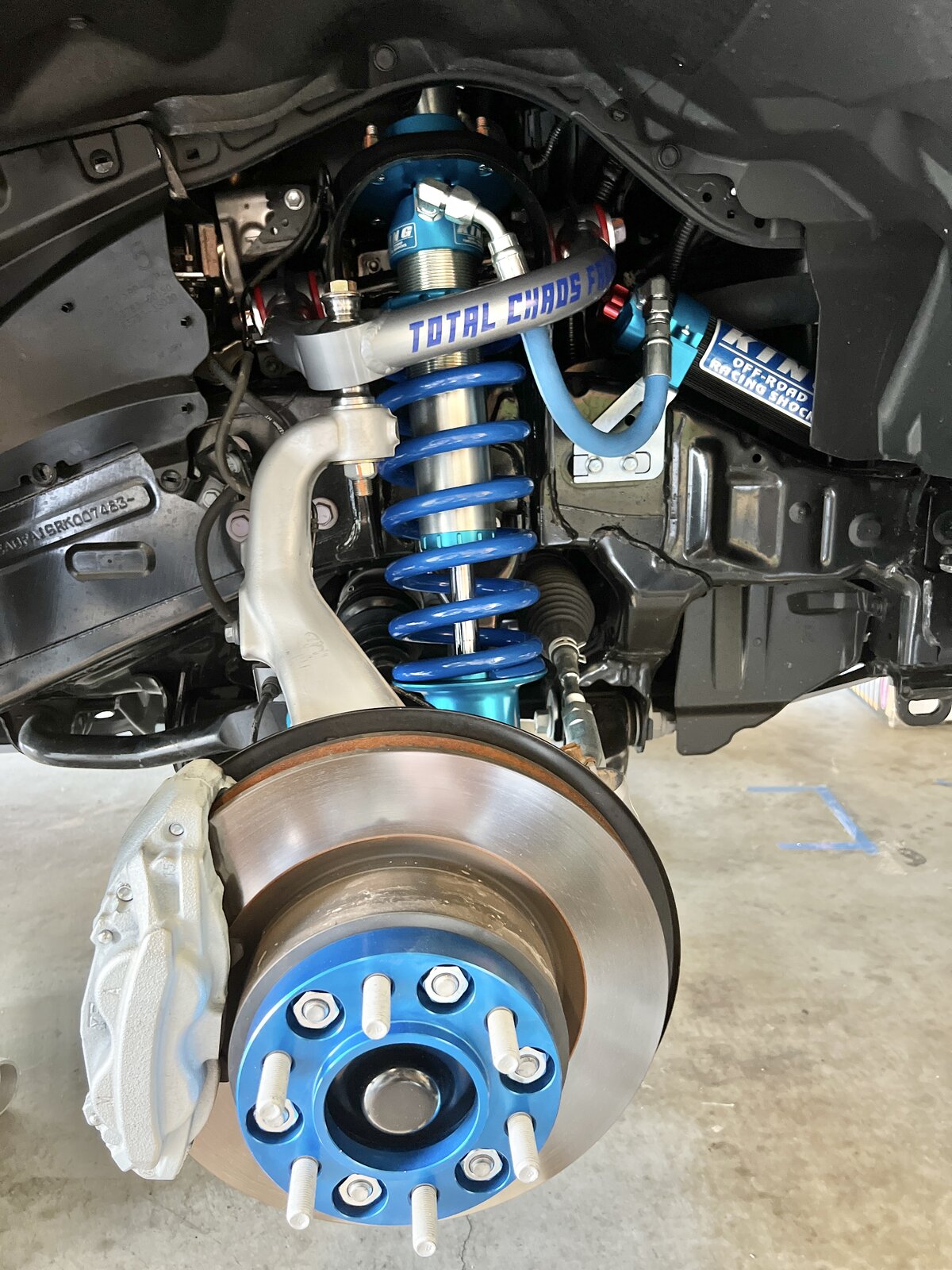

The lift kit: TC (Total Chaos) upper control arm + 2.5” dia adjustable King shocks, and Dobinsons 2” lift springs (rear, 170-330 lbs constantly additional weight)

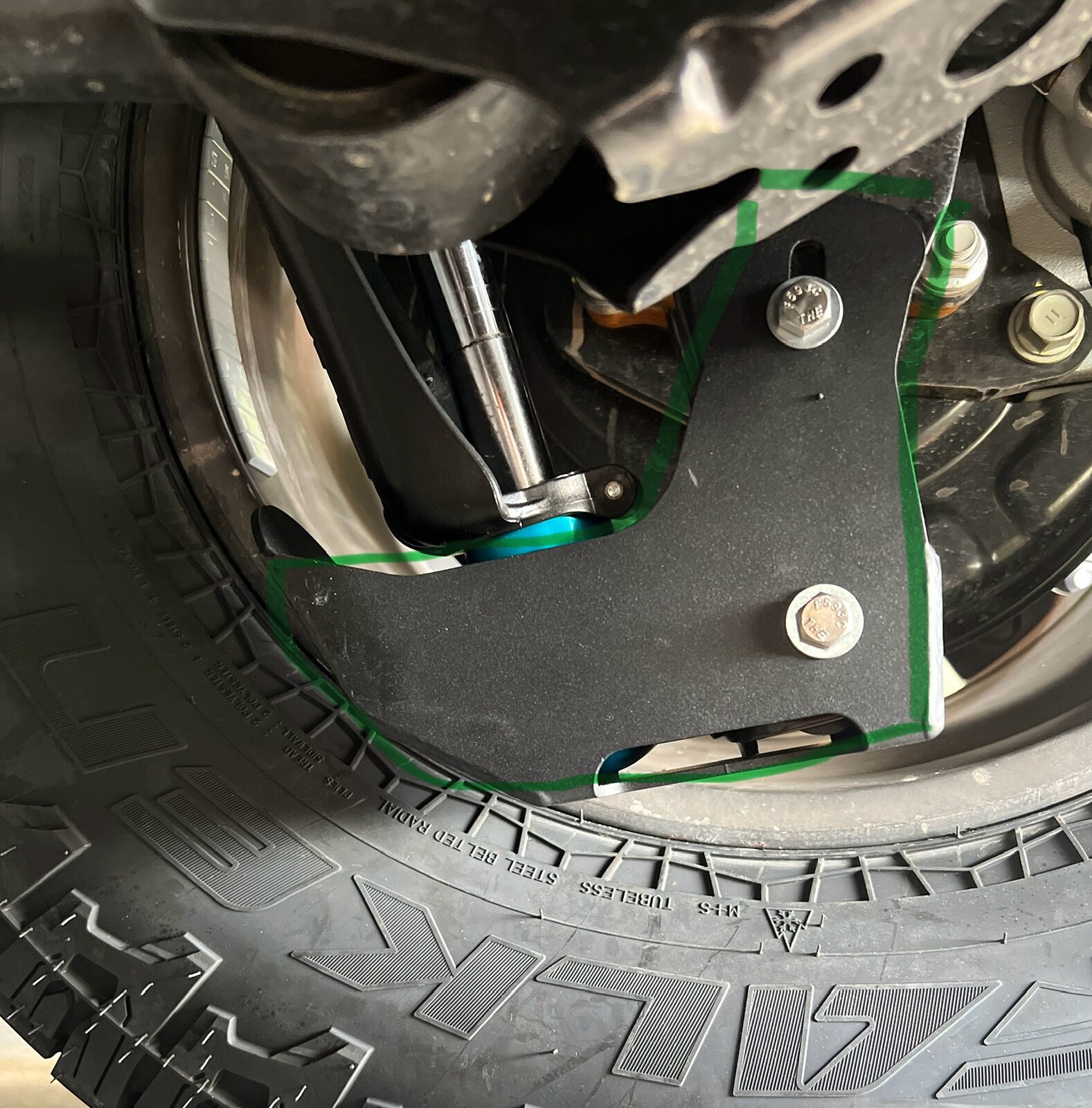

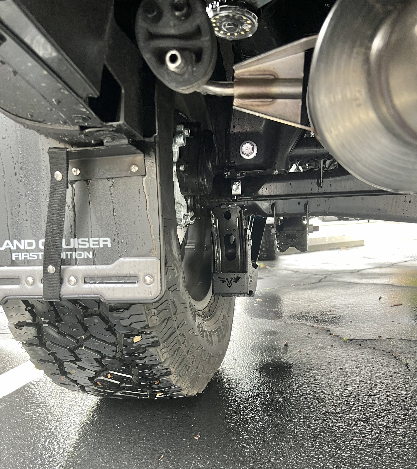

Just installed rear shock skids (plates) to protect the lowest hanging parts of LC. I had same this kind of skids for my Gwagon

I posted this 2” lifted system before. However, I re-post here again to answer your questions, but also for others who are interested on.
My goal:
• 2” lifted rear with extra loads (“permanent” 1705-330lbs = drawer system+ fridge slider+ some off-road recovery gears)
• Not only proper fit 35” tires, but also improve on-road + off-road performance with extra 2” lifted = longer travel
Solution:
• Dobinson rear 2” lifted springs ( replace the OEM springs) There are many spring rates, but I chose the one can have 2” lifted (with minimum / no sage) after 170-330 lbs
• Total Chaos upper control arm to accommodate longer travel of new Kings shocks and wider stand of tires
• Kings shocks 2.5” dia, adjustable (firm to soft ), rear and front links. The front shock has coil/ spring that can lift front up to 3”
After 2” lifted rear, the front lifted 2.75” to level with rear. ( before lifted, front 0.75” lower than rear)
I also added 1” wheel spacers to push OEM +60mm offset out to be +35mm.
Generally, when you raise / lift vehicle higher, you need to get wider stand for stabilization
General, ENTIRE OEM suspension were replaced ;)
My LCFE now run as “dream” 😜 😜
Take off OEM suspension set
Any tips on the instal of the shock skids? I did a quick “dry fit” of them last night and it appears a bit tricky installing the mounting hardware. Not much room to hold the nuts in place. Did you remove the wheels to install? Just asking for any tips before I install this weekend.
Yes. Without taking off the tires, It is a bit awkward to get the upper/inner bolts through. However, I managed with small patience and got them done without removing tires.
I installed the 2 lower bolts 1st, then flipped it up for the top 2 bolts.
I still have much room between rear tires and the skid plates. Mine are OEM wheel +60mm with 1” spacers. It means +35mm offset
Yep, the shock skids fit nicely. I did remove the tires which gave me a bit more room. Nice protection for my new Radflo shocks.
