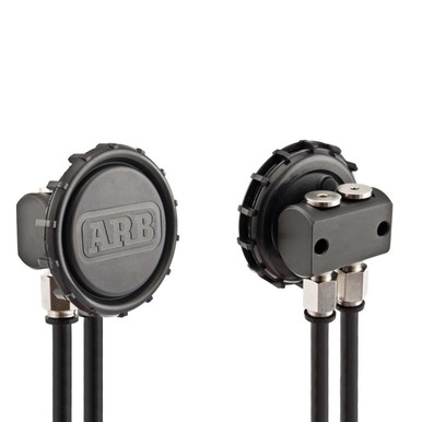

You should buy ARB diff breathers (no check valve) and mount them in engine compartment. This will help protect against water and muck getting sucked into the wheel bearings.

The maintenance takes less than a minute to check/clean all four once they are relocated, 10 if your mechanically challenged. ARB at over $180.00 to do all four or half the price of a single ARB to do it on the cheap. The tubing the ARB uses doesn't hold up as well either. They other downside to the ARB is all it takes for the hose to come off is a little downward pressure on the locking mechanism and the tube will come out in short order.

Anyway, for me it's a waste of money. If it causes one panic maybe one should install the ARB or similar style, hell I have one from Bison gear on my 40 that I paid way too much for and has 3 provisions for breathers, still cheaper than the ARB kit, the 40 will never see water crossings above the bottom of the axles so it was and is overkill and a waste of money.
