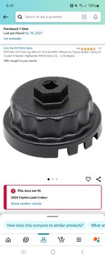

Bought this to loosen and tighten the filter. Works great despite the big warning that it does not fit. $8 on amazon
I’ve had bad luck with third party oil filter filter wrenches. I just watched a YT video buy TCCN that listed a Toyota brand oil filter wrench. Though he did not give a price.
