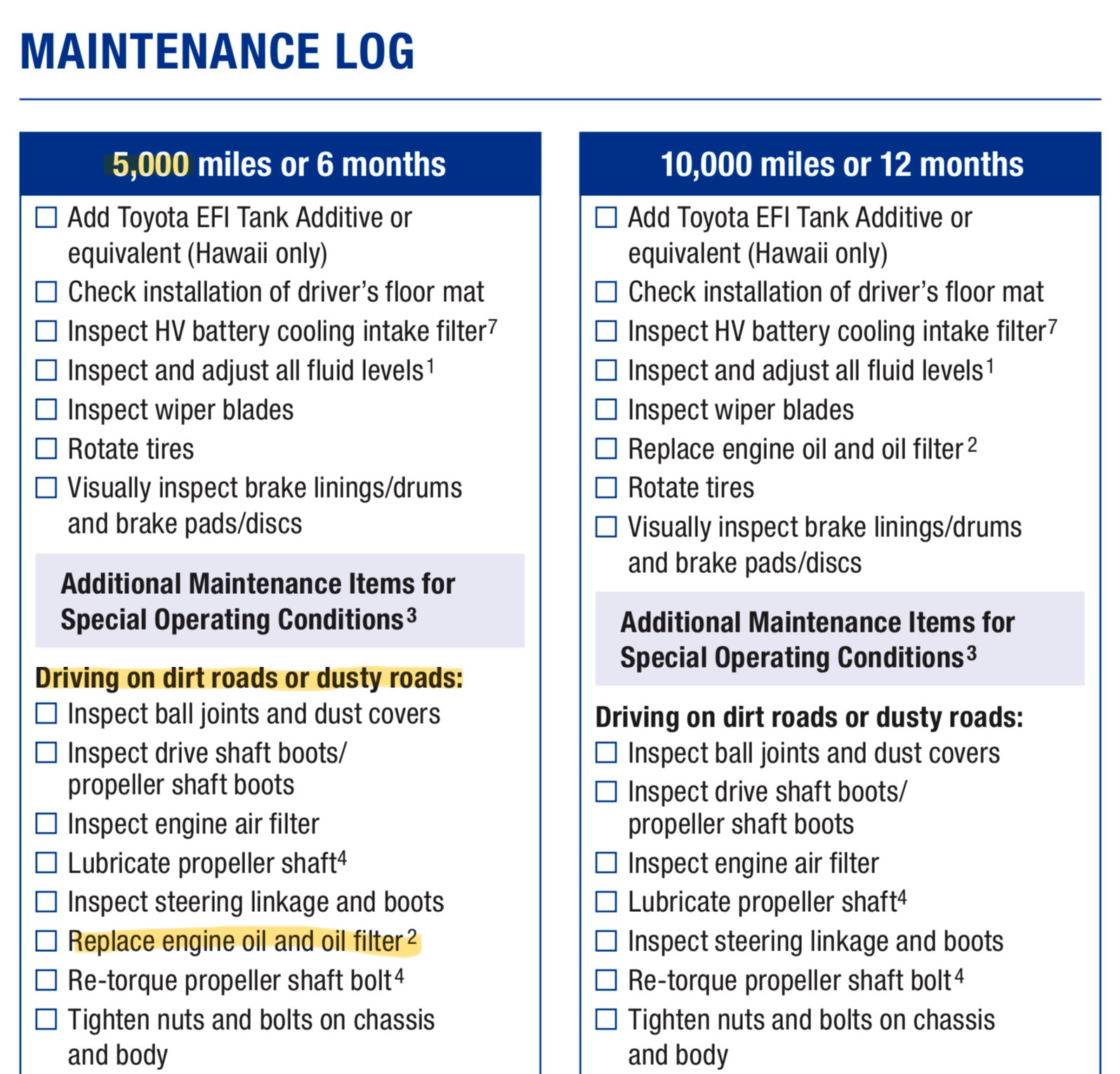

I took mine into Toyota for a 5000 mile oil change after doing my own at 1100 miles, and the dealership said it was not needed until 10K. I said BS, so they moved my free 10K oil change to 5K.
The Toyota maintenance guide says every 5k if it’s ever on unpaved roads. Show them that.

But it is the case that the recommended intervals are based on what will get it through the warranty period, not for maximum longevity of the engine. Additionally, they are incentivized by CAFE credits for long oil change intervals. And if you look at the fine print, most do no meet the 10,000 mile interval driving conditions and fall under the 5,000 mile conditions: short frequent stops, regular steep climbs, hauling heavy weight/pulling, dusty conditions, high speed driving, etc.
